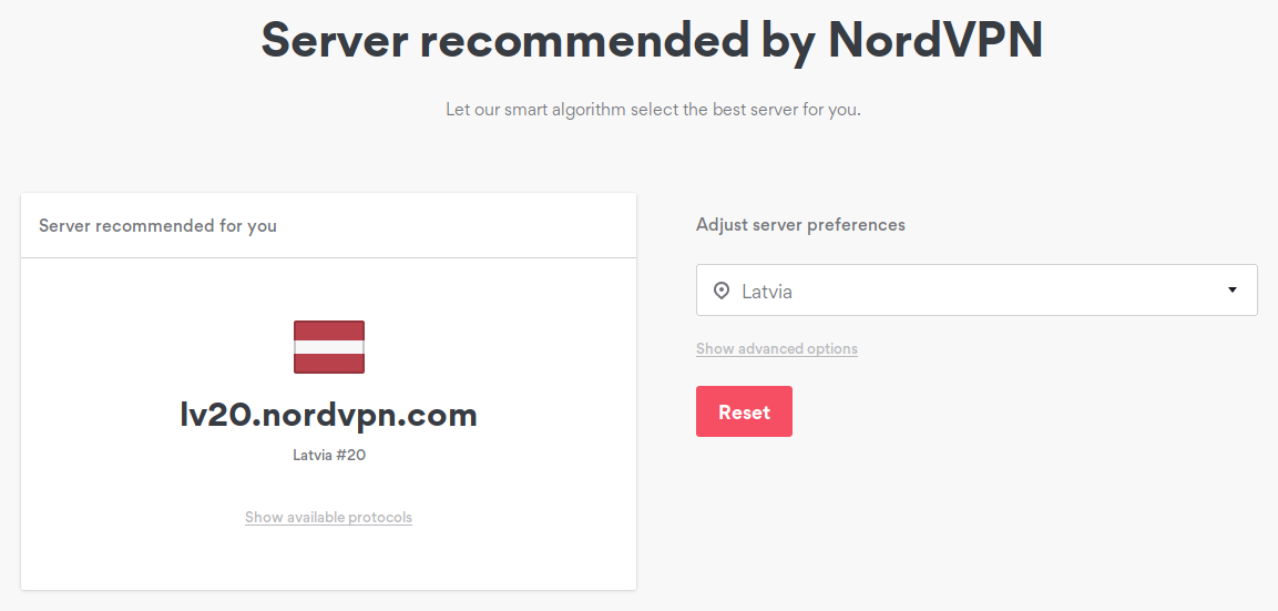

Finding out the server's hostname​
Navigate to https://nordvpn.com/servers/tools/ and find out the recommended server's hostname. In this case, it is lv20.nordvpn.com.

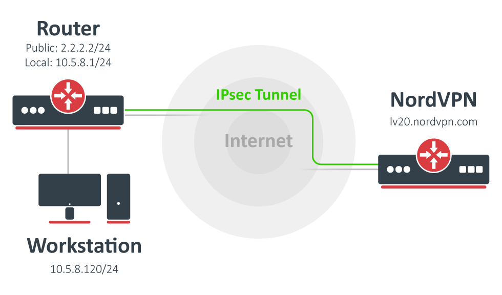

Choosing what to send over the tunnel​
If we look at the generated dynamic policies, we see that only traffic with a specific (received by mode config) source address will be sent through the tunnel. But a router in most cases will need to route a specific device or network through the tunnel. In such a case, we can use source NAT to change the source address of packets to match the mode config address. Since the mode config address is dynamic, it is impossible to create a static source NAT rule. In RouterOS it is possible to generate dynamic source NAT rules for mode config clients.
Option 1: Sending all traffic over the tunnel​
In this example, we have a local network 10.5.8.0/24 behind the router and we want all traffic from this network to be sent over the tunnel. First of all, we have to make a new IP/Firewall/Address list which consists of our local network.
/ip/firewall/address-list
add address=10.5.8.0/24 list=local
It is also possible to specify only single hosts from which all traffic will be sent over the tunnel. Example:
add address=10.5.8.120 list=local
add address=10.5.8.23 list=local
