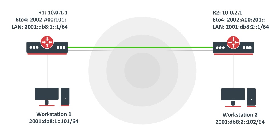

It is possible to simply route IPv6 packets over an IPv4 network by utilizing the 2002::/16 allocated address space. All 6to4 nodes have to have reachable IPv4 addresses - if you are running this setup over the Internet, all IPv4s must be public addresses.
R1 configuration
Create the 6to4 tunnel interface:
/interface/6to4
add name=6to4-tunnel1
Assign an IPv6 address with '2002' as the first 16 bits and IPv4 in hex format as the next 32 bits. For example, if the router's IP address is 10.0.1.1, the IPv6 address is 2002:A00:101::
/ipv6/address
add address=2002:a00:101::/128 advertise=no interface=6to4-tunnel1
Add a route to the specially allocated 6to4 tunnel range over the 6to4-tunnel interface.
/ipv6/route
add dst-address=2002::/16 gateway=6to4-tunnel1
R2 configuration
/interface/6to4
Assign an IPv6 address that is generated by the same principles as R1. In this case, 10.0.2.1 translates to 2002:A00:201::
/ipv6/address
add address=2002:a00:201::/128 advertise=no interface=6to4-tunnel1
The 6to4 route is necessary on this side as well.
/ipv6/route
Testing
After configuring both devices, it should be possible to ping the IPv6 addresses if they were generated correctly.
From R1:
/ping 2002:a00:201::
