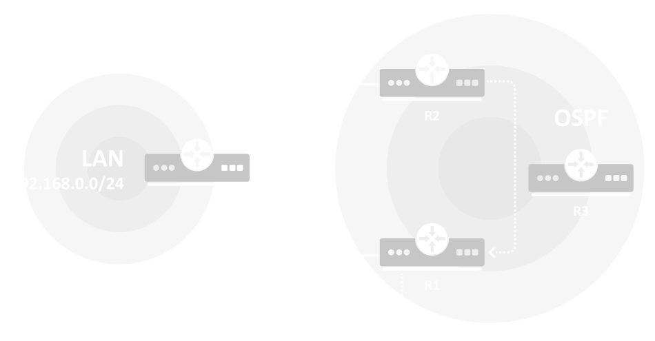

Consider the following example setup:
Router R1 has a static route to the external network 192.168.0.0/24. OSPF is running between R1, R2, and R3, and the static route is distributed across the OSPF network.
The problem in such a setup is obvious. R2 cannot reach the external network directly. Traffic to the LAN network from R2 will be forwarded over router R1, but the network diagram shows R2 can directly reach the router connected to the LAN network.

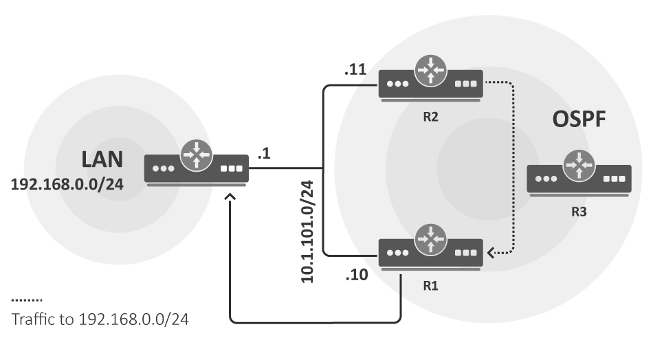

Knowing the forwarding address conditions, you can make router R1 set the forwarding address. Add the 10.1.101.0/24 network to the OSPF networks in router R1's configuration:
/routing/ospf/interface-template add area=backbone_v2 networks=10.1.101.0/24
Now verify the forwarding address works:
[admin@r2] /ip/route> print where dst-address=192.168.0.0/24
Flags: D - DYNAMIC; A - ACTIVE; o, y - COPY
Columns: DST-ADDRESS, GATEWAY, DISTANCE
DST-ADDRESS GATEWAY DISTANCE
DAo 192.168.0.0/24 10.1.101.1%ether1 110
On all OSPF routers, you will see the LSA set with a forwarding address other than 0.0.0.0.
