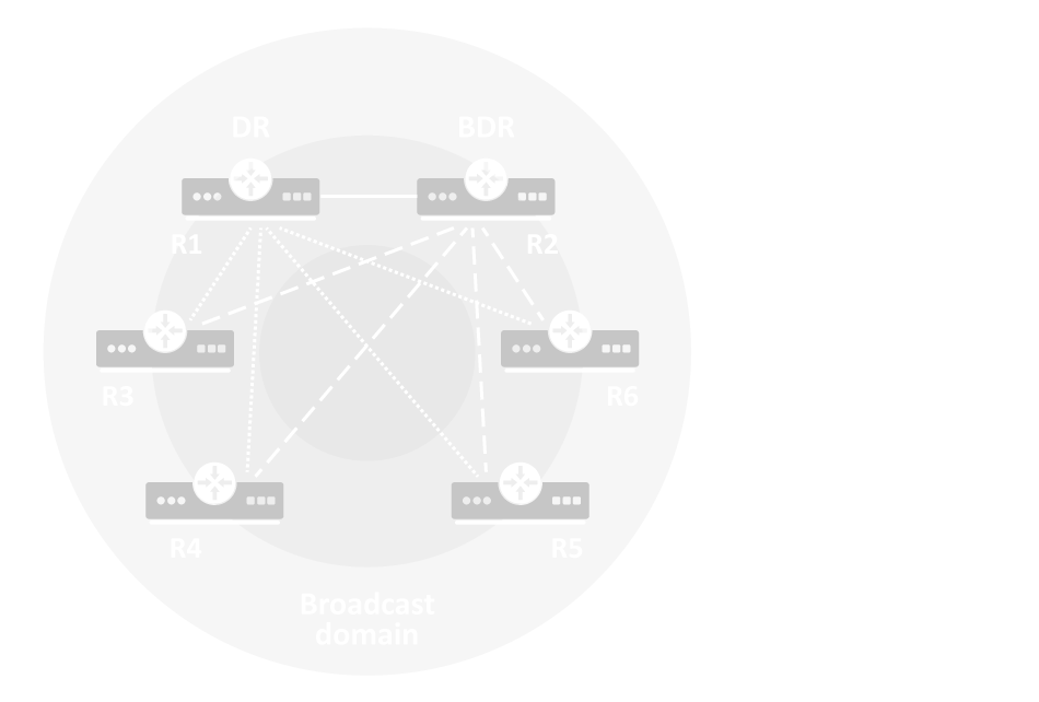

Synchronization on Broadcast Subnets​
On the broadcast segment, n*(n-1)/2 neighbor relations exist. A huge amount of Link State Updates and Acknowledgments would be sent over the subnet if the OSPF router tries to synchronize with each OSPF router on the subnet.
This problem is solved by electing one Designated Router and one Backup Designated Router for each broadcast subnet. All other routers synchronize and form adjacencies only with those two elected routers. This approach reduces the number of adjacencies from n*(n-1)/2 to only 2n-3.
The image on the right illustrates adjacency formations on broadcast subnets. R1 is the Designated Router and R2 is the Backup Designated Router. For example, if R3 wants to flood Link State Update (LSU) to both R1 and R2, the router sends LSU to the IP multicast address AllDRouters (224.0.0.6) and only DR and BDR listen to this multicast address. Then the Designated Router sends LSU addressed to AllSPFRouters, updating the rest of the routers.
DR Election​
DR and BDR routers are elected from data received in the Hello packet. The first OSPF router on a subnet is always elected as the Designated Router. When a second router is added, it becomes the Backup Designated Router. When an existing DR or BDR fails, a new DR or BDR is elected based on the configured router priority. The router with the highest priority becomes the new DR or BDR.
Being a Designated Router or Backup Designated Router consumes additional resources. If Router Priority is set to 0, the router does not participate in the election process. This is important when certain slower routers cannot be DR or BDR.
