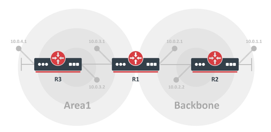

Standard Area
This area supports 1, 2, 3, 4, and 5 LSAs.

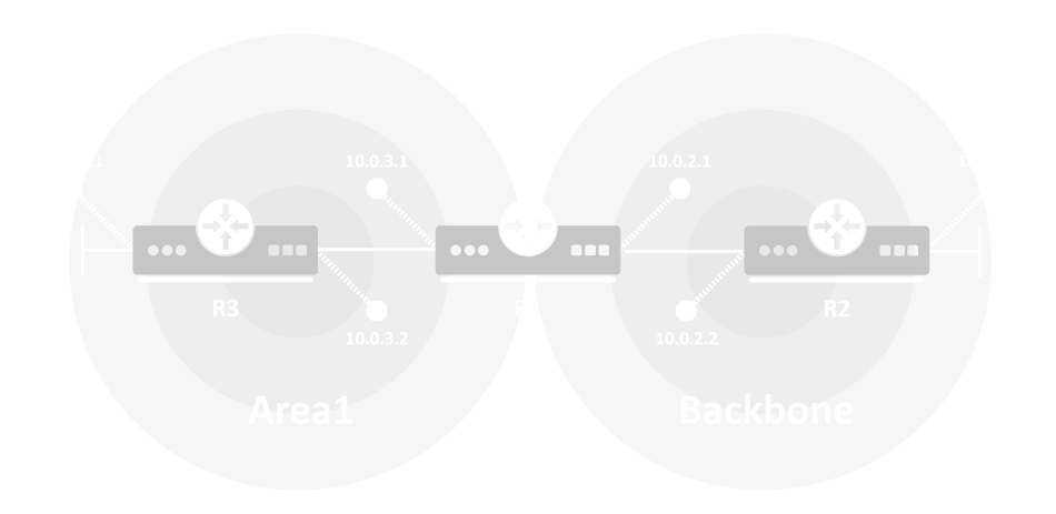

A simple multi-area network with the default area. In this example, all networks from area1 are flooded to the backbone, and all networks from the backbone are flooded to area1.
R1
/ip/address/add address=10.0.3.1/24 interface=ether1
/ip/address/add address=10.0.2.1/24 interface=ether2
/routing/ospf/instance
add name=v2inst version=2 router-id=1.0.0.1
/routing/ospf/area
add name=backbone_v2 area-id=0.0.0.0 instance=v2inst
add name=area1 area-id=1.1.1.1 type=default instance=v2inst
/routing/ospf/interface-template
add networks=10.0.2.0/24 area=backbone_v2
add networks=10.0.3.0/24 area=area1
R2
/ip/address/add address=10.0.1.1/24 interface=ether2
/ip/address/add address=10.0.2.2/24 interface=ether1
add name=v2inst version=2 router-id=1.0.0.2
/routing/ospf/area
add networks=10.0.1.0/24 area=backbone_v2
R3
/ip/address/add address=10.0.3.2/24 interface=ether2
/ip/address/add address=10.0.4.1/24 interface=ether1
add name=v2inst version=2 router-id=1.0.0.3
/routing/ospf/area
add networks=10.0.4.0/24 area=area1

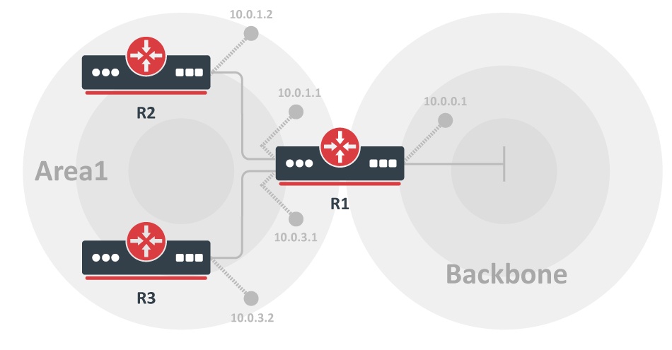

Stub Area
The main purpose of stub areas is to prevent such areas from carrying external routes. Routing from these areas to the outside world is based on a default route. A stub area reduces the database size in an area and the memory requirements of routers in the area.
The stub area has a few restrictions. ASBR routers cannot be internal to the area, and the stub area cannot be used as a transit area for virtual links. These restrictions exist because the stub area is configured not to carry external routes.
This area supports 1, 2, and 3 LSAs.

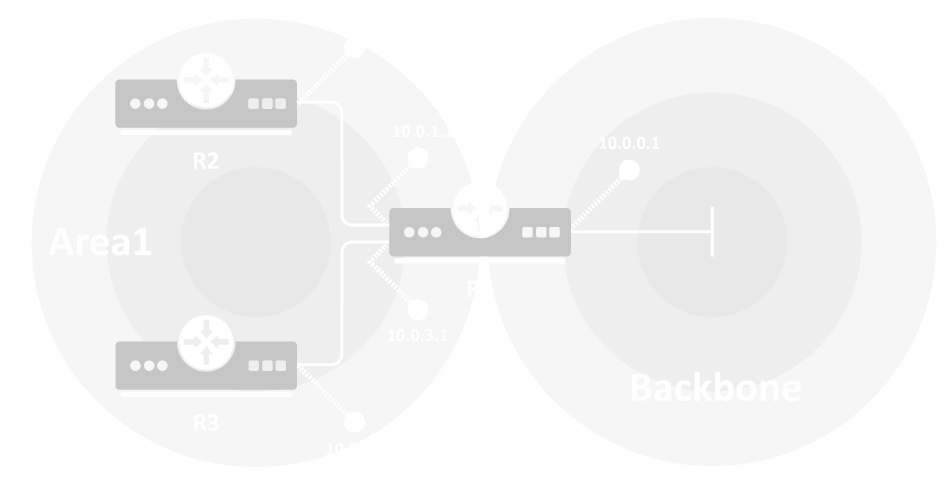

Consider the previous example. Area1 is configured as a stub area, meaning routers R2 and R3 will not receive any routing information from the backbone area except the default route.
R1:
/routing/ospf/area
add name=area1 area-id=1.1.1.1 type=stub instance=v2inst
add networks=10.0.0.0/24 area=backbone_v2
add networks=10.0.1.0/24 area=area1
R2:
/routing/ospf/area
R3:
/routing/ospf/area
If the default-cost parameter is not set, then stub area type-3 default LSA will not be originated.

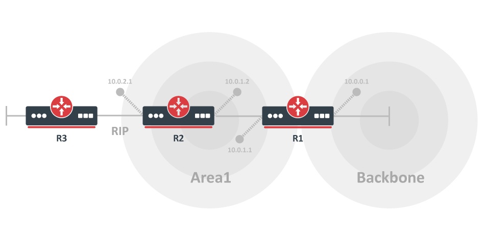

NSSA

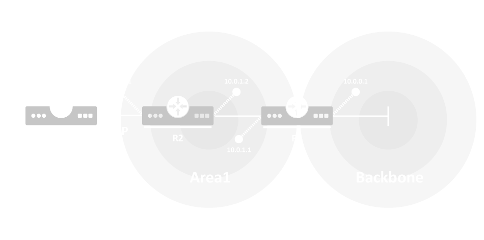

Not-so-stubby area (NSSA) applies when external route injection is required, but injection of type 5 LSA routes is not. See also Understanding OSPF for the NSSA RFC reference.
The illustration shows two areas (backbone and area1) and a RIP connection to the router located in area1. Area1 must be configured as a stub area, but external RIP routes must also be injected into the backbone. Area1 should be configured as NSSA in this case.
The configuration example does not cover RIP configuration.
R1
/routing/ospf/area
add name=area1 area-id=1.1.1.1 type=nssa instance=v2inst
R2
/routing/ospf/area
Virtual links cannot be used over NSSA areas. Use the nssa-translator parameter to control type-7 to type-5 LSA translation.

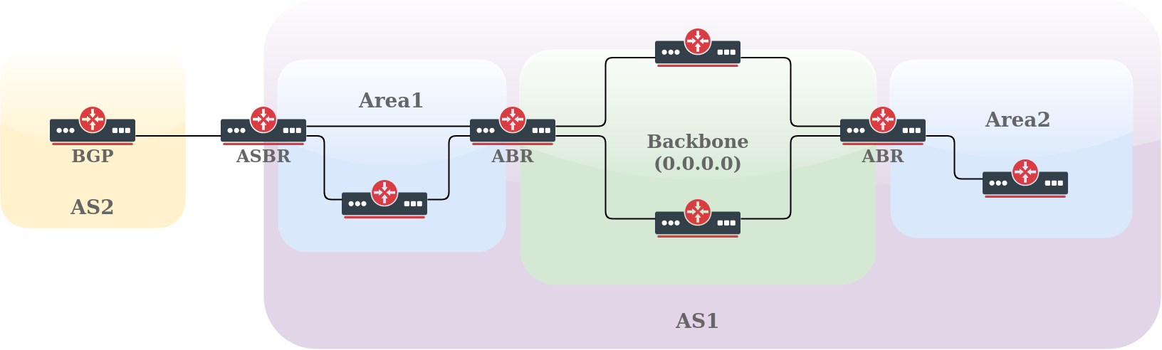

External Routing Information and Default Route

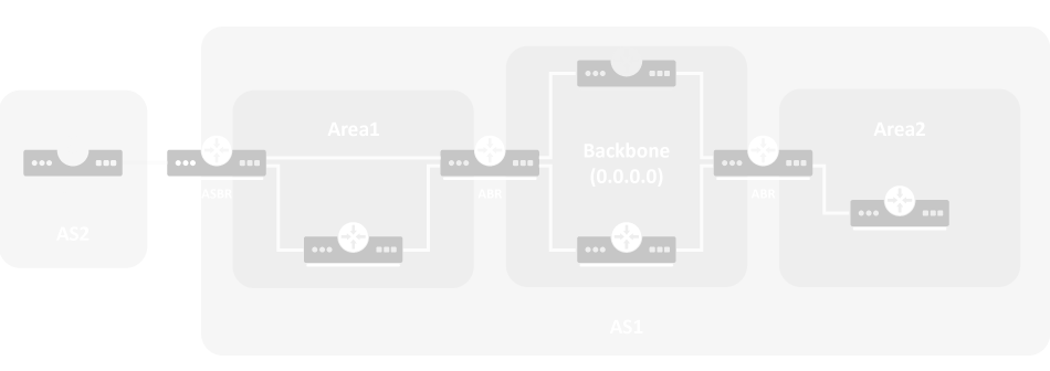

On the edge of an OSPF routing domain, you can find routers called AS boundary routers (ASBRs) that run one of the other routing protocols. The job of those routers is to import routing information learned from other routing protocols into the OSPF routing domain. External routes can be imported at two separate levels depending on the metric type.
- Type1 - OSPF metric is the sum of the internal OSPF cost and the external route cost.
- Type2 - OSPF metric is equal only to the external route cost.
Type 1 external paths are always preferred over type 2 external paths. When all paths are type 2 external paths, the paths with the smallest advertised type 2 metric are always preferred. (RFC2328)

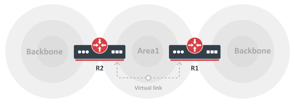

Virtual Link
All OSPF areas must be attached to the backbone area, but sometimes the physical connection is not possible. To overcome this limitation, areas can be attached logically by using virtual links.
There are two common scenarios when virtual links can be used:
- To glue together the fragmented backbone area.
- To connect a remote area without a direct connection to the backbone.

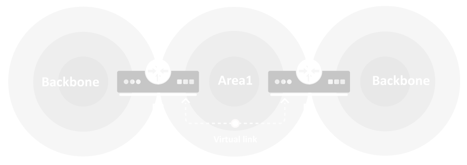

Partitioned Backbone
OSPF allows linking of discontinuous parts of the backbone area by using virtual links. This might be required when two separate OSPF networks are merged into one large network. Virtual links can be configured between separate ABRs touching the backbone area from each side and having a common area.
The additional area could be created to become a transit area when a common area does not exist. It is illustrated in the previous image.
Virtual links are not required for non-backbone areas when they get partitioned. OSPF does not actively attempt to repair area partitions. Each component simply becomes a separate area when an area becomes partitioned. The backbone performs routing between the new areas. Some destinations are reachable through intra-area routing. The area partition requires inter-area routing.
However, to maintain full routing after the partition, an address range must not be split across multiple components of the area partition. Consider using BFD for faster failure detection on virtual links.

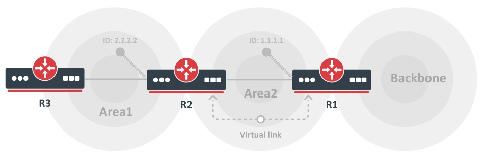

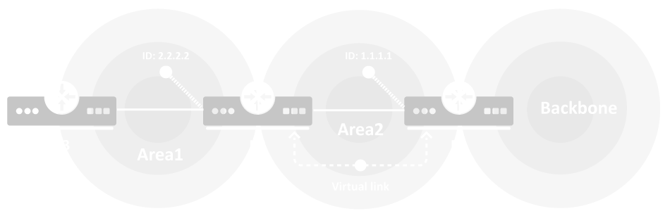

No Physical Connection to a Backbone
An area might not have a physical connection to the backbone. A virtual link provides a logical path to the backbone for the disconnected area. A link must be established between two ABRs sharing a common area, with one ABR connected to the backbone.
Both R1 and R2 are ABRs, and R1 is connected to the backbone area. Area2 will be used as a transit area, and R1 is the entry point into the backbone area. A virtual link must be configured on both routers.
Add virtual link configuration in the /routing/ospf/interface menu. The vlink-transit-area and vlink-neighbor-id parameters must be configured on both routers. The configuration based on the diagram is as follows:
R1:
add vlink-transit-area=area2 area=backbone_v2 type=virtual-link vlink-neighbor-id=2.2.2.2
R2:
add vlink-transit-area=area2 area=backbone_v2 type=virtual-link vlink-neighbor-id=1.1.1.1
