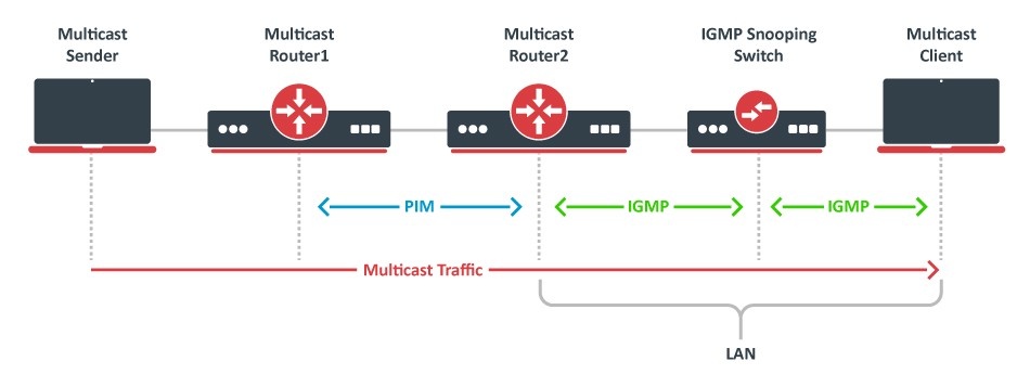

IP Multicast is a technology that allows data to be efficiently shared with many recipients over the Internet. Senders transmit their data to a specific multicast IP address, and receivers indicate their interest in receiving data sent to that address. The network then takes care of delivering the data from senders to receivers.
If both the sender and receiver for a multicast group are on the same local network segment, routers are not required for the process. Communication can happen directly, and this can be enhanced with the use of IGMP snooping switches. However, if the sender and receiver are on different network segments, a multicast routing protocol must be used to establish the path for data transmission between them.
Protocol Independent Multicast - Sparse Mode (PIM-SM or PIM) enables RouterOS to support multicast streaming over the network area. PIM stands for Protocol Independent Multicast, meaning it's not tied to any particular unicast routing. SM stands for Sparse-Mode, which means that specific control messages ensure that data is delivered only to network segments where there are receivers that want it. In addition to the routing protocols that manage data transmission between network segments, routers need a way to discover local receivers on their directly connected network segment. For IPv4, this is achieved through the Internet Group Management Protocol (IGMP), and Multicast Listener Discovery (MLD) for IPv6.

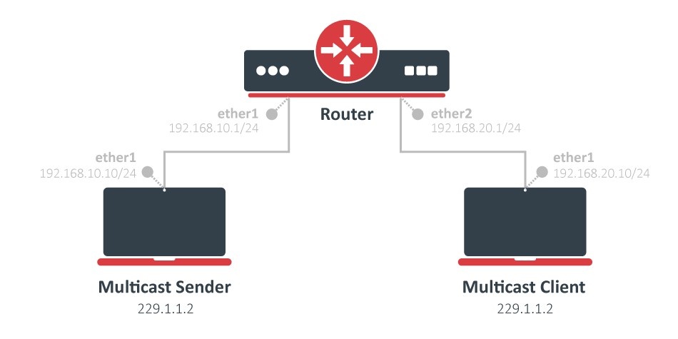

Picture this scenario: you have got a router with two interfaces, namely ether1 and ether2, and each of them is set up in separate networks. Normally, the router will create connected routes and hosts on both networks will be able to communicate using unicast traffic. However, if you want to enable multicast communication between these networks, you'll need to configure multicast routing separately because it won't work otherwise. In this scenario, we are going to create a simple configuration. This involves creating a PIM instance and configuring the required interfaces.
Begin by ensuring that IP addresses are set up on the router's interfaces.

Configure an IGMP querier on ether2 so the PIM instance can learn about local group memberships.
/routing/pimsm/igmp-interface-template
add instance=pimsm-instance-1 interfaces=ether2
Now the router starts listening to IGMP membership reports (client join messages) and will route multicast traffic to clients interested in receiving it.
To test the configuration, you can configure a multicast sender using RouterOS traffic-generator and an IGMP client using GMP.

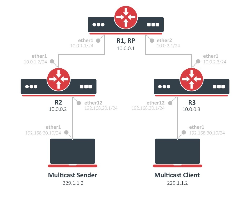

In the upcoming example, we'll be working with multiple PIM routers, as shown in the diagram below. PIM-SM uses shared trees, and to make this work, we need to designate a specific node as the multicast root distribution point. In PIM, this router is called the Rendezvous Point, or RP. There are various methods for selecting an RP in PIM, such as the Bootstrap Router (BSR) method. However, for this example, we'll be using a straightforward approach known as static RP configuration. This means that the administrator can manually specify one or more RPs for specific multicast groups.
To get started, we'll need to configure IP addresses and set up unicast routing. In this example, we'll use OSPF to exchange routing information between the routers. See more details about OSPF.

As in the previous example with a single router, we need to configure the PIM instance and add the necessary interfaces on all routers.

Finally, we will select one router to act as our Rendezvous Point (RP). We will configure the R1 loopback IP address on all PIM routers. It's important to ensure that each router has the correct routing information to reach the R1 loopback address.
