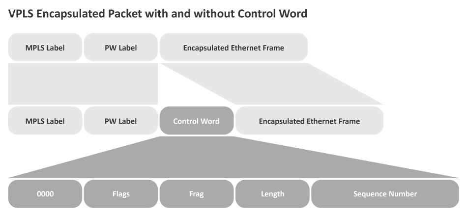

Control Word Usage​
In RouterOS, Control Word is used for packet fragmentation and reassembly inside the VPLS tunnel. This is done by utilizing the optional Control Word (CW). CW is added between the PW label (demultiplexor) and the packet payload and adds an additional 4-byte overhead.
warning
Reordering OOO packets is not implemented, out of order fragments will be dropped
CW usage is controlled by the use-control-word parameter in VPLS configuration.
As you can see Control Word is divided into 5 fields:
  • 0000 - 4-bit identifies that the packet is PW (not IP).
  • Flags - 4bits.
  • Frag - 2bits value that indicates payload fragmentation.
  • Len - 6bits.
  • Seq - 16bits sequence number used to detect packet loss / misordering.
According to RFC, generation and processing of sequence numbers are optional.
