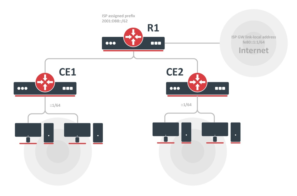

Use received prefix for local RA
Consider the following setup:
  • ISP is routing prefix 2001:DB8::/62 to the router R1.
  • Router R1 runs a DHCPv6 server to delegate /64 prefixes to the customer routers CE1 and CE2.
  • DHCP client on routers CE1 and CE2 receives a delegated /64 prefix from the DHCP server (R1).
  • Client routers use the received prefix to set up RA on the local interface.
Configuration
R1
/ipv6/route
add gateway=fe80::1:1%to-ISP
/ipv6/pool
add name=myPool prefix=2001:db8::/62 prefix-length=64
/ipv6/dhcp-server
add prefix-pool=myPool disabled=no interface=to-CE-routers lease-time=3m name=server1
CE1
/ipv6/dhcp-client
add interface=to-R1 request=prefix pool-name=my-ipv6
/ipv6/address
add address=::1/64 from-pool=my-ipv6 interface=to-clients advertise=yes
CE2
/ipv6/dhcp-client
/ipv6/address/add address=::1/64 from-pool=my-ipv6 interface=to-clients advertise=yes

Enabling IPv6 Prefix delegation
Let's consider that we already have a running DHCP server.
To enable IPv6 prefix delegation, first, we need to create an address pool:
/ipv6/pool/add name=myPool prefix=2001:db8:7501::/60 prefix-length=62
Notice that prefix-length is 62 bits, which means that clients will receive /62 prefixes from the /60 pool.
The next step is to enable DHCP-PD:
/ipv6/dhcp-server/add name=myServer prefix-pool=myPool interface=local

  • You can make the binding to a specific client static so that it always receives the same prefix.
[admin@RB493G] /ipv6/dhcp-server/binding> print
Flags: X - disabled, D - dynamic
# ADDRESS DU IAID SER.. STATUS 0 D 2001:db8:7501:1::/62 16 0 loc.. bound
[admin@RB493G] /ipv6/dhcp-server/binding> make-static 0
  • DHCP-PD also installs a route to the assigned prefix into the IPv6 routing table:
[admin@RB493G] /ipv6/route> print
Flags: X - disabled, A - active, D - dynamic, C - connect, S - static, r - rip, o - ospf, b - bgp, U - unreachable
# DST-ADDRESS GATEWAY DISTANCE
2 ADS 2001:db8:7501:1::/62 fe80::224:1dff:fe17:8... 1

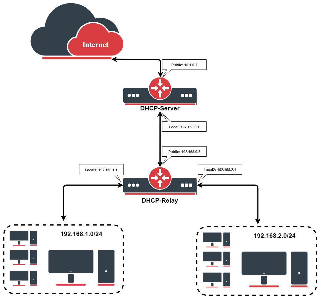

Configuration Example
Let us consider that you have several IP networks 'behind' other routers, but you want to keep all DHCP servers on a single router. To do this, you need a DHCP relay on your network which will relay DHCP requests from clients to the DHCP server.
This example will show you how to configure a DHCP server and a DHCP relay that serves 2 IP networks - 192.168.1.0/24 and 192.168.2.0/24 that are behind a router DHCP-Relay.
IP Address Configuration
IP addresses of DHCP-Server:
[admin@DHCP-Server] /ip/address> print
# ADDRESS NETWORK BROADCAST INTERFACE
0 192.168.0.1/24 192.168.0.0 192.168.0.255 To-DHCP-Relay
1 10.1.0.2/24 10.1.0.0 10.1.0.255 Public
IP addresses of DHCP-Relay:
[admin@DHCP-Relay] /ip/address> print
0 192.168.0.2/24 192.168.0.0 192.168.0.255 To-DHCP-Server
1 192.168.1.1/24 192.168.1.0 192.168.1.255 Local1
2 192.168.2.1/24 192.168.2.0 192.168.2.255 Local2
DHCP Server Setup
To set up 2 DHCP Servers on the DHCP-Server router add 2 pools. For networks 192.168.1.0/24 and 192.168.2.0:
/ip/pool/add name=Local1-Pool ranges=192.168.1.11-192.168.1.100
/ip/pool/add name=Local2-Pool ranges=192.168.2.11-192.168.2.100
[admin@DHCP-Server] /ip/pool> print
# NAME RANGES
0 Local1-Pool 192.168.1.11-192.168.1.100
1 Local2-Pool 192.168.2.11-192.168.2.100
Create DHCP Servers:
/ip/dhcp-server/add interface=To-DHCP-Relay relay=192.168.1.1 \
address-pool=Local1-Pool name=DHCP-1 disabled=no
/ip/dhcp-server/add interface=To-DHCP-Relay relay=192.168.2.1 \
address-pool=Local2-Pool name=DHCP-2 disabled=no
[admin@DHCP-Server] /ip/dhcp-server> print
# NAME INTERFACE RELAY ADDRESS-POOL LEASE-TIME ADD-ARP
0 DHCP-1 To-DHCP-Relay 192.168.1.1 Local1-Pool 3d00:00:00
1 DHCP-2 To-DHCP-Relay 192.168.2.1 Local2-Pool 3d00:00:00
Configure respective networks:
/ip/dhcp-server/network/add address=192.168.1.0/24 gateway=192.168.1.1 \
dns-server=159.148.60.20
/ip/dhcp-server/network/add address=192.168.2.0/24 gateway=192.168.2.1 \
[admin@DHCP-Server] /ip/dhcp-server/network> print
# ADDRESS GATEWAY DNS-SERVER WINS-SERVER DOMAIN
0 192.168.1.0/24 192.168.1.1 159.148.60.20
1 192.168.2.0/24 192.168.2.1 159.148.60.20
DHCP Relay Config
Configuration of DHCP-Server is done. Now let's configure DHCP-Relay:
/ip/dhcp-relay/add name=Local1-Relay interface=Local1 \
dhcp-server=192.168.0.1 local-address=192.168.1.1 disabled=no
/ip/dhcp-relay/add name=Local2-Relay interface=Local2 \
dhcp-server=192.168.0.1 local-address=192.168.2.1 disabled=no
[admin@DHCP-Relay] /ip/dhcp-relay> print
# NAME INTERFACE DHCP-SERVER LOCAL-ADDRESS
0 Local1-Relay Local1 192.168.0.1 192.168.1.1
1 Local2-Relay Local2 192.168.0.1 192.168.2.1
DHCP Relay with VRF (introduced in 7.15)
Let's take the previous setup but we'll consider that the interface to the DHCP server and interfaces to DHCP clients are added in a VRF:
/ip/vrf
add interfaces=To-DHCP-Server name=vrf_server
add interfaces=Local2 name=vrf2
add interfaces=Local1 name=vrf1
In the DHCP-relay configuration dhcp-server-vrf should be added:
/ip/dhcp-relay/set dhcp-server-vrf=vrf_server numbers=0,1
Due to VRF configuration there are several routing-tables - we should add additional routes:
/ip/route
add disabled=no distance=1 dst-address=192.168.0.0/24 gateway=To-DHCP-Server@vrf_server pref-src="" routing-table=vrf1 scope=10 suppress-hw-offload=no \
target-scope=10
add disabled=no distance=1 dst-address=192.168.0.0/24 gateway=To-DHCP-Server@vrf_server pref-src="" routing-table=vrf2 scope=10 suppress-hw-offload=no \
target-scope=10
add disabled=no dst-address=192.168.1.0/24 gateway=Local1@vrf1 routing-table=vrf_server suppress-hw-offload=no
add disabled=no distance=1 dst-address=192.168.2.0/24 gateway=Local2@vrf2 pref-src="" routing-table=vrf_server scope=30 suppress-hw-offload=no \
target-scope=10
To achieve successful DHCP-server - DHCP-relay communication we should add NAT rules:
/ip/firewall/nat
add action=dst-nat chain=dstnat dst-address=192.168.2.1 dst-port=67 in-interface=To-DHCP-Server protocol=udp src-address=192.168.0.1 to-addresses=\
192.168.0.2
add action=dst-nat chain=dstnat dst-address=192.168.1.1 dst-port=67 in-interface=To-DHCP-Server protocol=udp src-address=192.168.0.1 to-addresses=\
192.168.0.2
