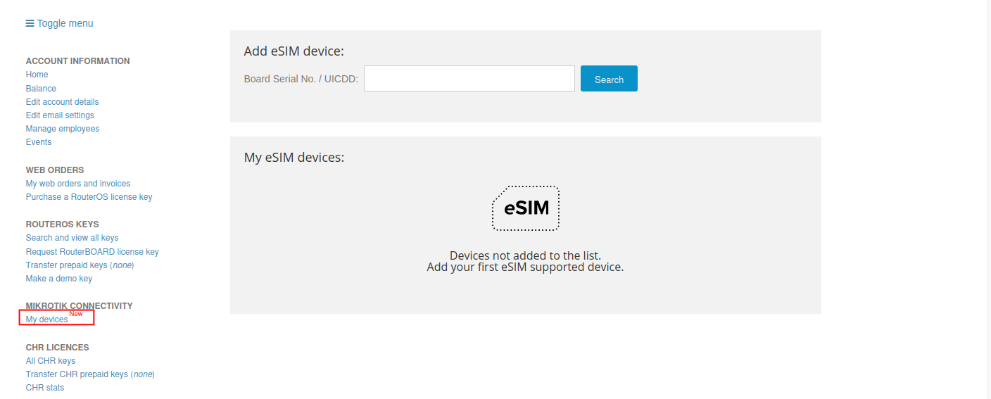

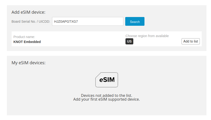

  1. Sign in to your MikroTik account, select "My devices".

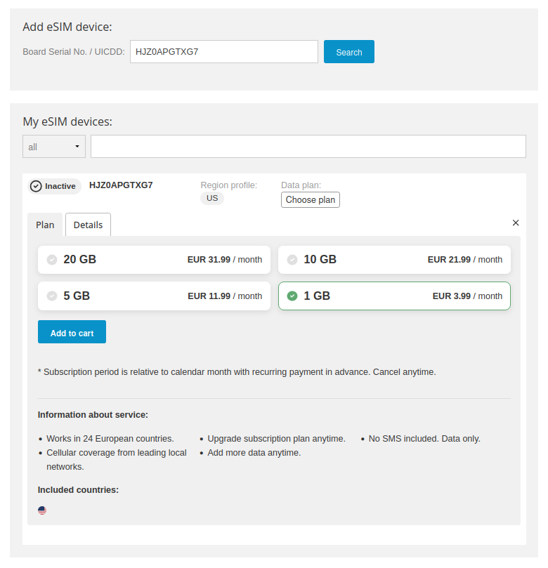

  1. Enter your device’s Serial Number – the system will detect. Choose the region and then press "Add to list".

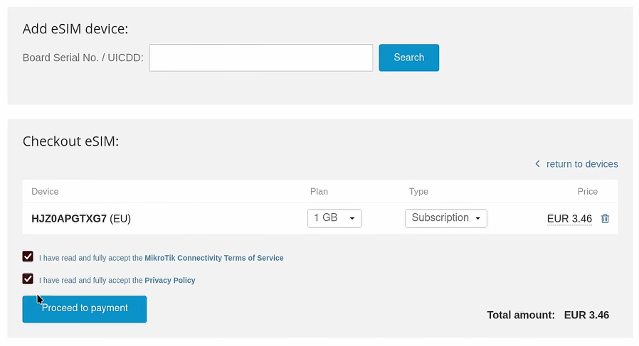

  1. Choose a data plan and payment method that suits your needs. Then add it to the cart.
  1. Proceed with payment in the cart.

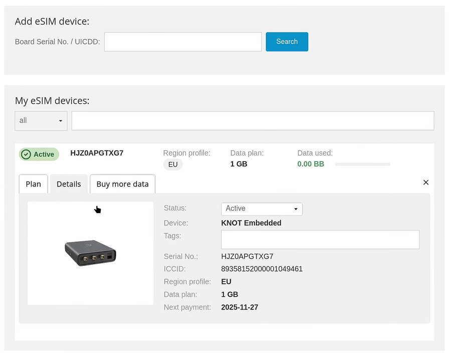

  1. Once payment is done go back to "My devices" and you will see that the subscription is now Active.

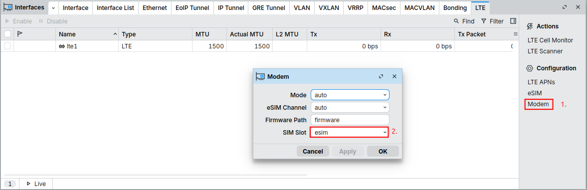

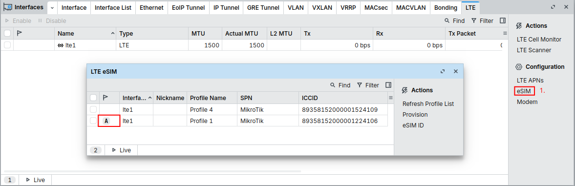

In WinBox:
Go to Interfaces > LTE > Modem to select the esim SIM slot:

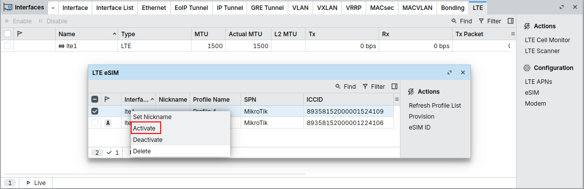

Go to Interfaces > LTE > eSIM to check which is the active esim profile:
If you need to change the Active profile, right click on the profile and select "Activate":

How do I pause, upgrade, or cancel my MikroTik Connectivity subscription?
To manage your eSIM subscription plan, log into your mikrotik.com account and navigate to the "My devices" section. Search for your device's serial number and click on it.
From there, you have two ways to manage your plan:
  • Via the "Plan" tab: Here you will find the option to "Unsubscribe" or upgrade by choosing a different data plan.
  • Via the "Details" tab: Go to the "Status" field, which allows you to switch between Active, Pause data transfer, or Cancel subscription.
