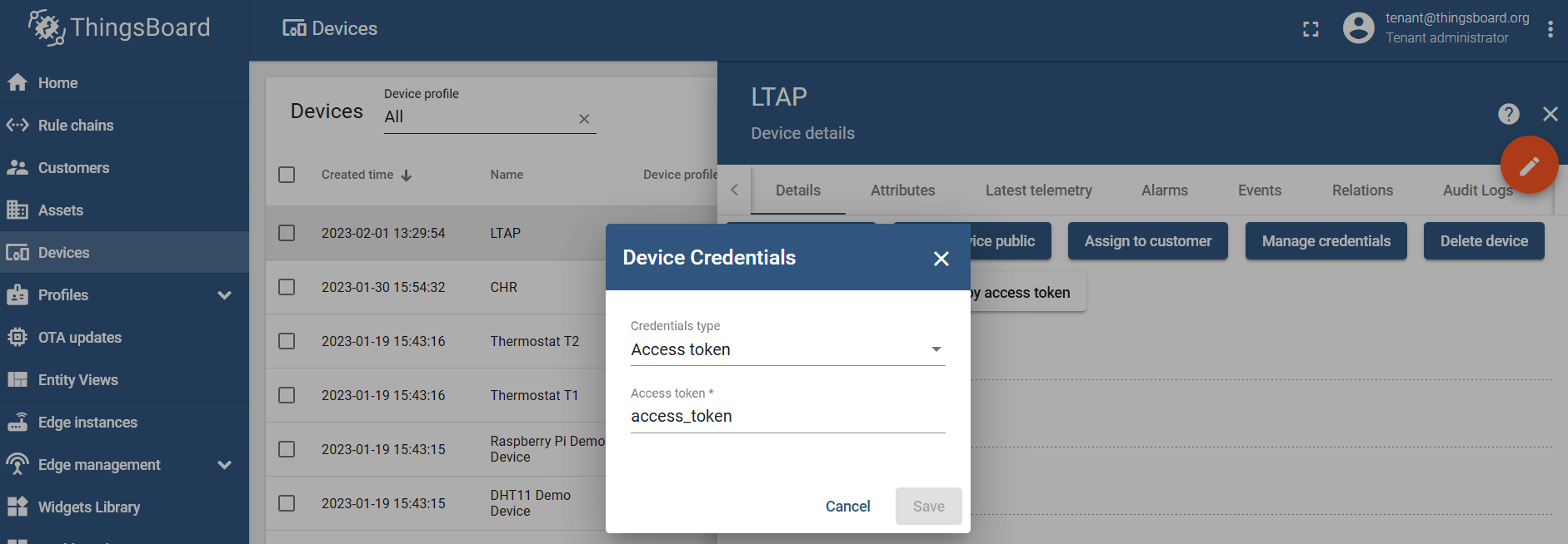

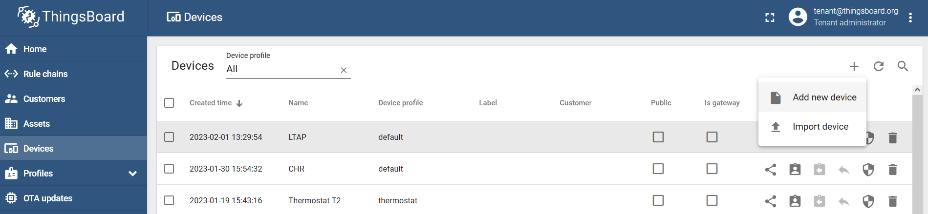

Navigate to the "Devices" menu and add a new device via the "Add new device" button → name it and create it (for example, LTAP):
Click on the device you've just added, go to the "Details" section, and generate an access token under the "Manage credentials/Device Credentials" setting:

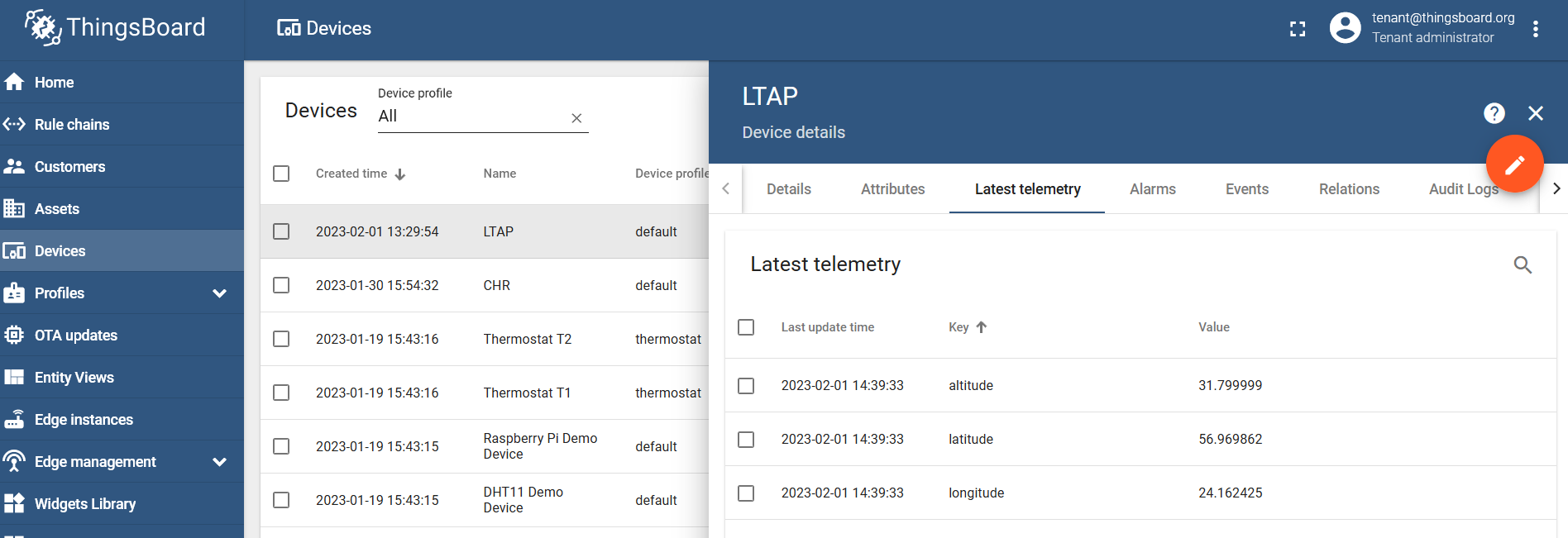

Result verification​
Go to the "Latest telemetry" section under your created device and confirm that the data was posted:

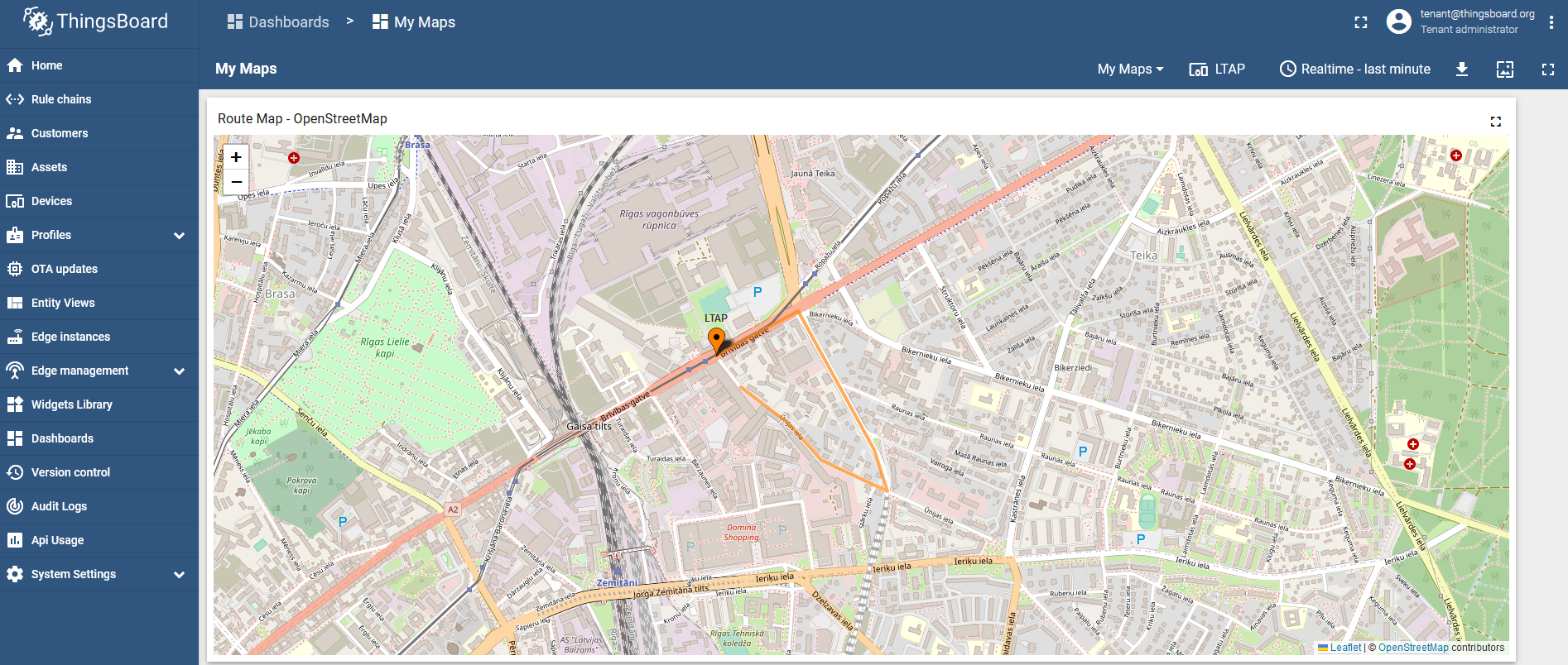

Data visualization using maps​
ThingsBoard allows you to use Widgets to create visually appealing dashboards. In our case, we want to track our LTAP GPS coordinates, so we will need a map widget.

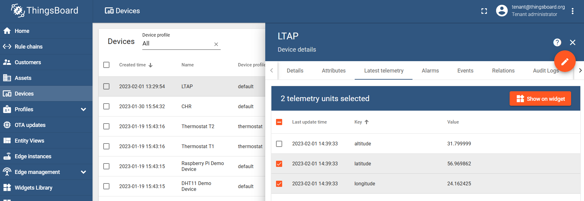

Select the latitude and longitude values and click on the "Show on widget" button:

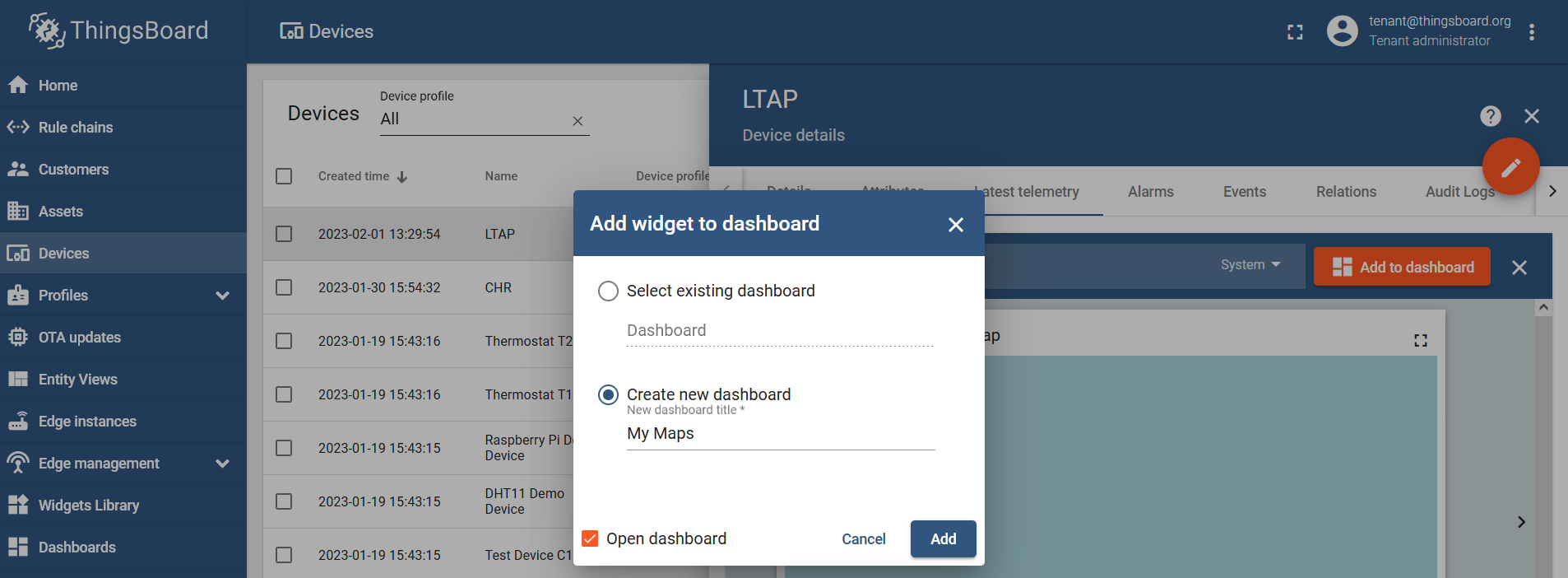

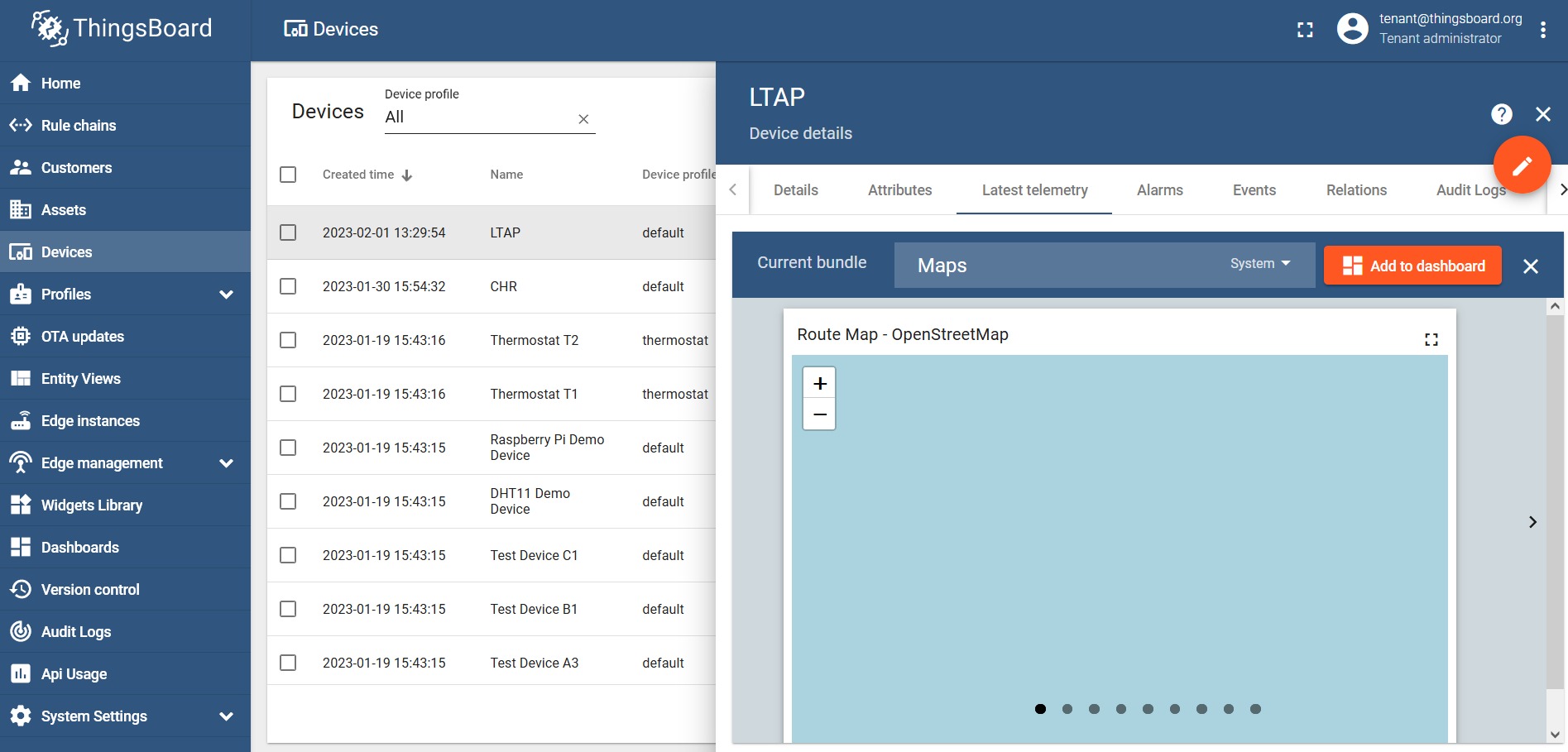

Find the "Maps" bundle and click on the "Add to dashboard":
Select an existing dashboard or create a new one and name it however you like:

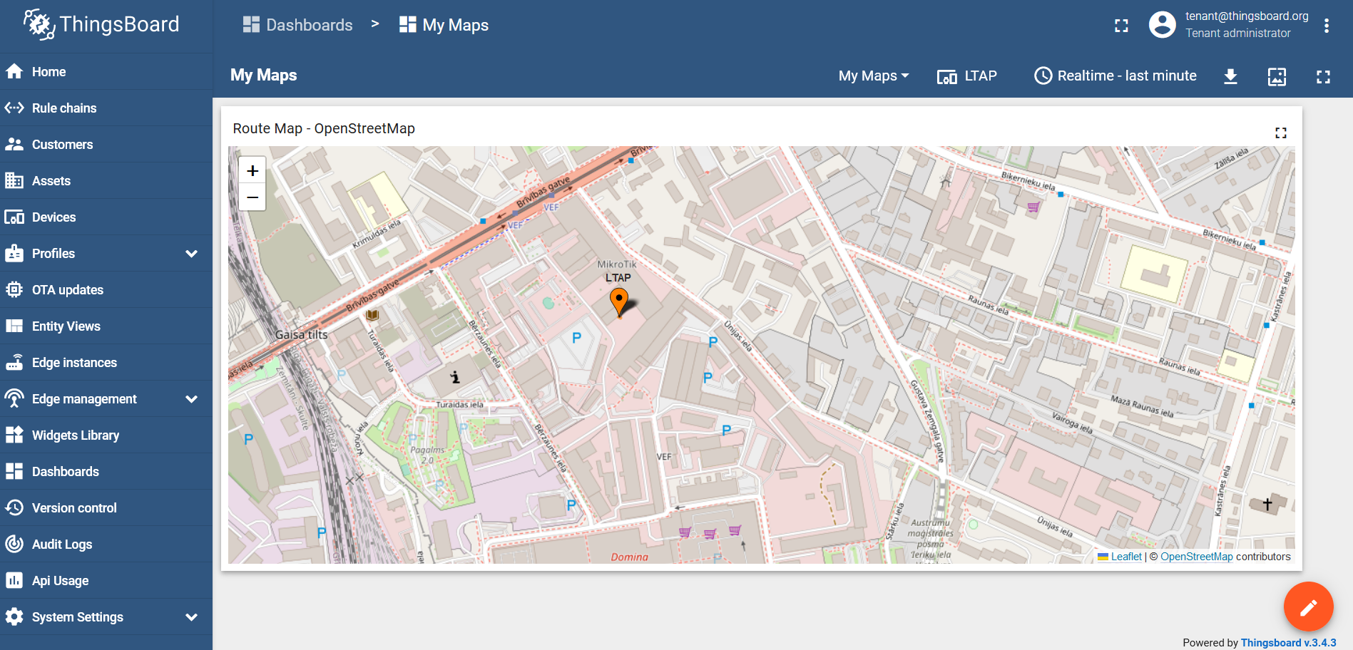

Run the script via the scheduler or manually and check the result:
Now, we can install it on a moving target and track its location:
