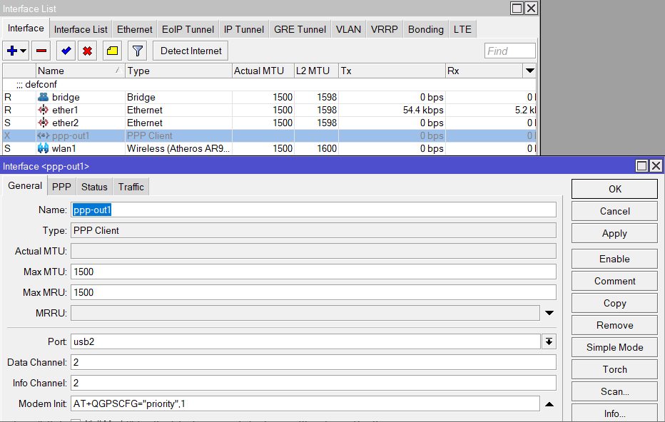

After that, make sure to apply this newly created profile onto the PPP interface:
/interface ppp-client set profile=BG77 0
And confirm that it was applied (profile=BG77):
/interface ppp-client print
Flags: X - disabled; R - running
0 R name="ppp-out1" max-mtu=1500 max-mru=1500 mrru=disabled port=modem data-channel=2 info-channel=2
apn="internet" pin="" user="" password="" profile=BG77 phone="" dial-command="ATDT"
modem-init="AT+QGPSCFG="priority",1" null-modem=no dial-on-demand=yes add-default-route=yes
default-route-distance=1 use-peer-dns=yes keepalive-timeout=30 allow=pap,chap,mschap1,mschap2

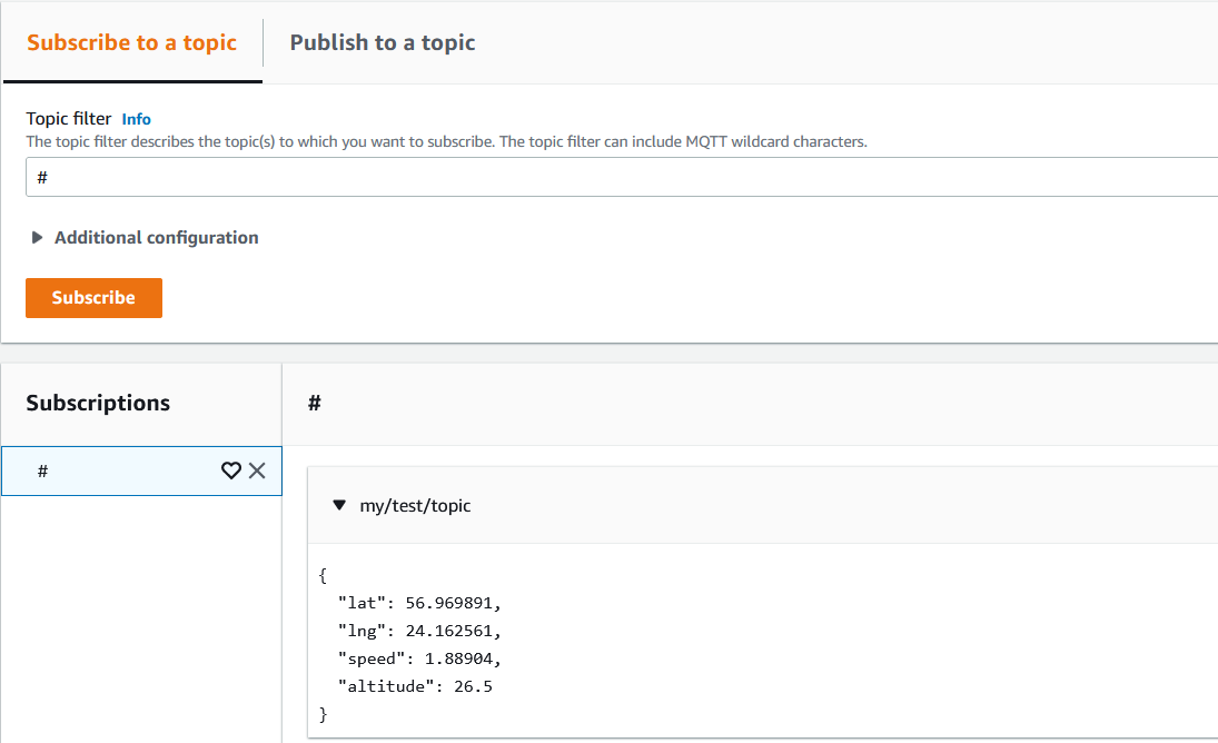

To MQTT:
/iot mqtt publish broker="AWS" topic="my/test/topic" message="{\
                                 \"lat\":$lat,\
                                  \"lng\":$lon,\
                                   \"speed\":$spd,\
                                    \"altitude\":$alt \
Alter the broker, topic, and message as you see fit. You can find more information on how to configure MQTT following the link.
For example, if the MQTT server/broker is AWS, the posted result would look like this:

In order for the script to work, a few conditions must be met.
The first condition is that both ppp interface (Interfaces>Interface) and GPS (System>GPS) must be enabled and work simultaneously. You may need to disable ppp before enabling GPS because they both use the same serial port. When both GPS and ppp are enabled, make sure that the second condition is met.
The second condition is that AT command "AT+QGPSCFG="priority",1" is configured for the ppp interface under the "Modem Init" field:
What this is going to do, is send a WWAN priority command whenever ppp connection gets successfully established.
                                 \"lat\":$lat,\
                                  \"lng\":$lon,\
                                   \"speed\":$spd,\
                                    \"altitude\":$alt \
Do not forget to alter the broker, topic, and message as you see fit. You can find more information on how to configure MQTT following the link.
For example, if the MQTT server is AWS, the result would look like this:
