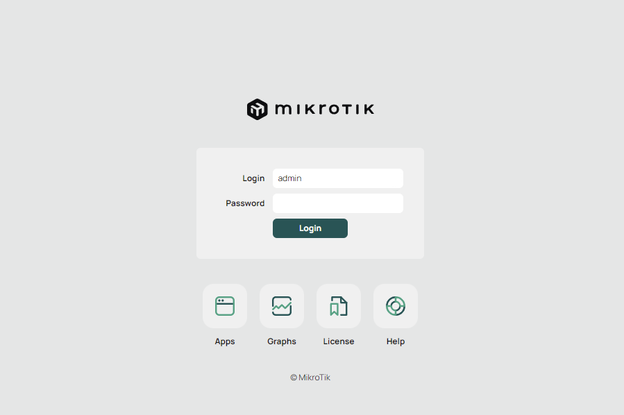

As described in the First Time Configuration section, the device is accessible by default using the username admin and either no password or a default password provided on the device label (depending on the model). Open a web browser and enter the device IP address in the address bar; by default this is 192.168.88.1. Ensure the management device is configured with an IP address in the same subnet (for example, 192.168.88.2), otherwise Layer 3 connectivity does not work.

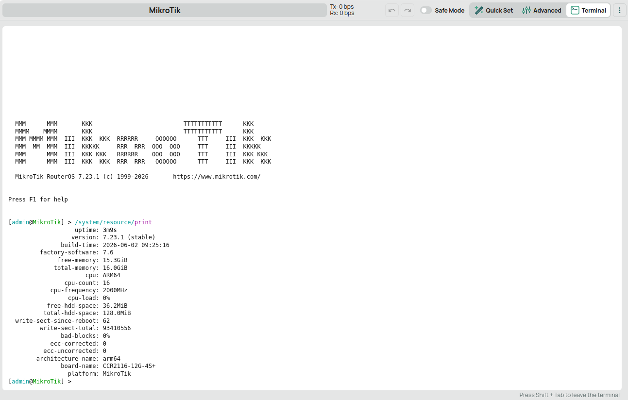

The Terminal (Command Line Interface, CLI) in WebFig is available in the top-right corner. It provides the same functionality as the New Terminal in the WinBox interface.
WebFig Terminal

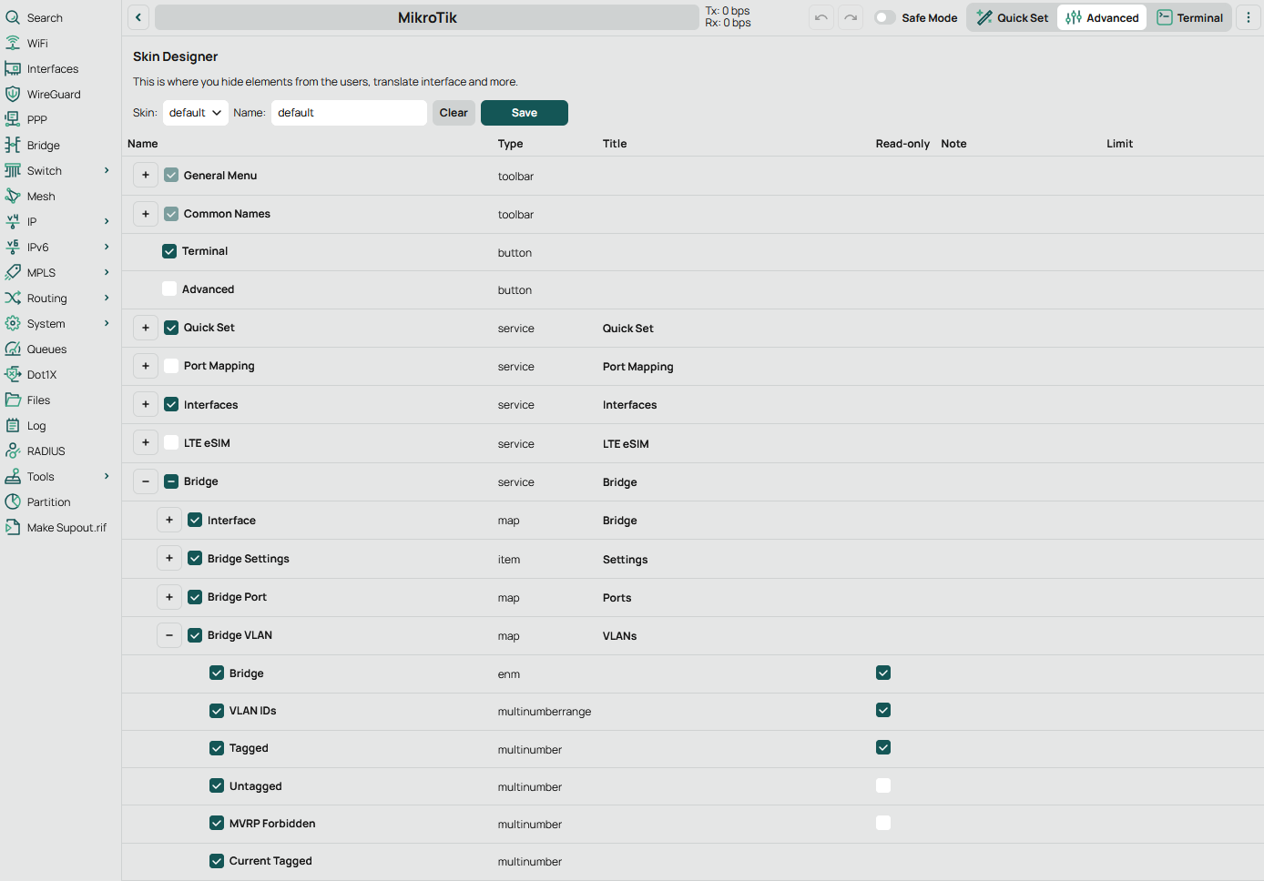

Designing skins​

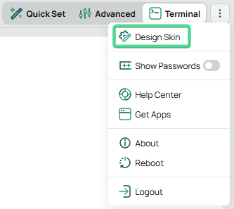

If the user has sufficient permissions (the user group has the policy and sensitive policies enabled), the Design Skin button becomes available. Enabling this option opens the interface customization tools.
To restrict access to the Design Skin menu, disable the policy and sensitive permissions in the user group configuration.
Available operations:
  • Hide menu - hides a menu and all of its submenus.
  • Hide submenu - hides a specific submenu.
  • Hide tabs - hides individual tabs in a multi-tab view.
  • Rename menus and items - changes menu labels, for example for localization or clarity.
  • Add a note to an item - adds comments in the detailed view.
  • Make item read-only - prevents editing of selected fields for safety.
  • Hide flags - hides flags in both list and detailed views.
  • Add field limits - restricts allowed values in the detailed view:
    • Numeric intervals (..) - defines allowed ranges, for example 1..10 for numeric fields such as MTU.
    • Field prefix limits - restricts allowed prefixes for text-based fields. A trailing $ enforces exact prefix matching. For example, station$ limits values to station only.
  • Add tab - inserts a labeled section divider before a field.
  • Add separator - inserts a horizontal separator before a field.

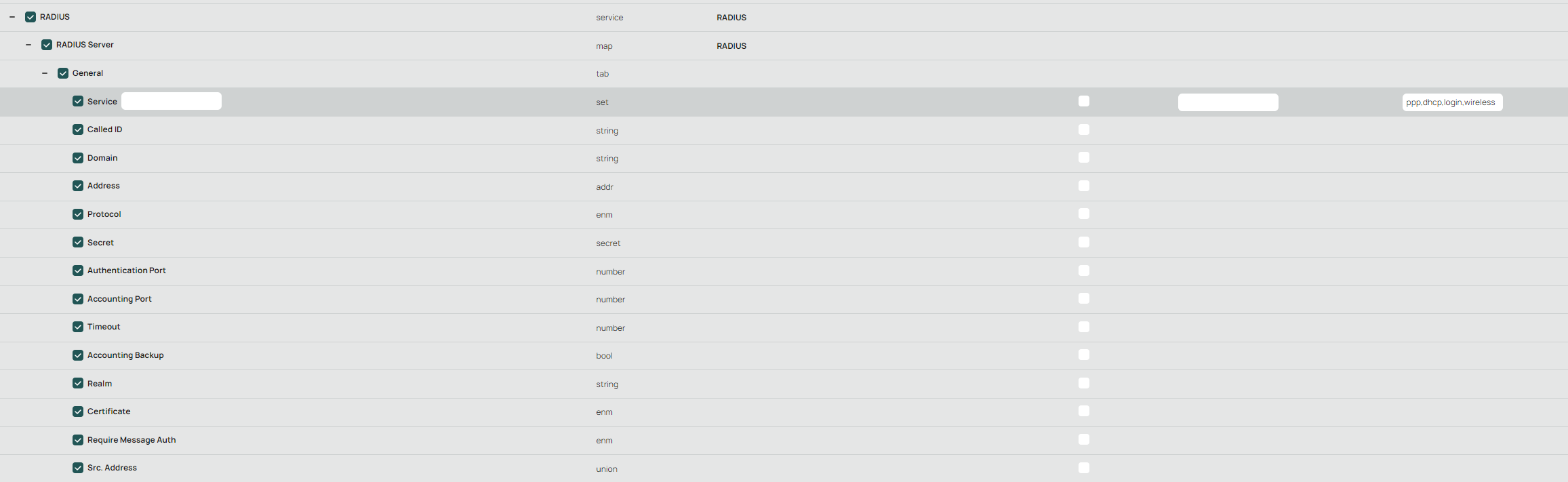

Skin Design Example​
To restrict a user to specific services, add a limit to the RADIUS Service field.
The resulting configuration allows only the services specified in the Limit field.

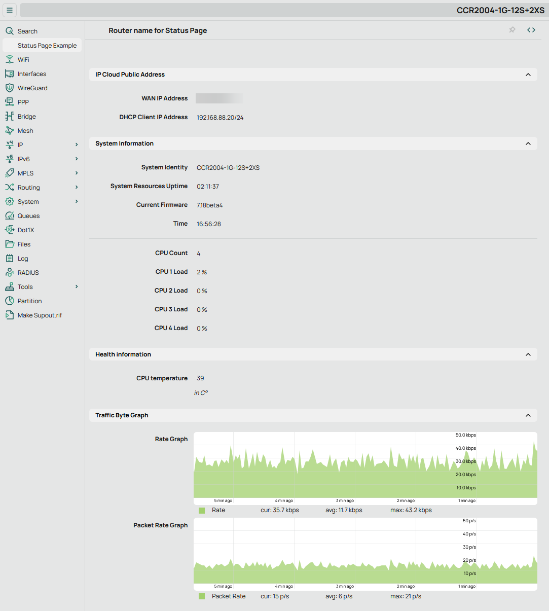

An example of a Status page structure that can be used in a skin *.json file is available here: status_main_example.json
The status content follows this structure: {"Status": {"Status": {}}}
Status records are displayed in sequential order, for example:
"7": {
"alias": (path to the record),
"note": (optional; free form text that appears under the record),
"name": (optional; alternative name for the record),
"tab": (optional; name of the tab that this and following records belong to),
"separator": 1 (optional; should a separating line be placed before this record)
