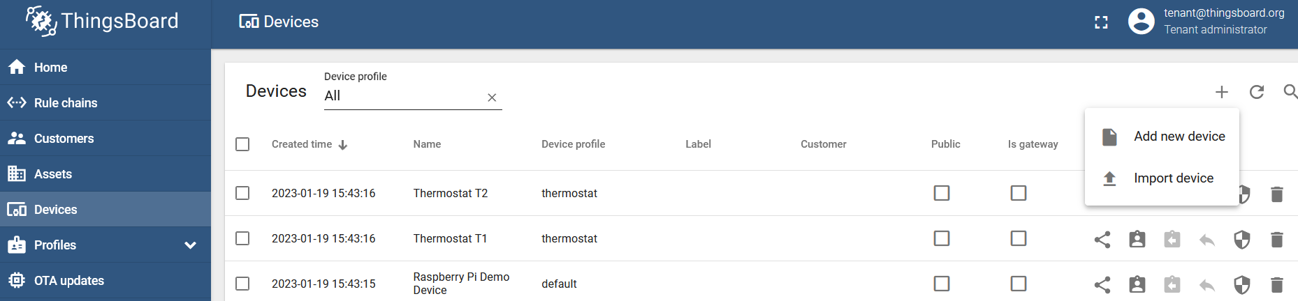

Access the login page via your browser and log in. Go to the "Devices" menu.
Create a new device by clicking on the add button "+" and "Add new device":

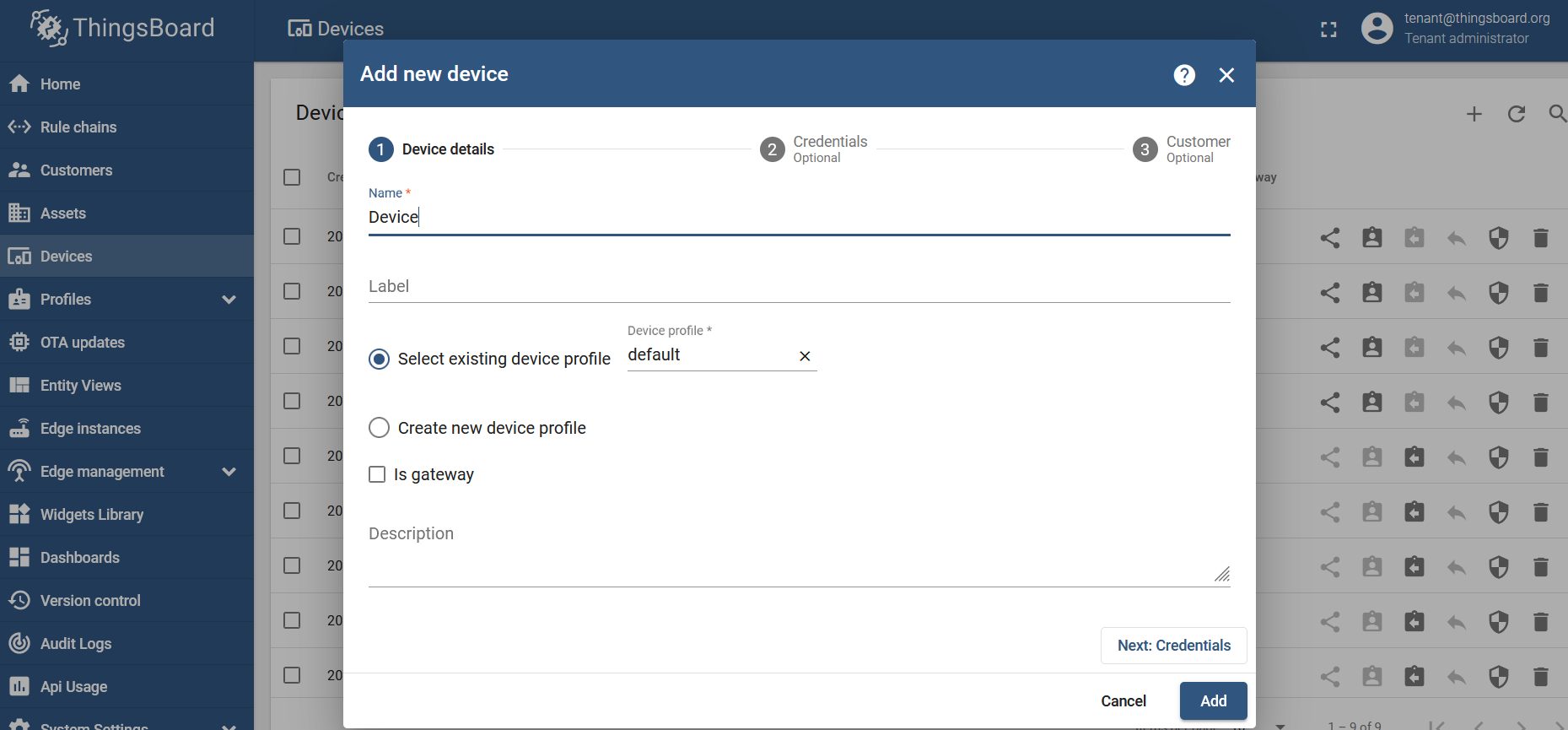

Enter the name of the device and click on "Add":
By default, access token authentication is selected for the newly created device.

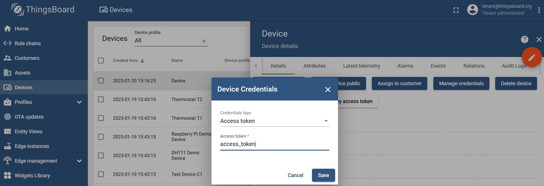

Access token scenario​
You can change the token by clicking on the created device and entering the "Manage Credentials" settings (in the "Details" section):
This token will be used as a "username" for the MQTT publisher (in RouterOS settings).

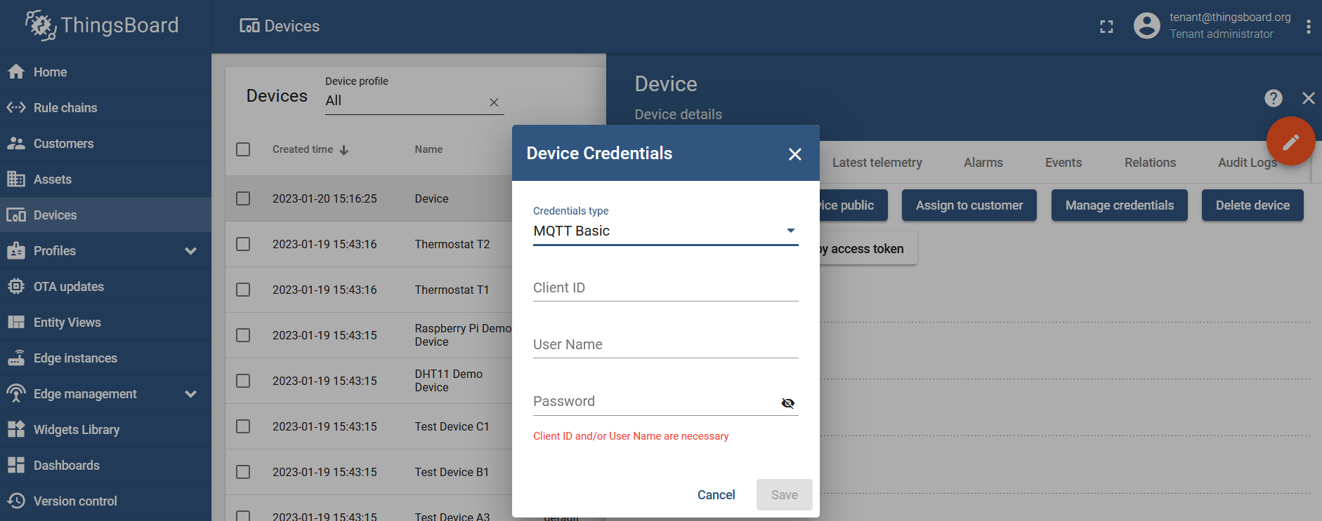

MQTT Basic scenario​
You can change the credentials type in the "Device Credentials" section for the specific device:
MQTT Basic scenario allows you to specify the Client ID, Username, and Password for the MQTT authentication.
You can find more information by following the link.

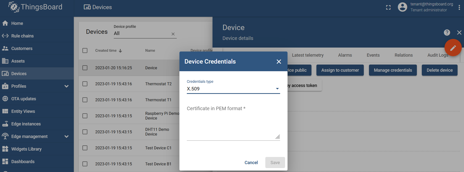

X.509 scenario uses a client certificate for authentication.
Once the certificate is generated (for example, using OpenSSL), copy the RSA public key into the field and click on the "Save" button.

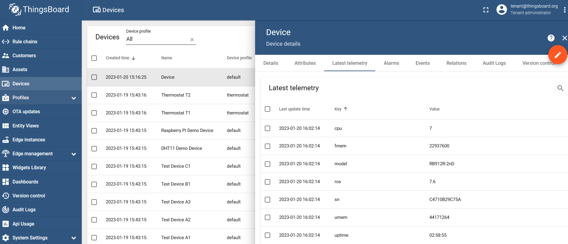

Verification​
You can check the received/published data for the device under the "Latest telemetry" section:
