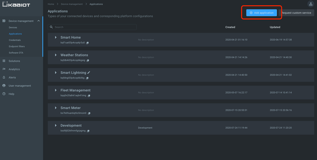

a) Create an application, under "Home>Device management>Applications", by clicking on the "Add application" button, name it, and "Create" it:

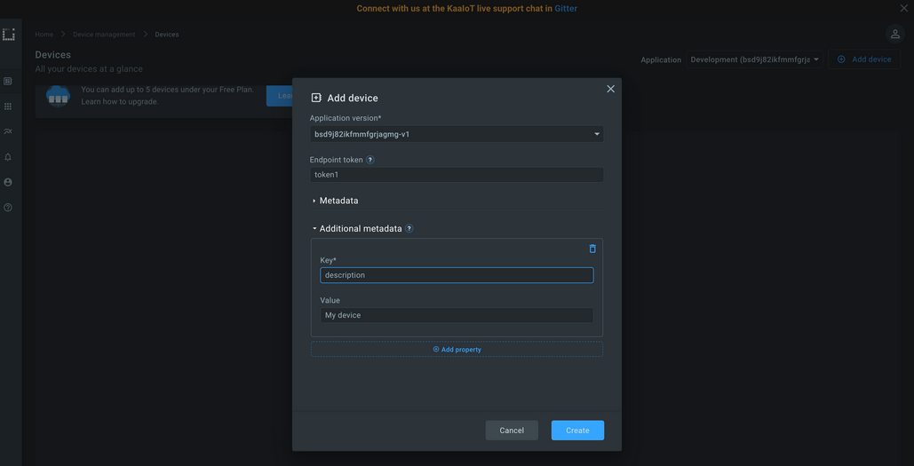

b) Create a device, under "Home>Device management>Devices", by clicking on the "Add device" button, name it, and "Create" it:
Input your own "Endpoint token" or let the system auto-generate one for you. Make sure to "save" it (because you will not be able to access it again).

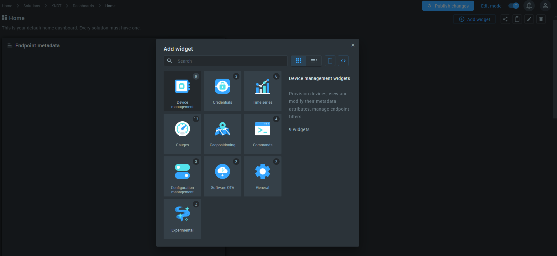

To visualize previously posted data, go to "Home>Solutions>Your_Solution>Dashboards>Your_Dashboard" and click on "Add widget":
Select a widget type (we will use "Device management"), and a pre-set widget (we will use "Endpoint metadata").
"Edit" the widget and choose your "Endpoint ID" under "Data source>Endpoint ID". From here, you can customize the dashboard further:
