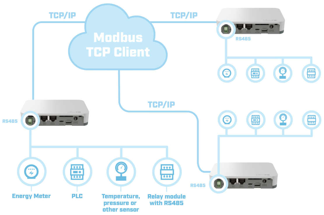

The KNOT supports:
  • Modbus TCP server scenario, which allows you to use 3d-party Modbus clients to send function code commands to the KNOT's IP address using Modbus TCP/IP connection (TCP port 502). You can use any Modbus Client software (there are plenty on the internet) or it can be easily written/configured in Python. In this case, the KNOT "translates/bridges" Modbus TCP/IP requests to Modbus RTU.
  • Modbus RTU controller scenario (available only starting with v7.10), which allows you to send function code commands directly from the RouterOS command line via Modbus/RTU.
