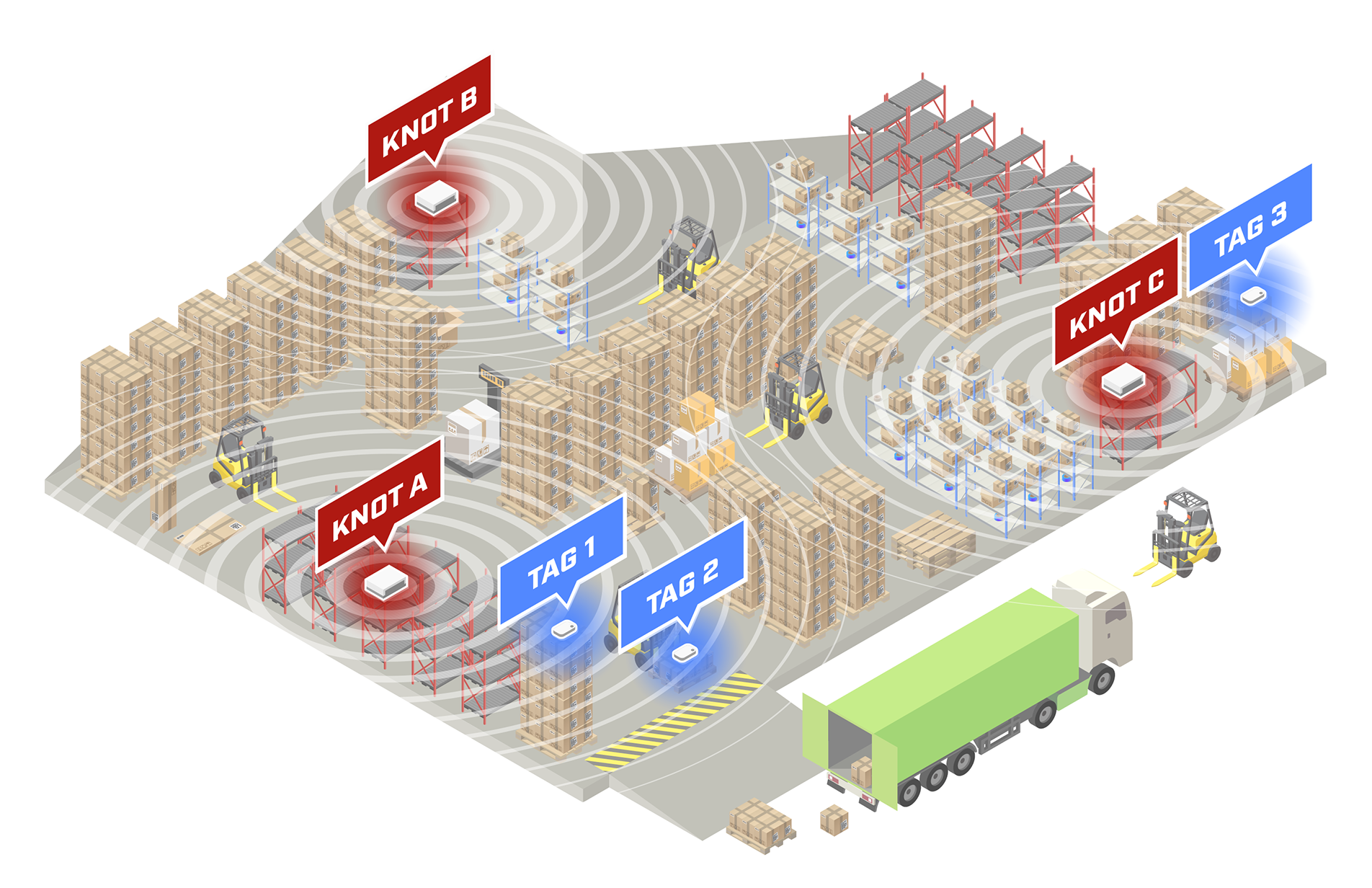

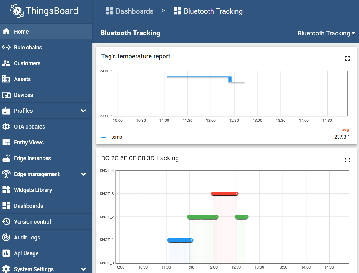

Example #1​
One of the use cases is shown in the topology below:
note
The scale of objects and Bluetooth operating ranges are just shown as an example, to help visually understand and imagine the topology!
We have a warehouse area and we have 3 assets (pallets) that we are interested in tracking. We also have 3 zones: zone A, where newly arrived pallets are stored; zone B, where our assets are relocated to be inspected; and zone C, where assets are moved after inspection. To achieve Bluetooth asset-tracking, just install x1 KNOT per zone and x1 tag per asset.
If TAG 1 and TAG 2 (pallets) arrive in the "arrival" zone A, KNOT A will report to the server that both assets are within its Bluetooth range. If TAG 3 gets moved to zone C, the server will indicate it is within the KNOT C range. If TAG 1 and TAG 2 move toward the B zone, and stay on the edges between A and B zones, the server will show that they are in the overlapped area (at the same time within KNOT-A and KNOT-B ranges). If the tags move to the middle of the warehouse, the server will indicate that they are in all 3 zones at once, in the overlapping area.

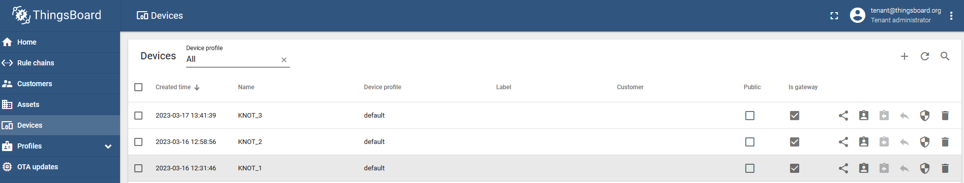

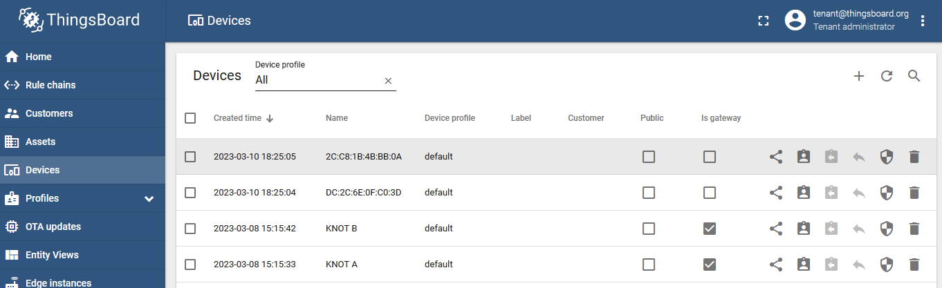

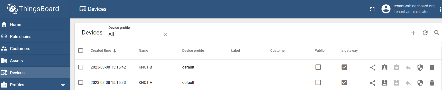

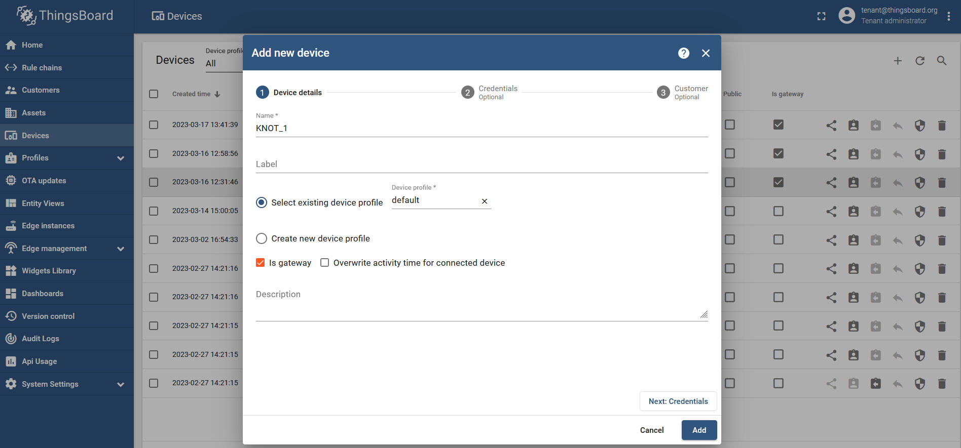

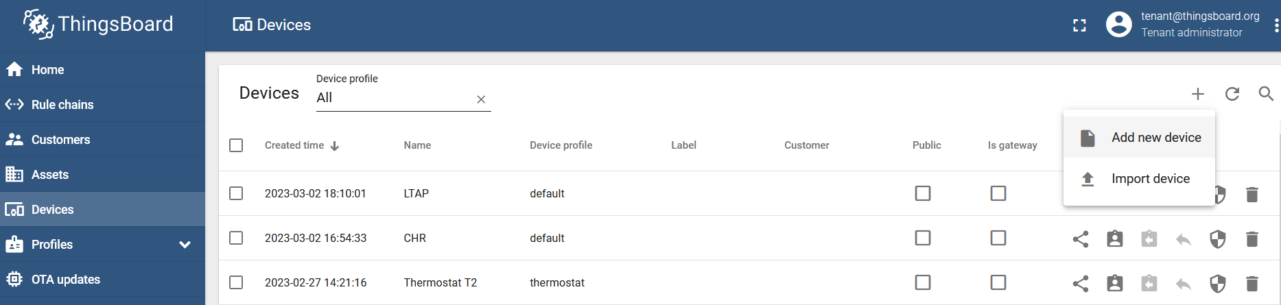

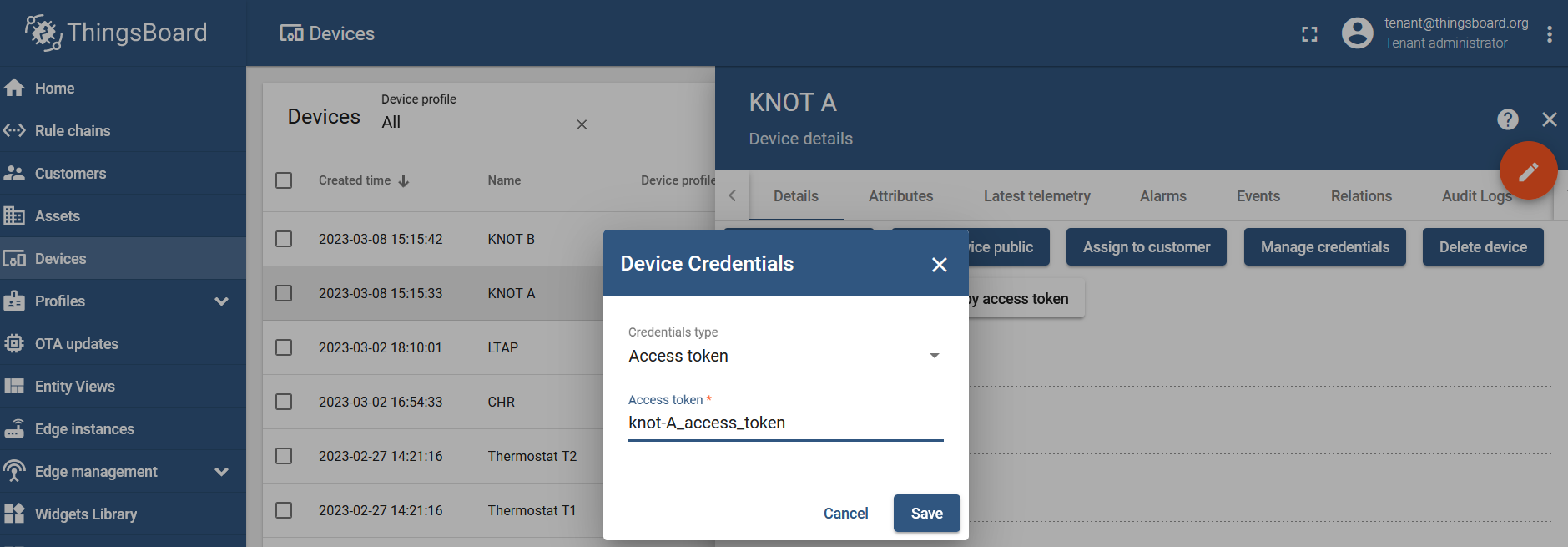

Create 2 KNOTs under the ThingsBoard GUI and make them "gateways".
Go to the "Devices" section, click on the "+" button and "Add new device":

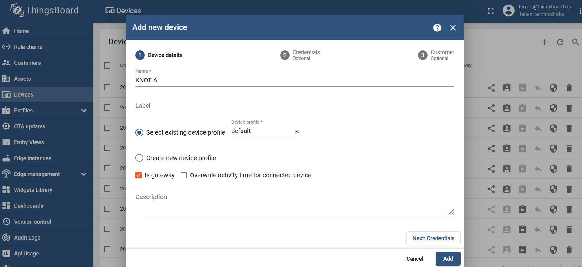

Name the device and check the "Is gateway" option:
Do that for each KNOT that you have:

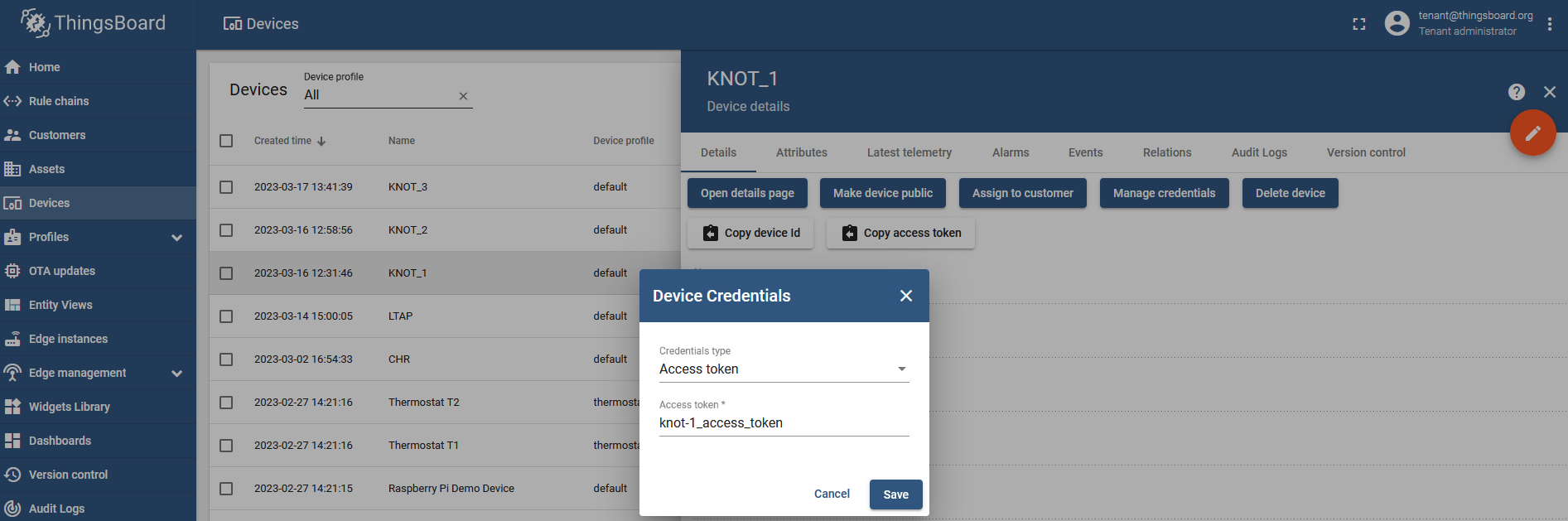

Set up a unique access token (unique credentials) for each KNOT under the device you've just created, under the "Manage credentials" tab:

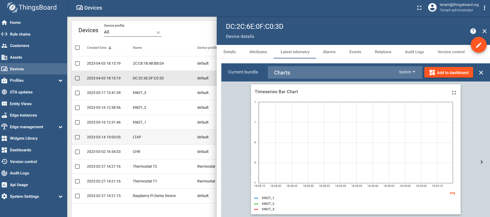

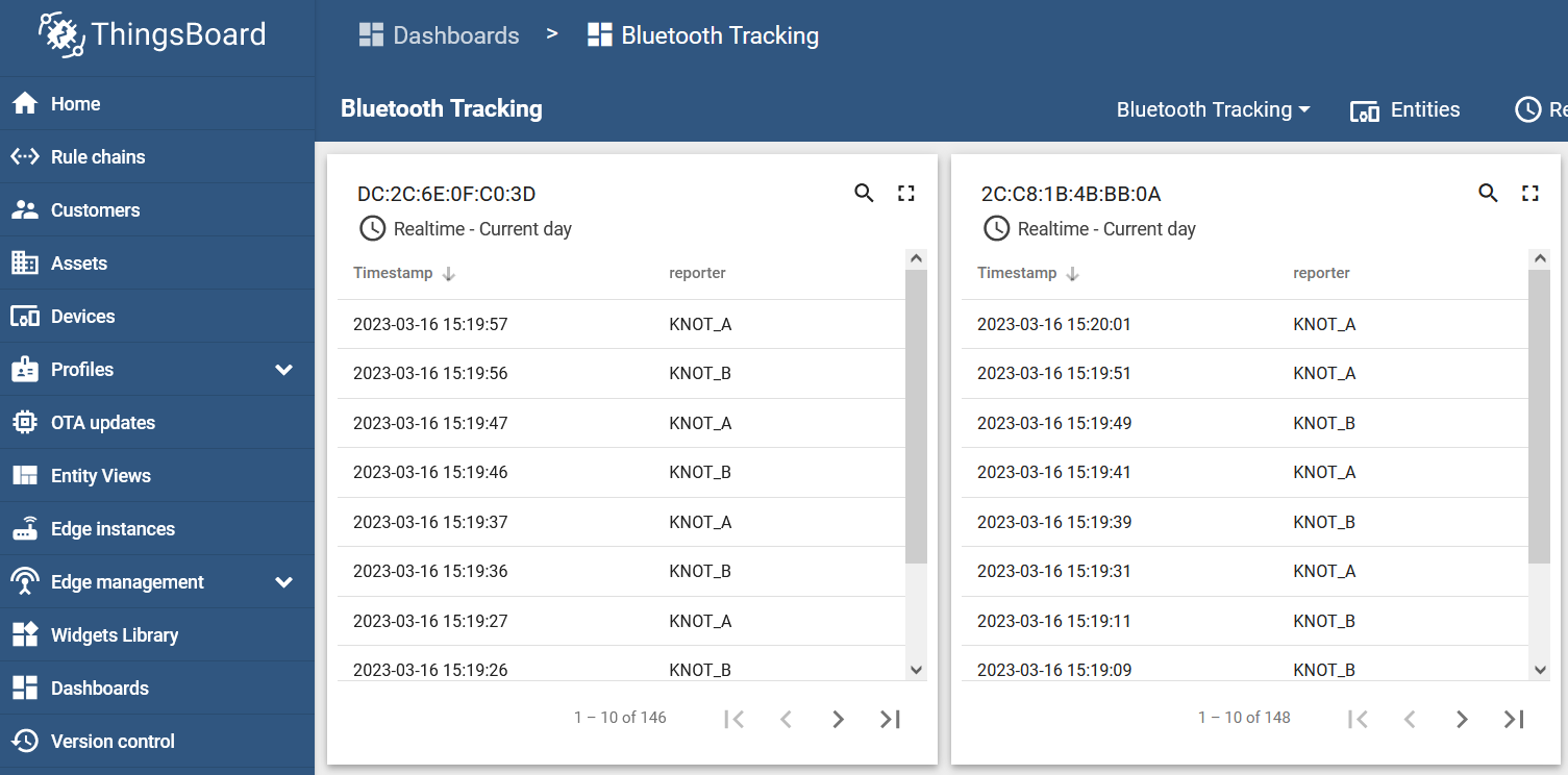

How does the script work when you run it? The script "inspects" the "Advertising reports" tab (payload list tab) using the filters applied and structures a JSON message. An example of the JSON message would be:
"2C:C8:1B:4B:BB:0A": [
"ts": 1678967250600,
"values": {
"reporter": "KNOT_A",
"rssi": -47
"DC:2C:6E:0F:C0:3D": [
"ts": 1678967247850,
"values": {
"rssi": -59
"ts": 1678967257849,
"values": {
"rssi": -67
The data is structured per the ThingsBoard guide, where 2C:C8:1B:4B:BB:0A and DC:2C:6E:0F:C0:3D are MAC addresses of tags that appeared in the KNOT's range, ts is a Unix timestamp of each payload broadcasted by the tag in milliseconds, reporter indicates which specific KNOT has sent the message and rssi is the signal strength of each payload broadcasted by the tag in dBm.
After the payload list is "searched" and the JSON message is structured, the Bluetooth interface payload list gets "cleaned" (or "flashed"), and the previously structured JSON message is sent to the ThingsBoard MQTT broker.

ThingsBoard data visualization and result verification​
After you run the script with /system/script/run tracking or via a scheduler and refresh the GUI portal, all MAC addresses (tags) that are found in the JSON message will be made into new devices under the ThingsBoard GUI:

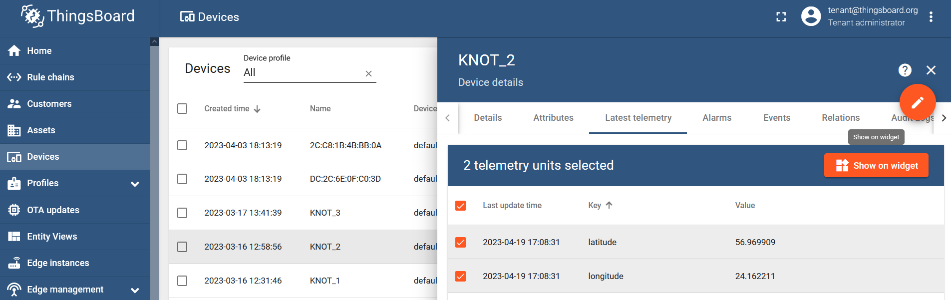

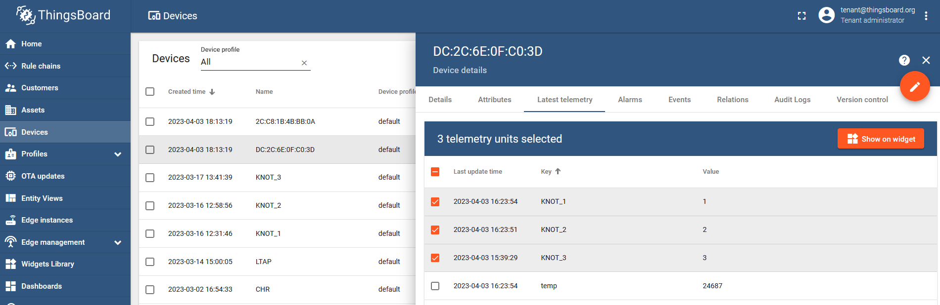

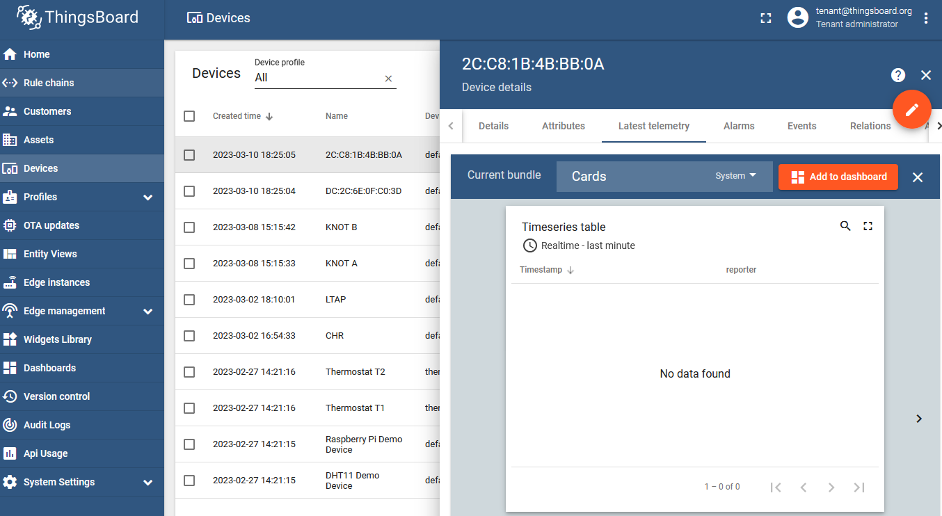

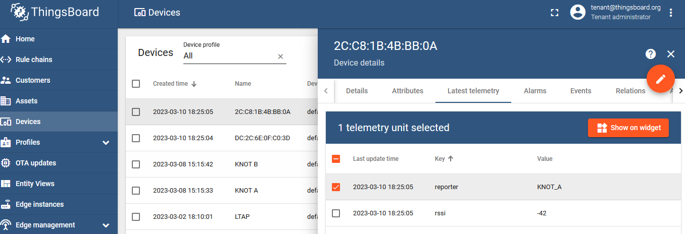

Select the tag's MAC address from the list of devices, go to the "Latest telemetry" section, check the "reporter" parameter, and click on the "Show on widget" button:

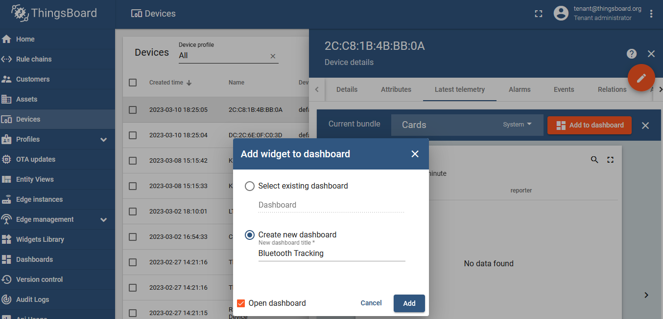

Select a widget that you wish to use, for example, under the "Cards" bundle, "Timeseries table", and click on "Add to dashboard":

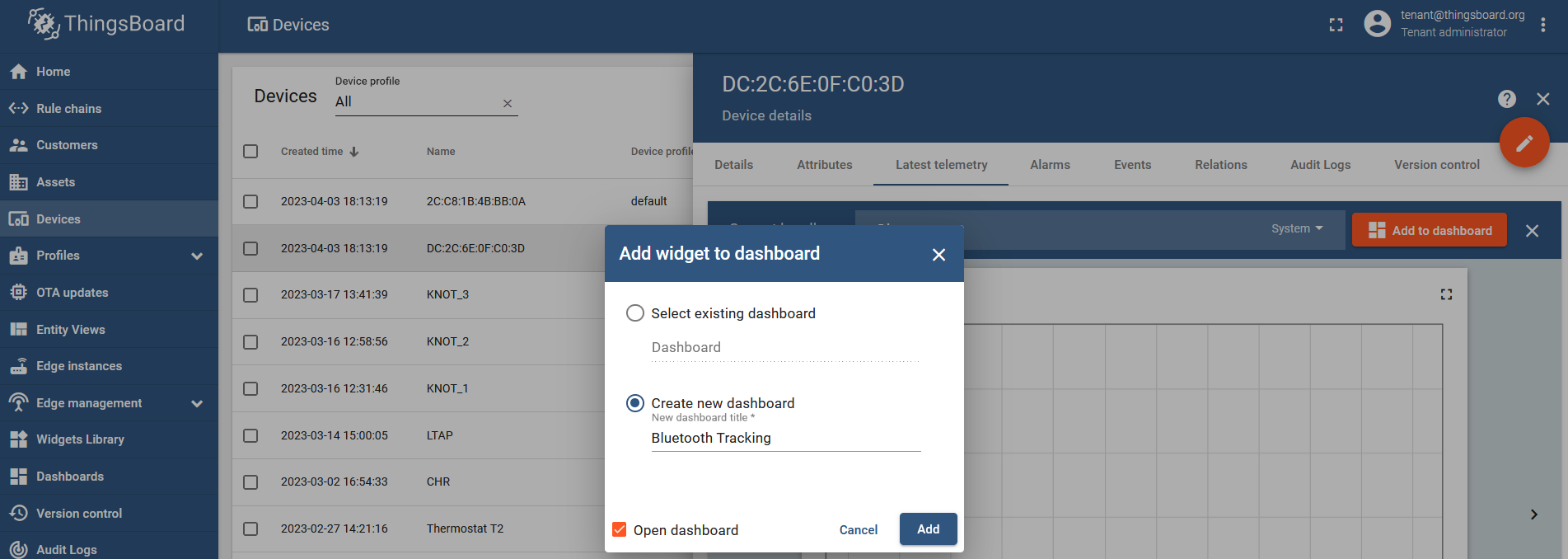

Create a new dashboard and name it however you like. Click on "Add":

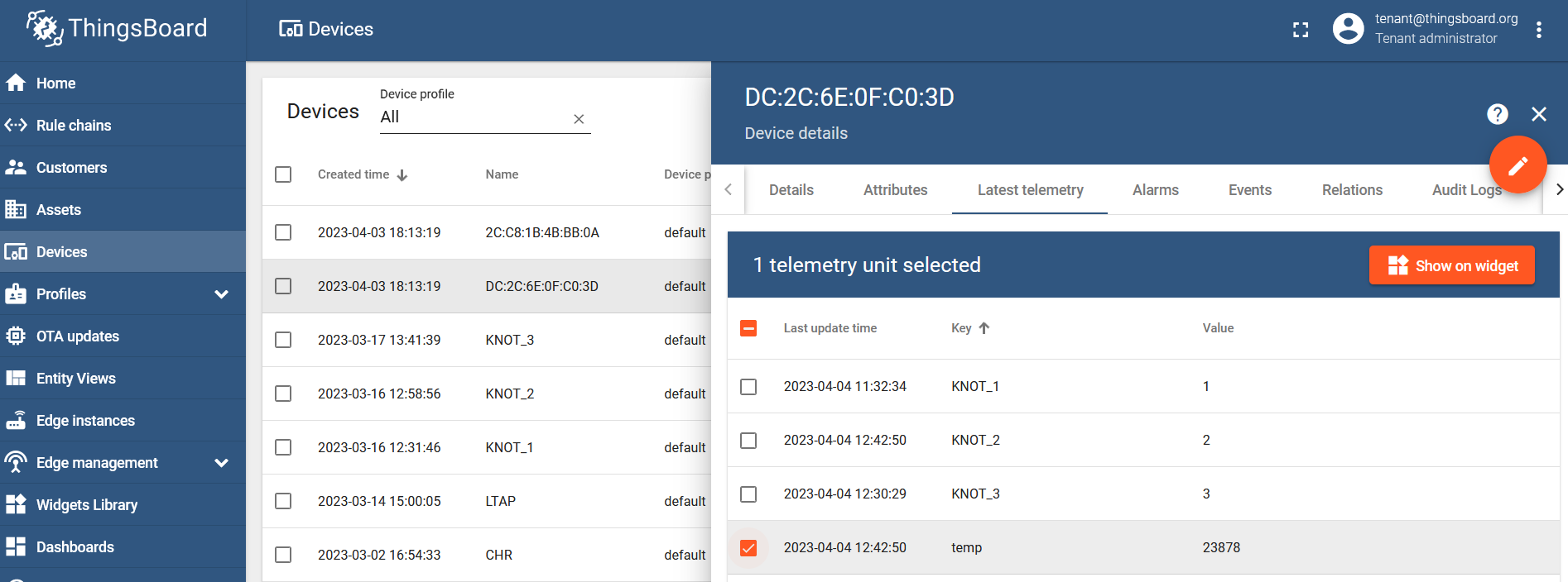

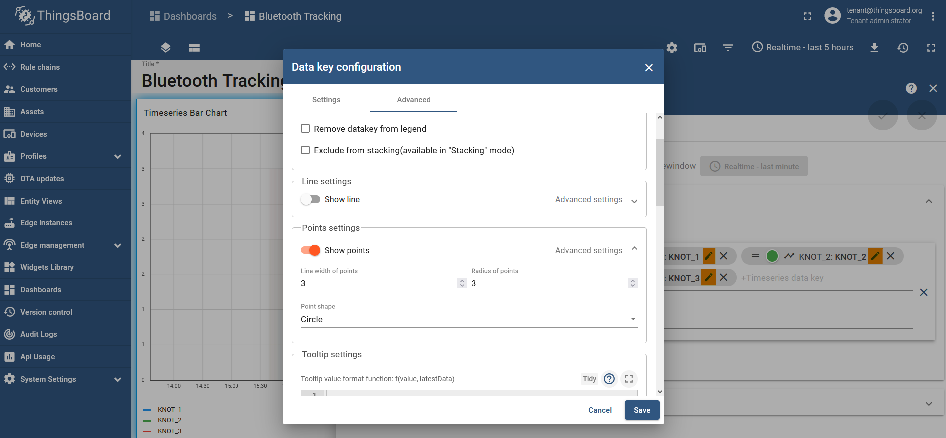

Do the same steps for your other tags that appeared under the "Devices" tab. Create a new widget for each unique tag under the same dashboard.

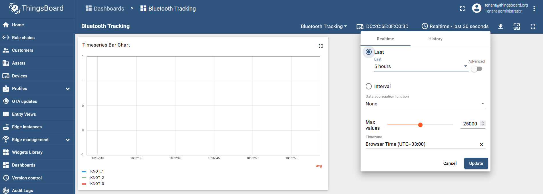

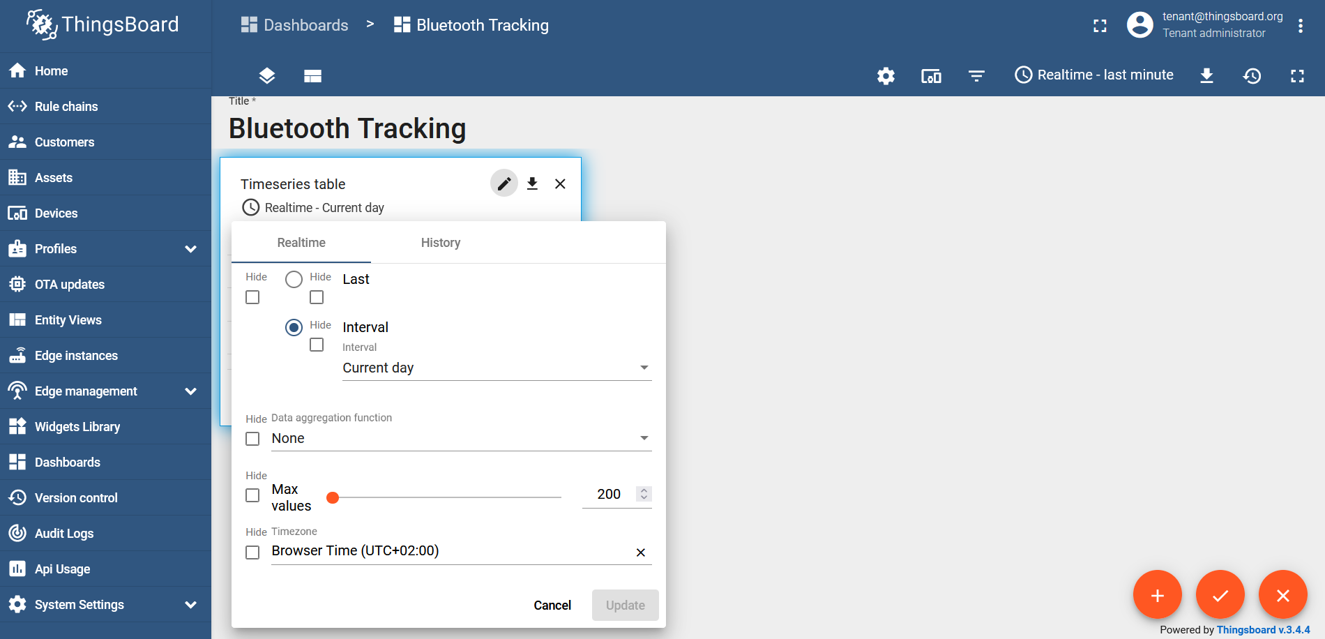

Change the widget's "Timewindow" from "Realtime-last minute" (which is used by default) to "Realtime-current day":

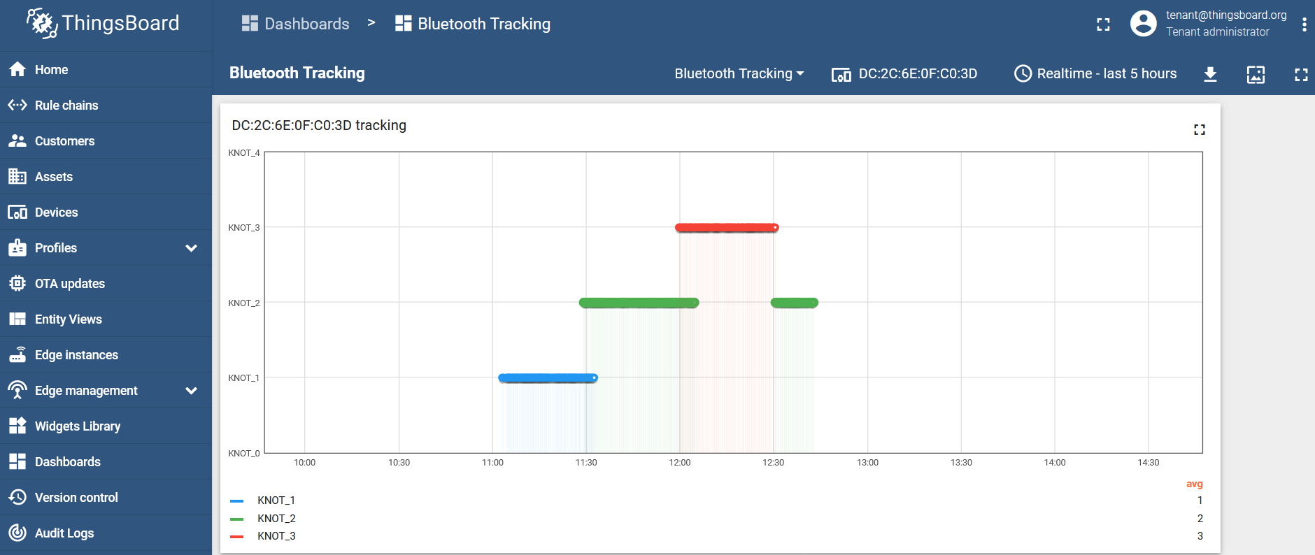

As a result, if both tags are inside the KNOT A range, the dashboard would show:
If they move to the KNOT B range, it would show:
If the tags move to the overlapped area, inside both ranges, both reporters (KNOT_A and KNOT_B) should show up within a few seconds of each other, depending on the interval used in the scheduler:

In the second example, we will showcase another topology:
We have a few warehouses, a few company delivery vehicles, and 3 assets that we are interested in tracking. Our assets are pallets that hold cargo and our goals are to know:

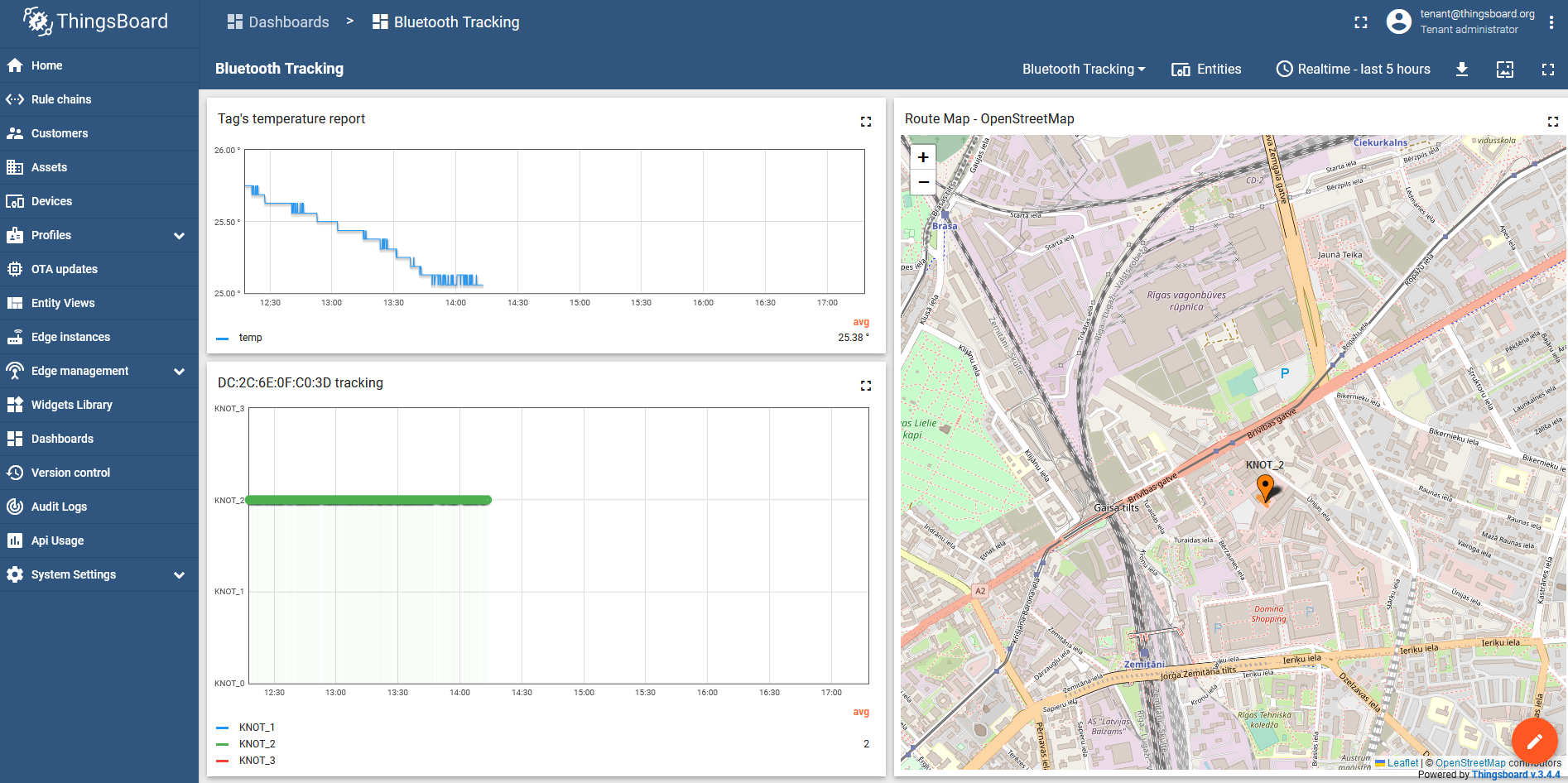

  • In which specific warehouse (equipped with the KNOT) the asset (equipped with the tag) is currently in and how much time it spent inside the specific warehouse.
  • Whether the asset (equipped with the tag) is on the road, traveling between warehouses, and how much time it spent inside the vehicle (equipped with the KNOT).
  • (Optionally) if TG-BT5-OUT tags are used, what the temperature was during all this time? You can also/instead monitor other parameters that you can get out of the advertised payload, like for example acceleration.

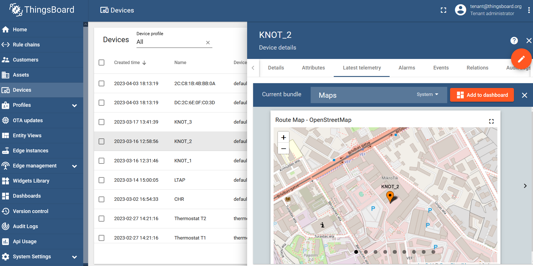

  • (optionally) Find out the KNOT's GPS location.
To achieve Bluetooth asset-tracking, just install x1 KNOT per warehouse, x1 KNOT per vehicle, and x1 tag per asset.
We can see that TAG 1 is inside the vehicle, and this vehicle just parked near the warehouse. Both KNOT 1 and KNOT 4 will report to the server that the asset is inside their ranges. This will tell you that the asset is parked but not being transported yet.
We can see that TAG 2 is traveling between the warehouses and is only inside the KNOT 5 Bluetooth range. In this case, KNOT 5 will be the only reporter and the result that is displayed on the server would mean that the asset is getting transported.
We can see that TAG 3 is inside the warehouse. The server will indicate just that.
The data on the server will show the timestamps of each report sent by the KNOT, which will tell you for how long the asset stayed inside the specific device's Bluetooth range.

Create 3 KNOTs under the ThingsBoard GUI and make them "gateways".
Name the device and checkbox the "Is gateway" option:
After you run the script with /system/script/run tracking or via a scheduler and refresh the GUI portal → all MAC addresses (tags) that are found in the JSON message will be made into new devices under the ThingsBoard GUI:
To help you visualize the data, you can use the built-in widgets or create your own one.
Select the tag's MAC address from the list of devices, go to the "Latest telemetry" section, select KNOT IDs that you wish to monitor, and click on the "Show on widget" button:
Select a widget that you wish to use, for example, under the "Charts" bundle, "Timeseries Bar Chart" and click on "Add to dashboard":
Change the widget's "Timewindow" from "Realtime-last minute" (which is used by default) to "Realtime-last 5 hours" and disable "data aggregation function" (select "none"):
To help you better visualize the result, edit the widget and then edit each "KNOT_X" parameter/key. Enable the "Show points" checkbox for each key:
Check the ThingsBoard widget guide for more options that you have.
The end result would look like this:
Per the dashboard, we can tell that:
  • From ~11:00 to ~11:30, our asset was inside KNOT_1 Bluetooth range (inside warehouse #1).
  • From ~11:30 to ~11:35, our asset was relocated to the vehicle (KNOT_2) that was parked near the warehouse (the tag was inside both KNOTs' ranges).
  • From ~11:35 to ~12:00, the tag was inside the truck (KNOT_2) - traveling to another warehouse.
  • From ~12:00 to ~12:05, the asset was parked outside of warehouse #2, and it was inside both KNOT_2 and KNOT_3 ranges at the same time.
  • From ~12:05 to 12:30, our asset was stored inside warehouse #2 (KNOT_3).
  • From ~12:30 onwards, the tag was on the road again, inside the truck (KNOT_2).

Select the tag's MAC address from the list of devices, go to the "Latest telemetry" section, check the temp parameter, and click on the "Show on widget" button:
Select a widget that you wish to use, for example under the "Charts" bundle, "Timeseries Line Chart". Click on "Add to dashboard", and choose the dashboard where you want to add the widget.
The result would look like this:
Now you have an additional graph that indicates how the tag's temperature changes during different time intervals.
GPS coordinate visualization (optional)​
Per the script in the Script that includes GPS data section, the script sends x2 MQTT messages. Each message is sent to a different MQTT topic. The GPS coordinate message will be posted to a topic named "v1/devices/me/telemetry", while Bluetooth data will be posted to a topic named "v1/gateway/telemetry". Coordinates will be available to you under the ThingsBoard device list, under the specific gateway:
Check both "latitude" and "longitude" parameters, click on the "Show on widget button", set "Current bundle" to "Maps", and choose the "Route Map - OpenStreetMap" widget:
To finish things up, click on the "Add to dashboard" button and choose the dashboard where you want the widget to be shown.
After adding 3 widgets into 1 dashboard (temperature line chart, Bluetooth reporter bar chart, and GPS coordinates map), you would get something similar to this:
  • You will have a graph showing temperature changes (the tag's surrounding temperature).
  • You will have a chart that indicates which specific KNOT has sent the report that tells you in which KNOT's Bluetooth range the tag is currently in.
  • You will have a map that shows the GPS position of the KNOT.
