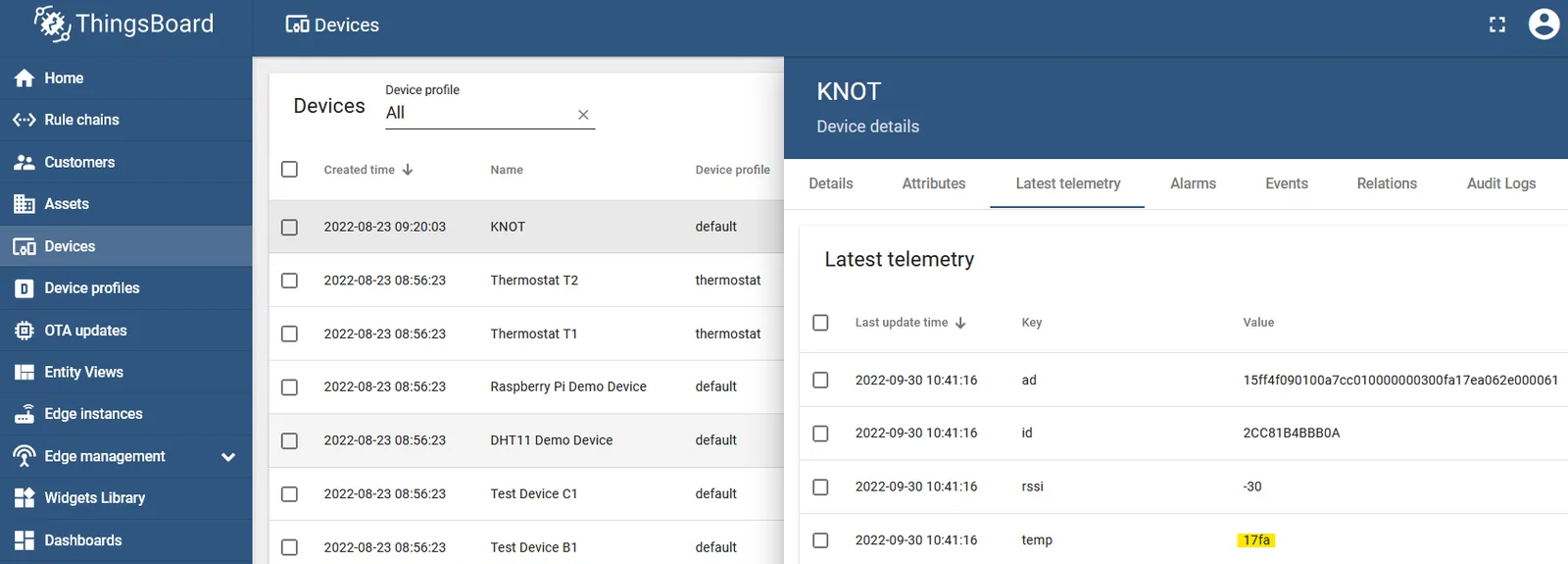

Results

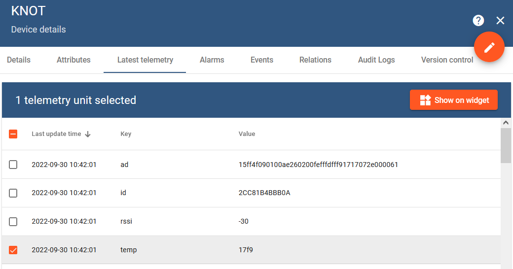

You will be able to verify the results under the Latest telemetry section under the device you have created for ThingsBoard (in our example, we called the "device" KNOT):
The result is a successful MQTT post! From the screenshot above, we can see that the temp parameter is in hexadecimal format.
But! we would like to display the temperature (temp parameter) in decimal format and we would also like to display the data easier to perceive.
And in case, we have posted the temperature in the decimal format, we would like to set up a decimal point.

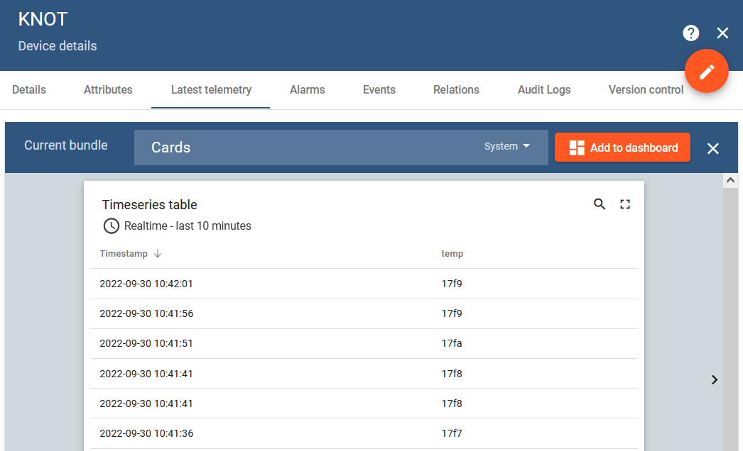

After you receive the value under the Latest telemetry section, you can show it on the Widget.
The Javascripts used in the widgets should be able to convert the data from the hexadecimal format to the decimal format.
Select the value you wish to display in the widget (in our example, temp) and click on the "Show on widget" button:
You will be able to browse the widgets in the window that pops up:

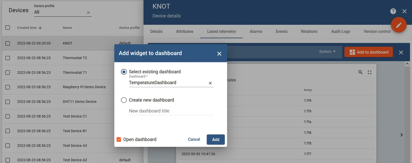

Click on the "Add to dashboard" button:
Select a new dashboard to be created or choose an existing dashboard that you already have pre-installed/pre-made. Click on "Add".
By applying the checkbox "Open dashboard" you will be redirected to the dashboard menu or you can go there manually.

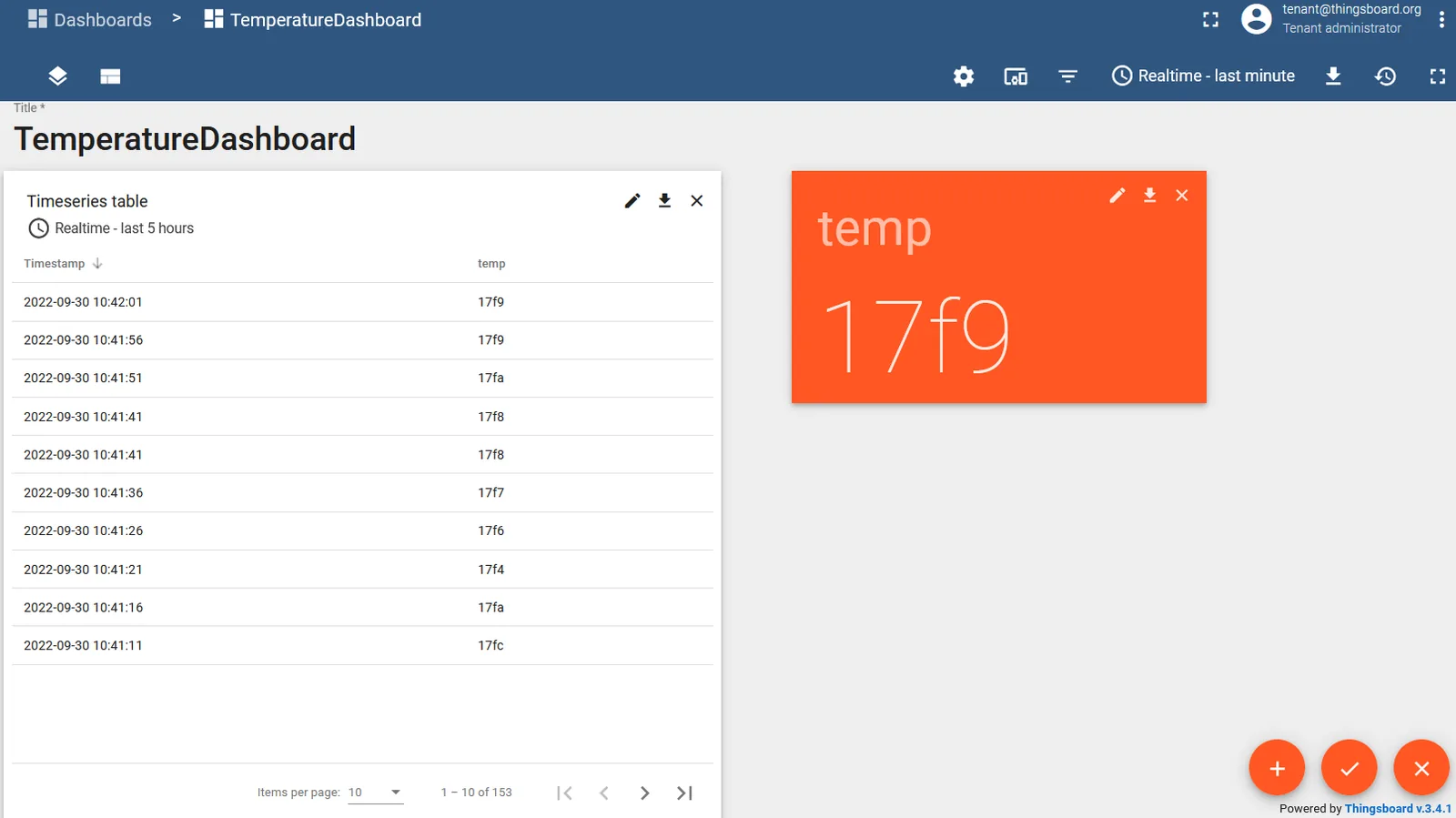

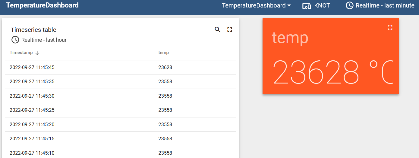

We have also added a second table and, as a result, our test dashboard looks like this:
In case we post the date in hexadecimal format
Both tables will display the value in the hexadecimal format as "17f9" (raw value as we've sent it from the KNOT → the javascript for the table did not convert it to a decimal value yet).

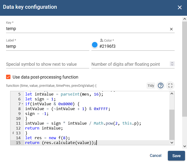

Because of the fact that the values in our tag's payload are in signed 8.8 fixed point format (keeping in mind the twos-complement format), we will need to add additional javascript code to "convert" the data to the decimal value.

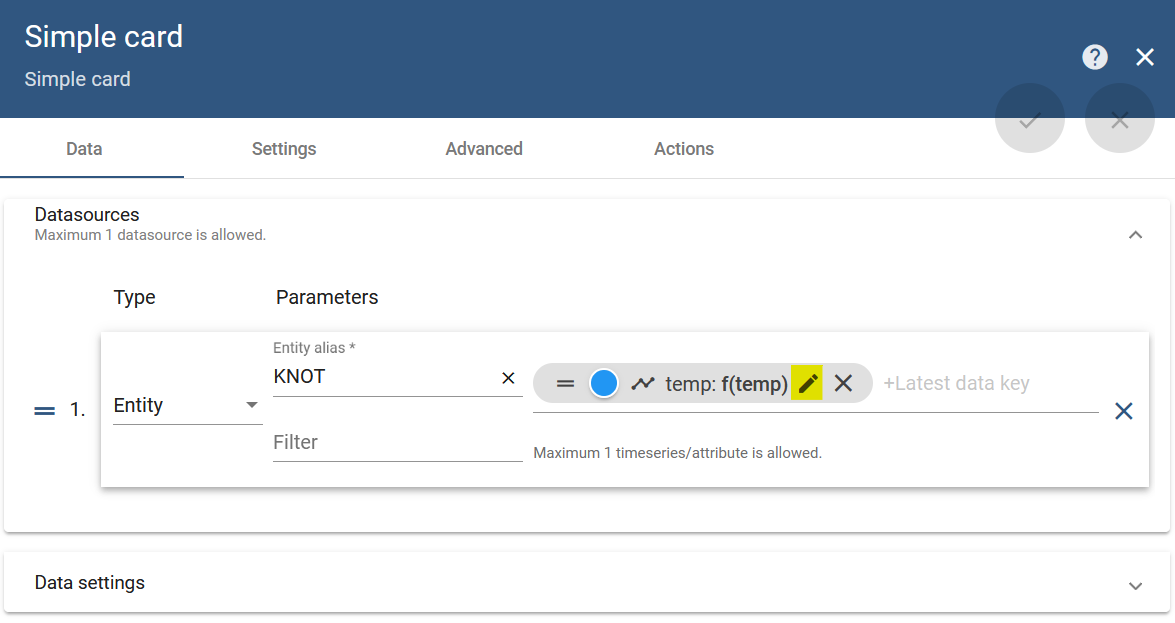

Enter the "Edit" mode and click on the "Edit widget" button:
Click on the "edit" button to edit the parameter temp:
In the popup window "Data key configuration" enable the checkbox "Use data post-processing function" and input the code shown below:
The code:
function f(p){
this.p = p;
f.prototype.calculate = function(mes){
let intValue = parseInt(mes, 16);
let sign = 1;
if(intValue & 0x8000) {
intValue = (~intValue + 1) & 0xFFFF;
sign = -1;
intValue = sign * intValue / Math.pow(2, this.p);
return intValue;
let res = new f(8);
return (res.calculate(value));
Save and apply the changes.
Do the same steps for the second/first table.

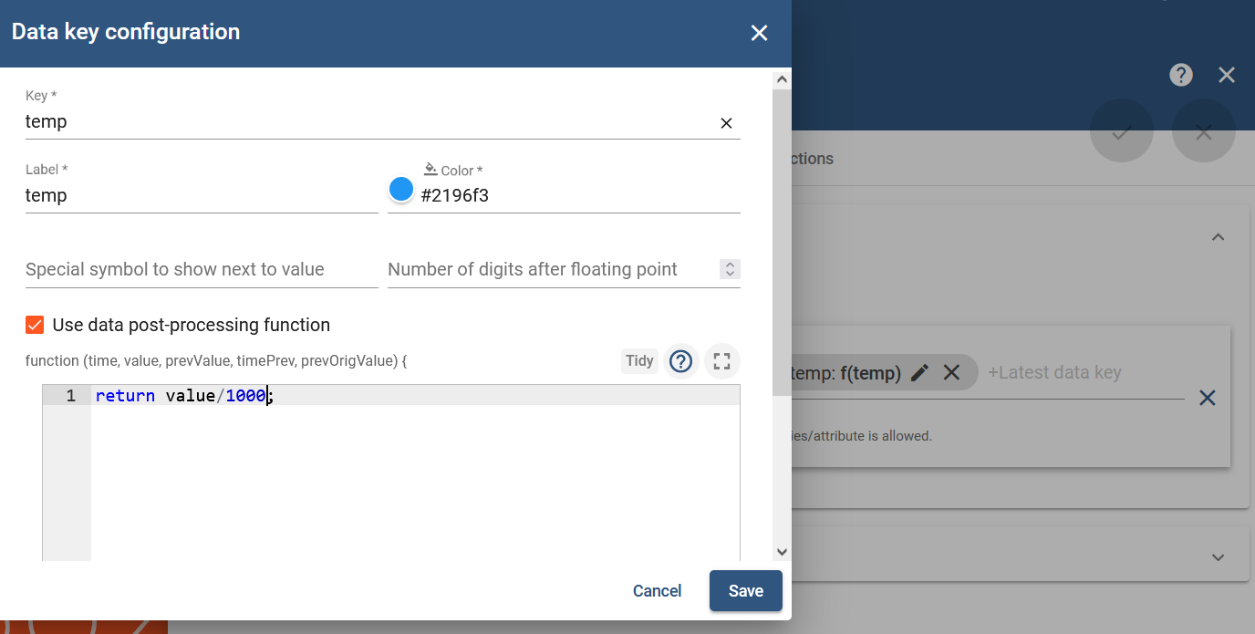

In case we post the date in decimal format
You will see the results as:
Do the exact same steps from the example above, but for this scenario, divide the result by "1000":

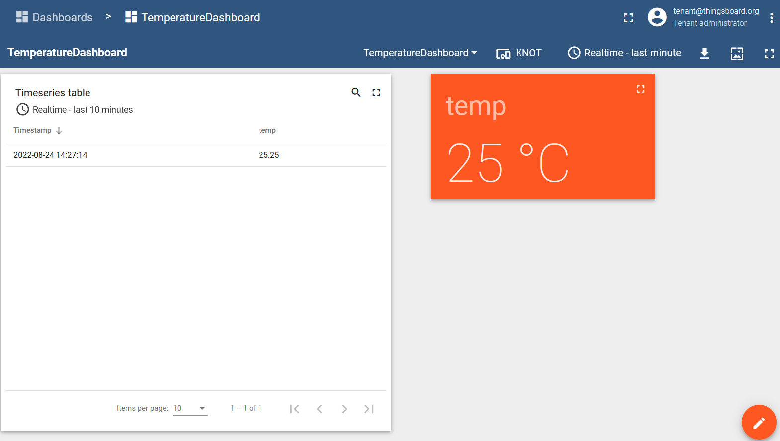

Verification
The end result should look like this:
Now both tables show decimal temperature.
