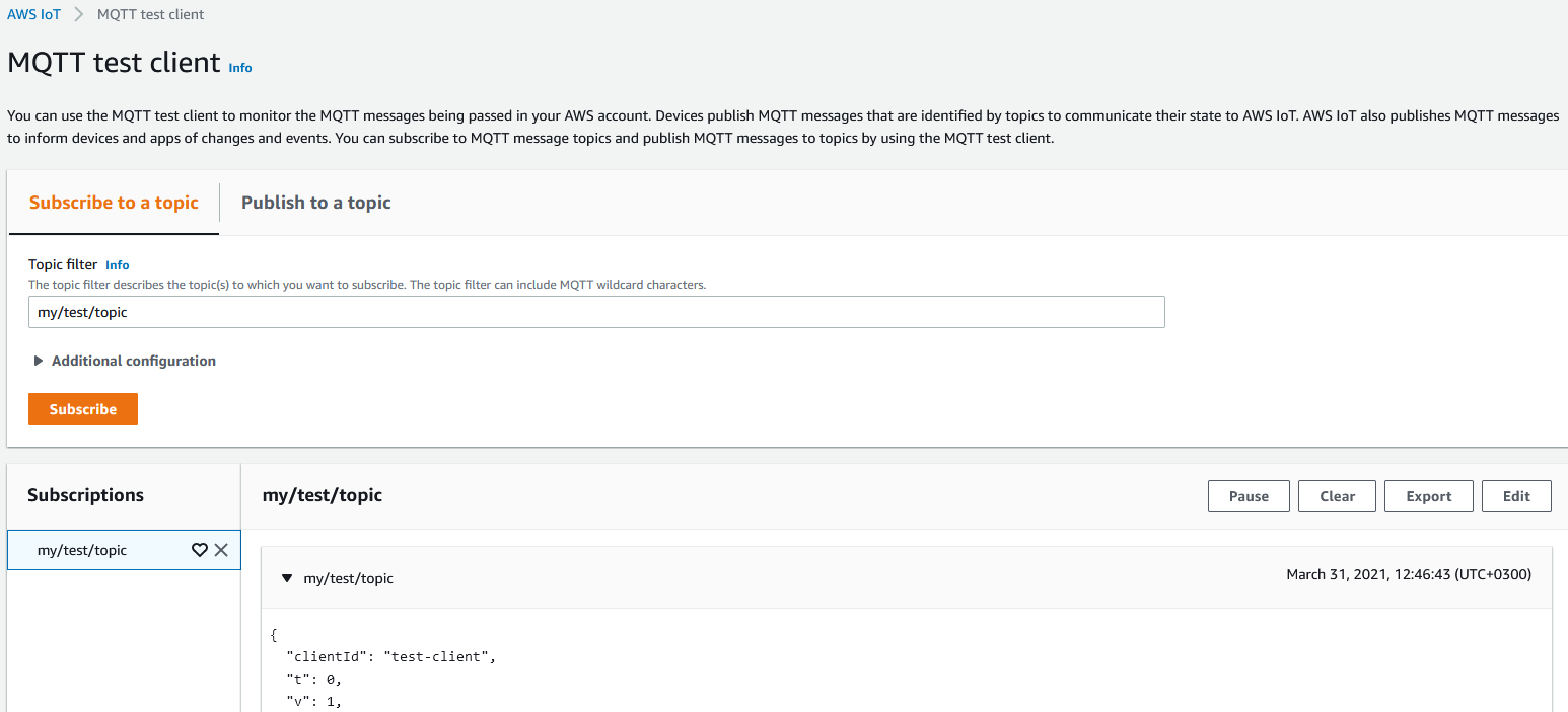

In the Test section, you can use a build-in MQTT test client so you can test publishing and subscribe to topics. You have Subscribe to a topic and Publish to a topic tabs which allows you to check both processes. MQTT test client section can also display HTTPS posts.

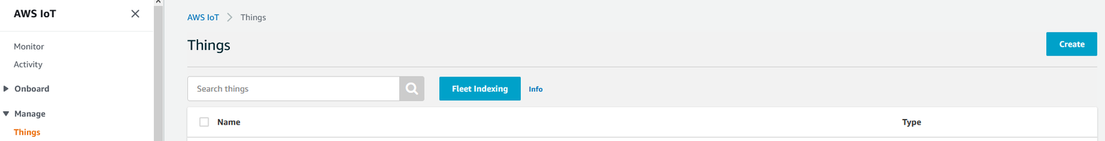

Things
Step 1: Navigate to Manage>Things. This is the menu where configuration begins (Things menu is the representation of a device or logical entity).
Press Create>Create a single thing>choose a name>Next>Create certificate.

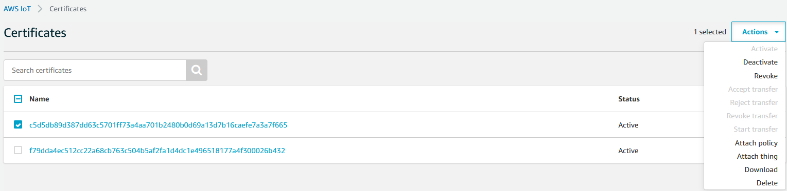

Certificates
In the Certificates menu, you can create certificates, activate them and attach them to policies. The "Things" configuration should have already created the certificate. Just make sure that the certificate is "activated". To do that, select the certificate, click on "Actions" and click "Activate".

Step 5: You need to attach the certificate to the newly created policy. In order to do that, go to Secure>Certificates, select the certificate, click on "Actions" and "Attach policy".
Select the policy and click "Attach".

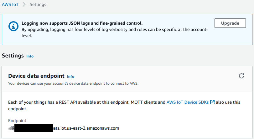

Endpoint Address (Broker's address)
You can find the Endpoint address in the "Settings" section (Settings>Device data endpoint). This address should be configured as the broker's IP/FQDN address in the RouterOS settings.

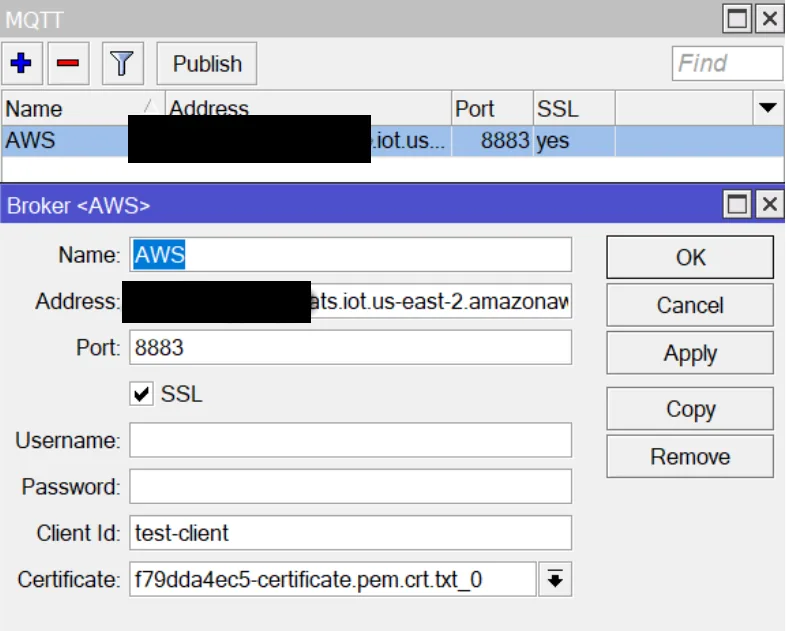

MQTT Broker
Navigate to IoT>MQTT and add a new broker ("+" button).
Name the broker in the "Name" field (for example, AWS).
Type in/paste AWS address into the "Address" field (you can find it in the AWS settings "Settings>Device data endpoint" - Endpoint address).
Configure the port used by the broker in the "Port" field and enable SSL via SSL checkbox (AWS, in this case, uses 8883 and, since we use certificates, it requires to enable SSL).
"Username" and "Password" fields are not required in this scenario (depends on the broker's configuration - skip both fields).
Set up a client-id in the "Client Id" field (it is the ID that was configured in the AWS policies - in this example, test-client).
Since SSL is used, the certificate must be selected in the "Certificate" field (select xxxx.certificate.pem.crt).
Click on "Apply" and "OK" to finish setting up the broker.

Verification
To verify that AWS gets the data, go back to the AWS portal. Navigate to the Test page. Use Subscribe to a topic option. Type in the topic that was configured in the AWS policies (in our example, my/test/topic) in the Topic filter field and press Subscribe. Below, you should see the Subscriptions section where the data is going to be shown. Run the script (in RouterOS) and you should see the collected data in the "Subscriptions" tab.
The same page/tab should display HTTPS posted packets as well.
