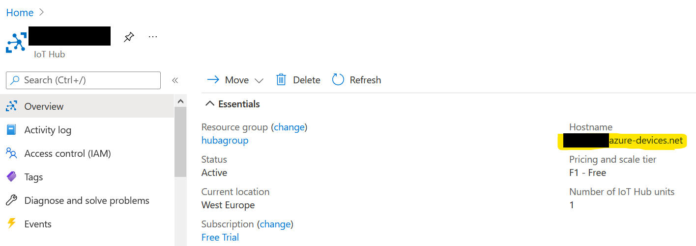

IoT Hub
Navigate to All services>IoT Hub and create one.
Link your IoT Hub to the previously created resource group. Do not forget to check/set up "Networking" (Network connectivity) and Management (a subscription tier) tabs.
You can find more information over here.

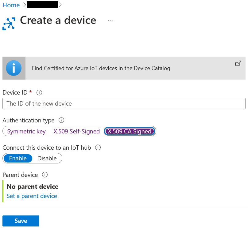

Devices
Navigate to your IoT Hub>IoT Devices and add a new device:
Pay attention to the "Device ID" field. The Device ID should match the "Common name" for the device certificate.
Chose Authentication type=X.509 CA Signed and save the setting.
You can now generate the last required certificate - the device certificate (or follow this link if you are using open ssl).
With this, the Azure part of the configuration is complete.

  • Type in/paste Azure hostname address into the "Address" field (you can find the hostname in the IoT Hub>Overview menu):

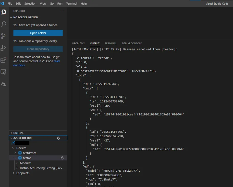

Verification
There are many different ways to view the received/published message on the Azure portal. Please check Azure tutorials on the options you have.
In our example, we will verify the results using the Visual Studio Code program.
Download the program and connect it to your IoT Hub.
Once the IoT Hub is added, you can start monitoring the endpoint:
And you can view published messages in the "OUTPUT" section as shown in the screenshot below:
