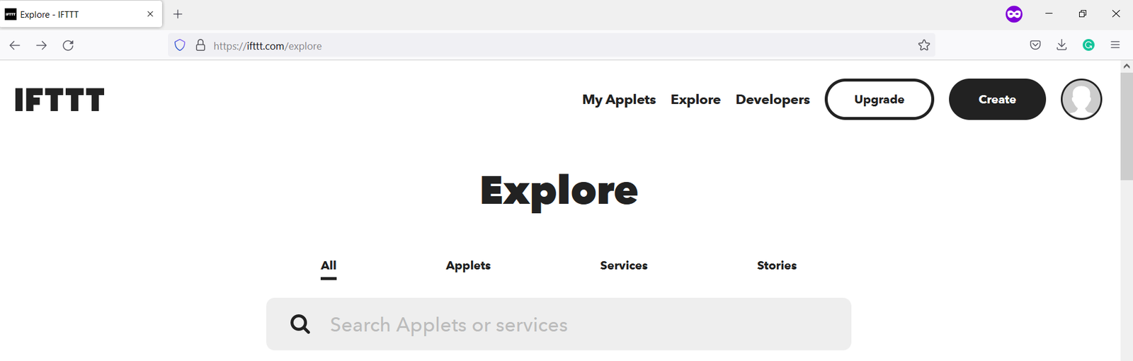

The first step is to register an IFTTT account or log in to an existing one following the link.
Download the IFTTT app for your phone and you can configure the follow-up steps either through the APP or through the browser.
After you are logged in, press the "Create" button in the right upper corner:

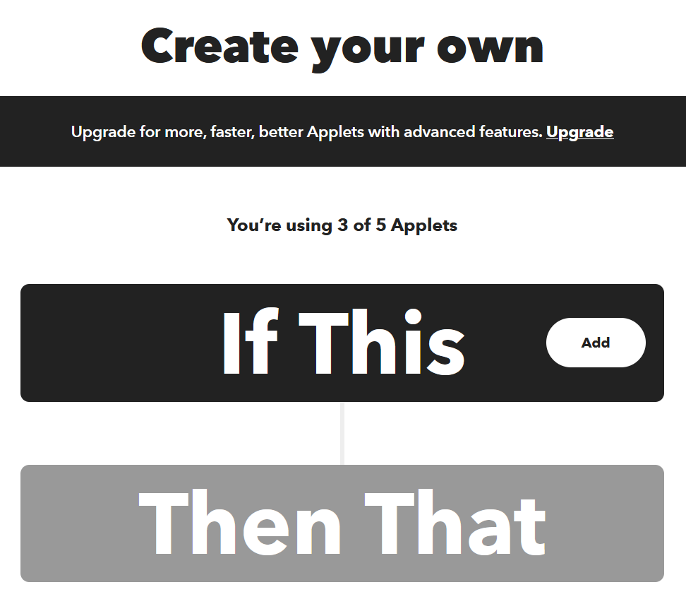

This will take you to the applet creation screen:
Select the "Add" button in the "If This" field. Choose a service called "Webhooks". Then, select an option called "Receive a web request".
Enter an "Event Name", for example, **{The_tag_IS_within_range}** and select "Create trigger". This will take you back to:

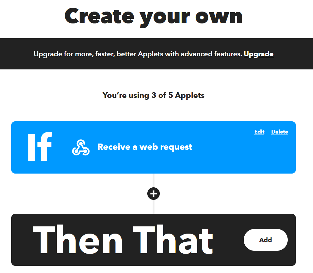

Select the "Add" button in the "Then That" field and find an action called "Notifications". Choose an option called "Send a notification from the IFTTT app" and confirm the decision by clicking on "Create Action".
Click on "Continue" and review the applet. Click on "Finish".
Now, do the same steps again to create a second applet, but for the second one, enter another "Event Name", for example, **{The_tag_is_NOT_in_range}**.

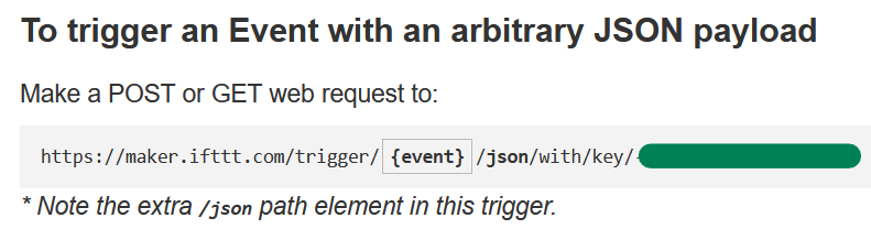

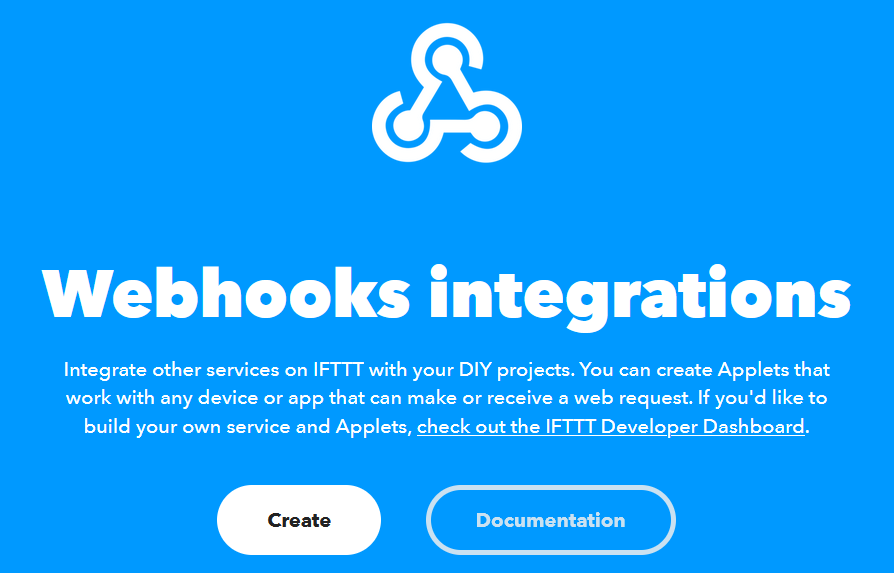

Once you have two applets created → check the web request URL that was generated for you. Go to the link and click on the "Documentation" button:
The page will indicate the URL that you need to use:
Copy this URL - you will need to use it in the script later.

:local urlNotInRange "https://maker.ifttt.com/trigger/{The_tag_is_NOT_in_range}/json/with/key/-xxxx"
the line, where you need to input the URL that was generated for you by the IFTTT service. The URL should look like this → https://maker.ifttt.com/trigger/{event}/json/with/key/-xxxxx. Change the {event} part of the URL to the Event Name that was chosen in the IFTTT portal when creating an applet and change the -xxxxx part of the URL to the key that was generated for you by the IFTTT portal.
  1. In range notification URL line:
:local urlInRange "https://maker.ifttt.com/trigger/{The_tag_IS_within_range}/json/with/key/-xxxx"
the line, where you need to input the URL that was generated for you by the IFTTT service. The URL should look like this → https://maker.ifttt.com/trigger/{event}/json/with/key/-xxxxx. Change the {event} part of the URL to the second Event Name that was chosen in the IFTTT portal when creating your second applet and change the -xxxxx part of the URL to the key that was generated for you by the IFTTT portal.

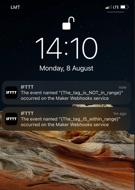

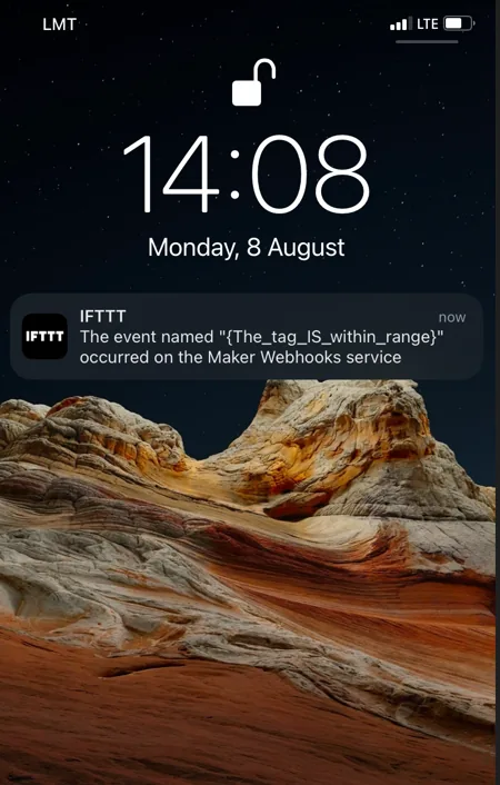

Result verification
Make sure you are logged into the IFTTT app on your phone.
Position the tag within the KNOTs Bluetooth range and you should get a notification once the scheduler runs the script, like so:
Move the tag outside of KNOTs range (wait for 1 minute) and you will get another notification:
