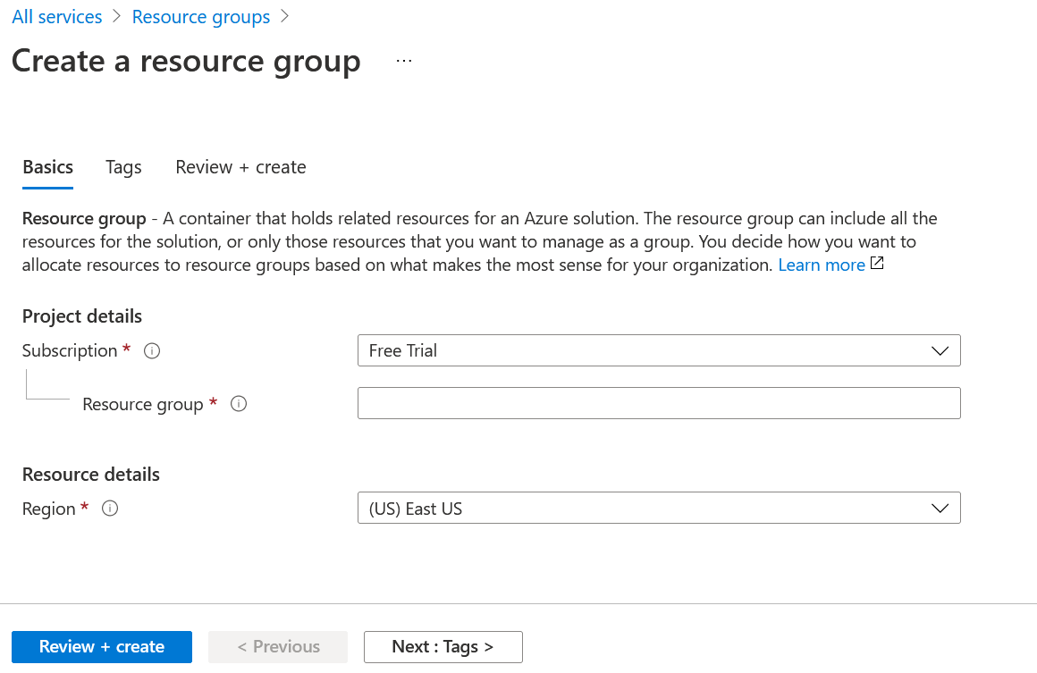

Resource Group
Go to All Services>Resource groups and create one.
You can find a more detailed guide following the link.

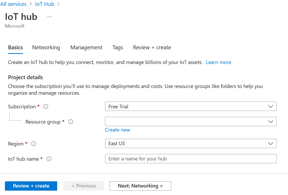

After successfully configuring a resource group, you will need to create an IoT hub.
IoT Hub
Navigate to All services>IoT Hub and create one.
Link your IoT Hub to the previously created resource group. Do not forget to check/set up "Networking" (Network connectivity) and Management (a subscription tier) tabs.
You can find more information over here.

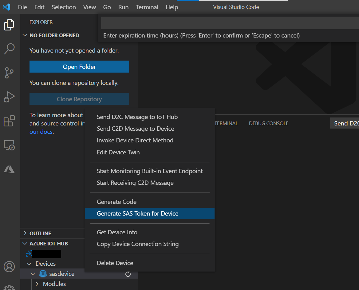

SAS Token
In our example, we will be using the Visual Studio Code program to generate the SAS token.
Simply, download the program and connect it to your IoT Hub.
When it is done and the previously configured device name shows up in your IoT HUB - right-click on the device name and generate the token as shown in the screenshot below:
You will be asked to enter the expiration time (in hours) for the token and to press "enter" to confirm the setting.

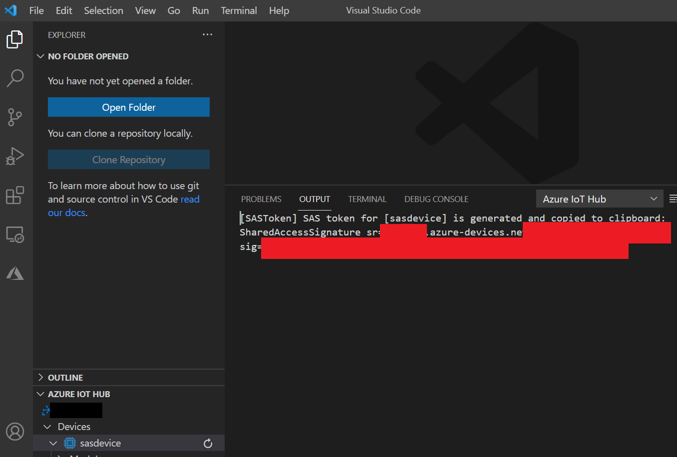

After this step, the token should be generated in the "OUTPUT" field:
Copy the token, as it is going to be used later in our HTTPS post script.
With this, the Azure part of the configuration is complete.

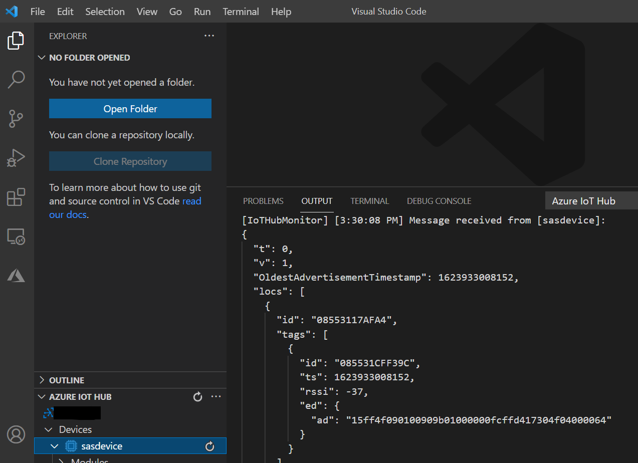

There are many different ways to view the received/published message on the Azure portal. Please check Azure tutorials on the options you have.

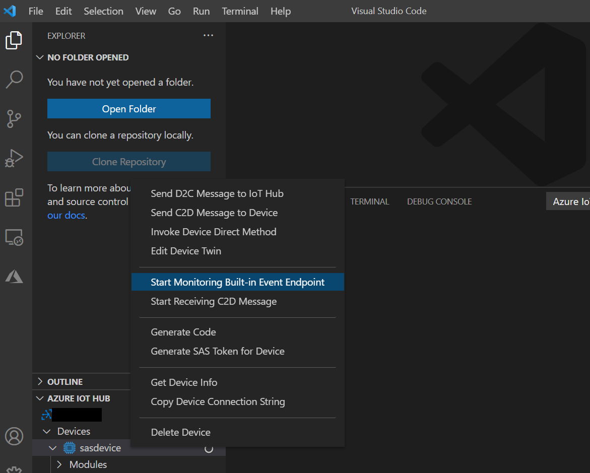

We will be using the Visual Studio Code program to verify the results.
Open your IoT Hub and start monitoring the endpoint (the device):
You can view published messages in the "OUTPUT" section as shown in the screenshot below. Just run the script and check the received message:
