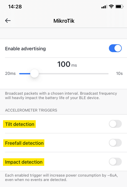

For iOS, the trigger setting looks like this (in a disabled state/default settings):

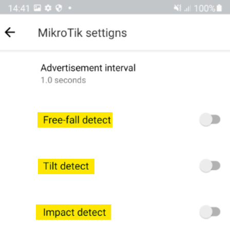

For Android, the trigger setting looks like this (in a disabled state/default settings):
To active trigger detection, just enable the corresponding "checkbox".

TG-BT5 tag configuration
In this specific example, we need to set up our tags to work in the MikroTik format. In the MikroTik format, the 21st octet of each payload will indicate the reason it was triggered.
You can find a manual on how to enable the triggers by following the iOS and/or Android guides ("Advertisement"/Beacon settings sections).
To easier "activate" the trigger, we can also alter the trigger's settings as per the iOS and/or Android guides (Free Fall Threshold and Duration sections). For the purpose of the test and to, basically, just "trigger" the detection much faster, we can change the "Free Fall Duration" parameter to "0" seconds (this will make sure that any acceleration that is within the threshold on all axis will be instantly detected as a "freefalling" event).

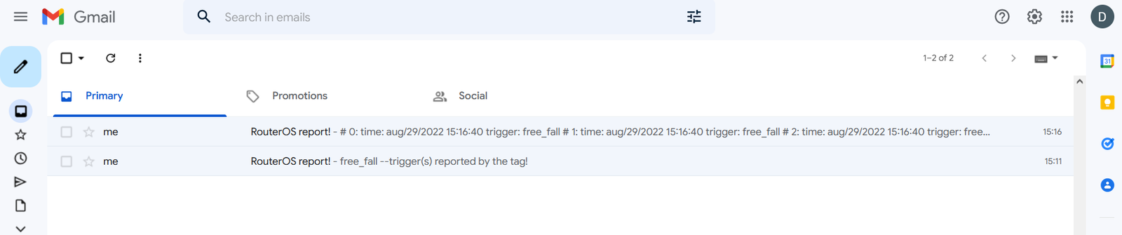

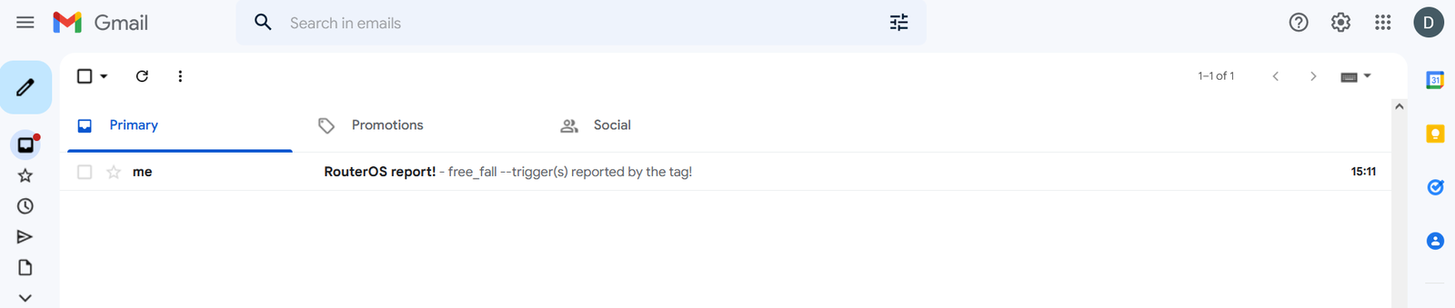

You can run the script manually via the command "/system script run triggernotification" or by clicking on the "Run Script" button under the Script List section.
You should make sure that the e-mail notification was received after manually initiating the script.
When script (a) is initiated, RouterOS is going to check every received/stored Bluetooth payload, and if any trigger is found in the payload's list → an e-mail message is structured and sent. This e-mail message will simply indicate which triggers were detected in the list with no additional information.

Result verification
  1. Confirm that the tag broadcasts advertising reports and that the tag's triggers get detected:
  1. Confirm that your email server is set up correctly and that you are able to send emails from the KNOT (RouterOS).
  2. After you manually run the script or apply a scheduler to the script, an email notification should go through, like so:
