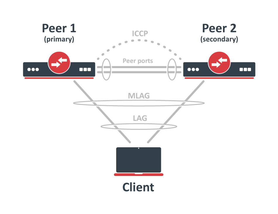

Both peers establish the MLAG interfaces and update the bridge host table over mlag-peer-port using ICCP (Inter Chassis Control Protocol). RouterOS ICCP does not require an IP configuration; it sends untagged Layer2 packets marked with EtherType 0x88B5 and a destination MAC address of 01:80:C2:00:00:0E. ICCP packets are link-local, meaning they are always received and handled by the MLAG devices themselves and never forwarded to other parts of the network. The peer-ports on each MLAG device must be directly connected to each other. It is also recommended to keep the untagged VLAN used by the peer ports separate from the rest of your network, either by assigning a dedicated untagged VLAN (using pvid), or by setting the peer port to only allow VLAN tagged frames (using frame-types=admit-only-vlan-tagged). Peer ports can be configured as single Ethernet interfaces or bonding interfaces. However, using a bonding interface is recommended, as it helps prevent a single interface failure from affecting connectivity, especially when both MLAG nodes are still up and running.
When mlag-peer-port is running and ICCP is established, the primary device election happens and the system-id will be selected. The peer with the lowest priority will act as the primary device. If the priorities are the same, the peer with the lowest bridge MAC address will become the primary. This system-id is used for STP BPDU bridge identifier and LACP system ID. MLAG supports STP, RSTP or MSTP protocols. Use the same STP priority and the same STP configuration on dual-connected bridge ports on both nodes. When MLAG bridges are elected as the STP root, then both devices will show as root bridges under the bridge monitor.

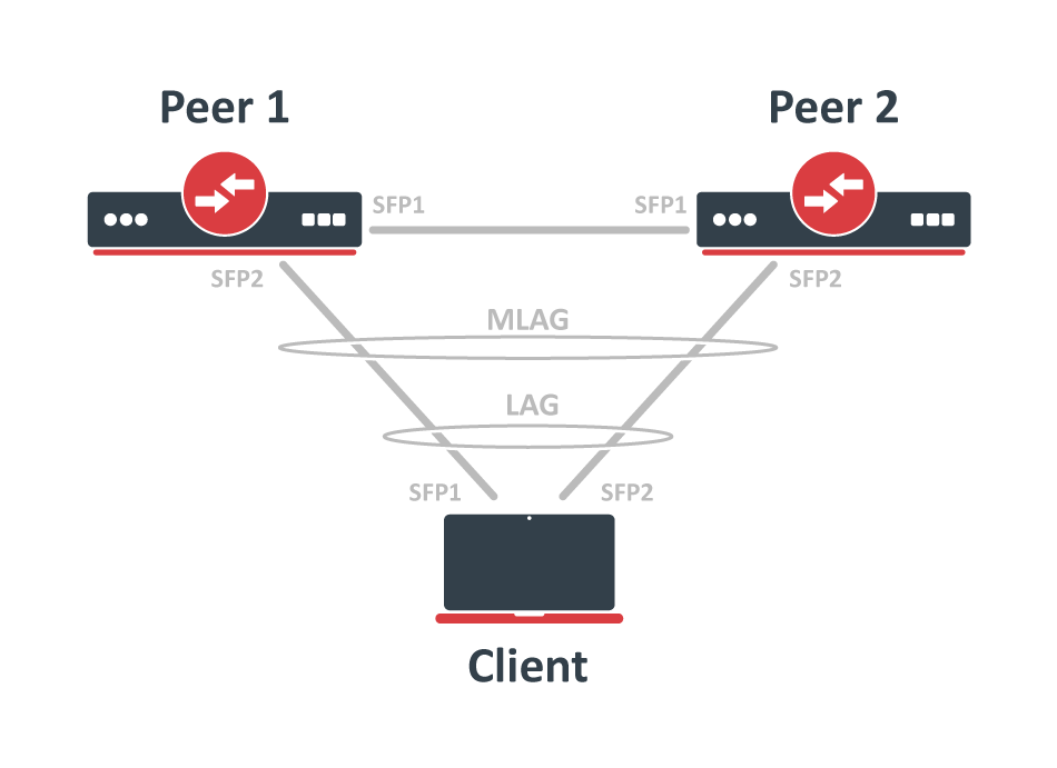

Quick setup
In this example, CRS317 and CRS309 devices are used as MLAG peers, and any device with two SFP+ interfaces can be used as an LACP client. The SFP+1 interface is used on both peer nodes to create mlag-peer-port, and it is used for ICCP, see a network scheme below.
Configure bonding interfaces for MLAG on Peer1 and Peer2 devices, use a matching mlag-id setting on both peer devices, and set the 1-second LACPDU transmission rate:
