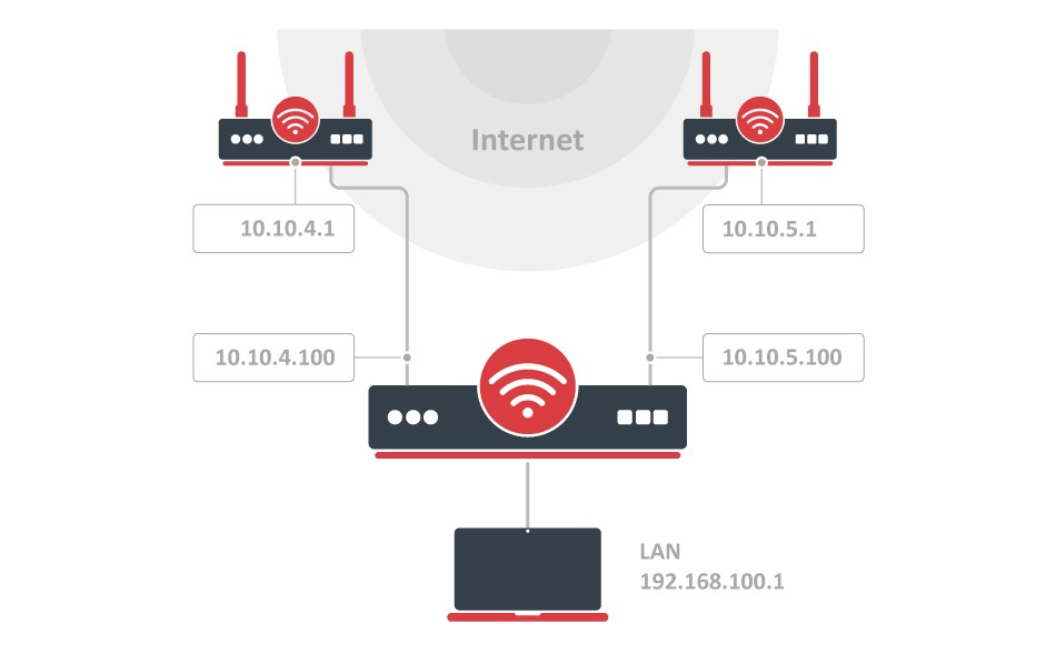

Configuration Example​
Let's assume this configuration:
IP Addresses​
/ip/address
add address=10.10.4.100/24 interface=ether_ISP1 network=10.10.4.0
add address=10.10.5.100/24 interface=ether_ISP2 network=10.10.5.0
add address=192.168.100.1/24 interface=ether_LAN network=192.168.100.0
The router has two upstream (ISP) interfaces with the addresses of 10.10.4.100/24 and 10.10.5.100/24. The LAN interface has an IP address of 192.168.100.1/24.
