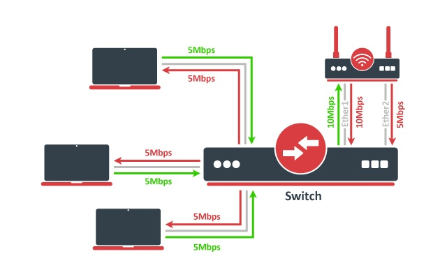

balance-tlb
This mode balances outgoing traffic per peer. Each bonded link can operate at different speeds and duplex settings, and unlike other bonding modes, no specific switch configuration is required. The limitation of this mode is that it supports only MII link monitoring—ARP monitoring is ignored when configured—and incoming traffic is not balanced. Incoming traffic will use the link designated as the "primary" interface.
Configuration example
Let's assume that the router has two links - ether1 max bandwidth is 10Mbps and ether2 max bandwidth is 5Mbps. The first link has more bandwidth, so we set it as a primary link:
/interface/bonding/add mode=balance-tlb slaves=ether1,ether2 primary=ether1
No additional configuration is required for the switch. The image above illustrates how balance-tlb mode works. As you can see the router can communicate to all the clients connected to the switch with a total bandwidth of both links (15Mbps). But as you already know, balance-tlb is not balancing incoming traffic. In our example, clients can communicate to the router with a total bandwidth of the primary link which is 10Mbps in our configuration.

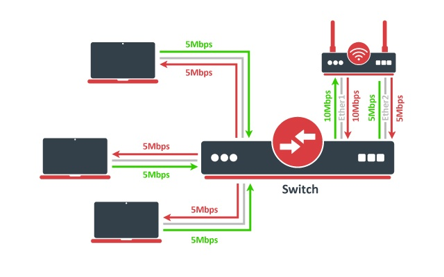

balance-alb
The mode is basically the same as balance-tlb but incoming IPv4 traffic is also balanced. The receive load balancing is achieved by ARP negotiation. The bonding driver intercepts locally generated ARP messages on their way out and overwrites the source hardware address with the unique address of one of the slaves in the bond such that different peers use different hardware addresses. Only MII link monitoring is supported (ARP link monitoring is ignored when configured). The additional downside of this mode is that it requires device driver capability to change MAC address. The mode is not compatible with the local-proxy-arp setting.
The image above illustrates how balance-alb mode works. Compared to balance-tlb mode, traffic from clients can also use the secondary link to communicate with the router.
