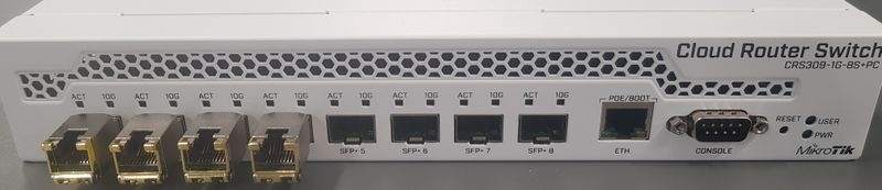

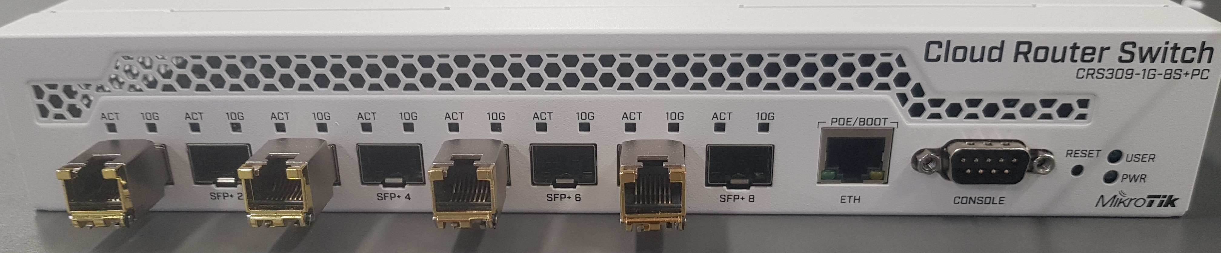

Even when using devices that come with separated SFP+ cages, for example, CRS309-1G-8S+, it is still not recommended to deploy the S+RJ10 transceivers beside each other. Use S+RJ10 in every second interface to avoid transceiver overheating, which may cause unpredictable behavior.

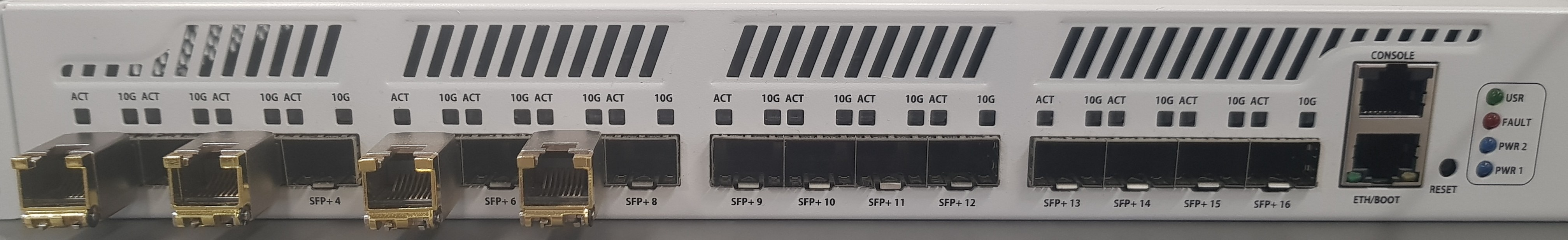

Recommended S+RJ10 placementIt is not recommended to place transceivers side by side

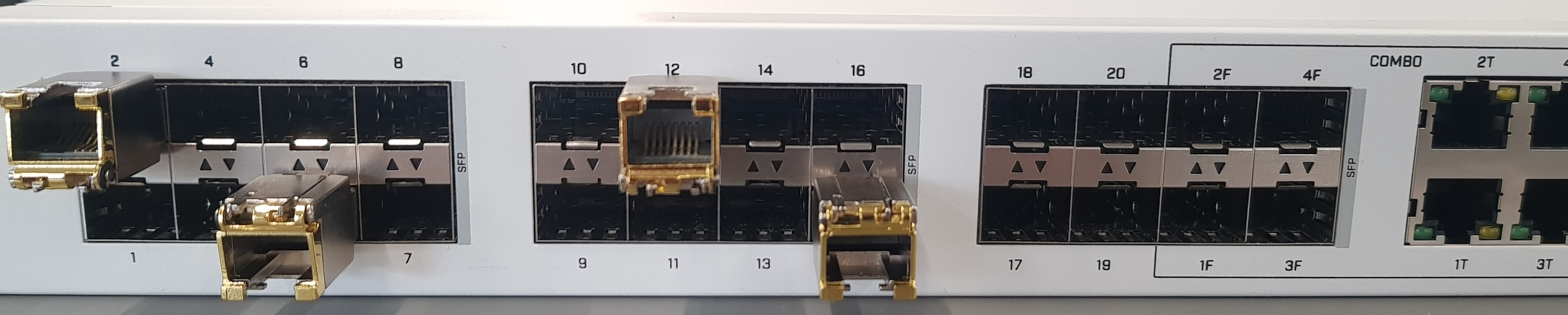

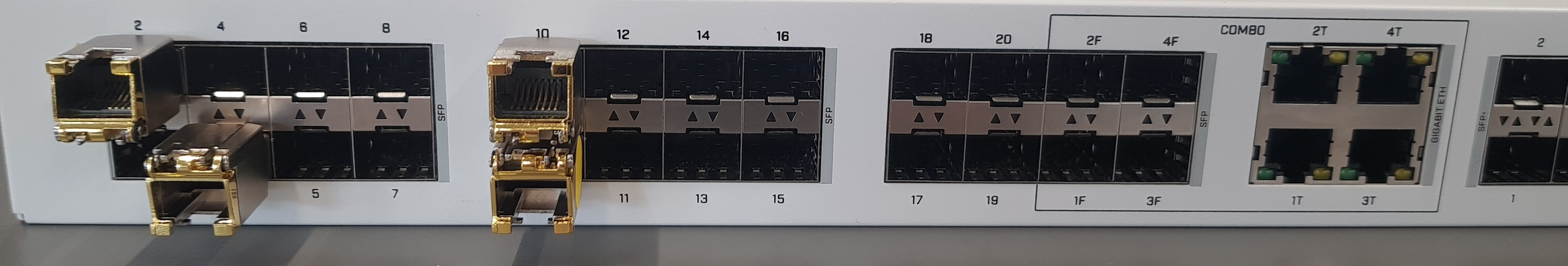

Devices that come with 4 or 8-block SFP+ cages are not exceptions. It is recommended to use one S+RJ10 transceiver per 4xSFP+ cage block and avoid placing them side by side. Keep at least one vertical row empty (without S+RJ10) after plugging the S+RJ10 transceiver.
Recommended S+RJ10 placementWe do not recommend placing transceivers side by side
