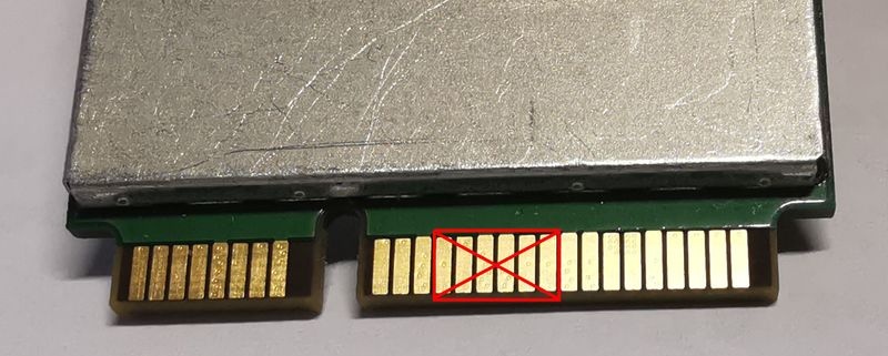

- For mini-PCIe modems with a USB3.0 interface installed in a mini-PCIe slot with PCIe/USB2.0 support, the USB speed must be limited to USB2.0, or the mini-PCIe shared PCIe/USB3.0 pin must be isolated. See the picture below the table.

| Telit LM940 | v6.44 | LTE interface in some cases needs 3.0 pins isolated (PINS:23,25,27,29,31,33) | MiniPCI-e | ||
| Telit LM960 | v6.46 | LTE interface in some cases needs 3.0 pins isolated (PINS:23,25,27,29,31,33) | MiniPCI-e | ||

For some modems with USB3.0 support in some cases USB3.0 pins need to be isolated to ensure correct initialization:
