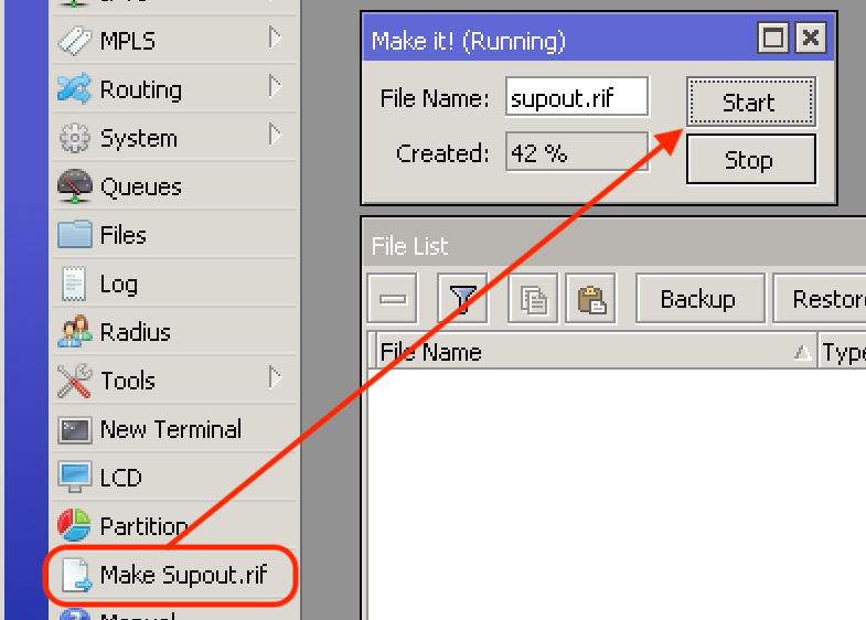

The screenshots show WinBox 3. Select Make Supout.rif in the main menu, then select Start in the window that opens. The window shows the file name and the progress in Created.
WinBox main menu with Make Supout.rif highlighted and the Make it! window with the file name supout.rif, the progress 42% and the Start button

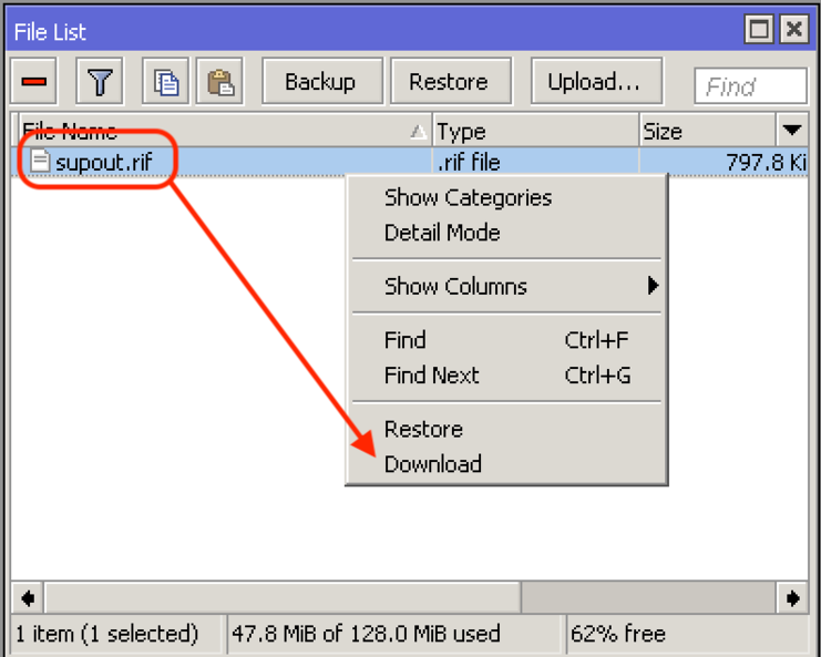

When the file is ready, it is listed in Files. Right-click it and select Download, or drag the file to your desktop. In WinBox 4, download it from Files (see Manage files in WinBox).
WinBox File List with supout.rif selected and Download highlighted in the right-click menu

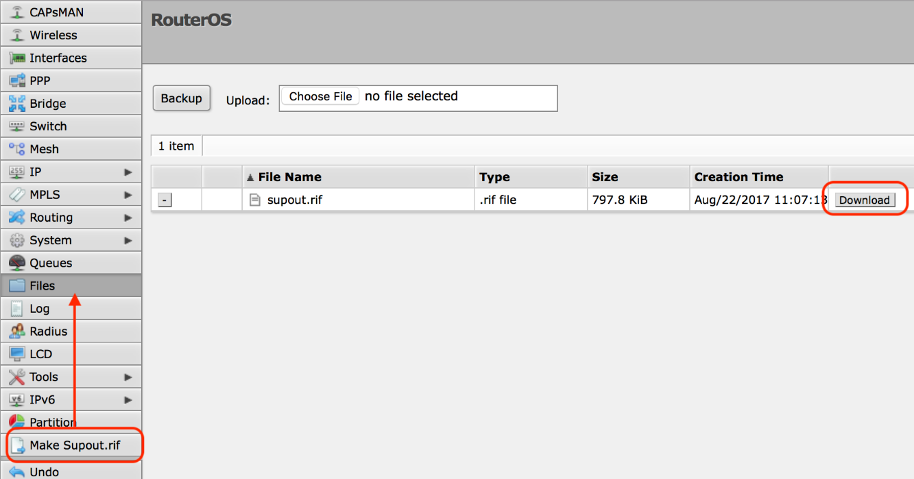

WebFig​
The screenshot shows an older WebFig. Select Make Supout.rif in the menu. Then open Files and select Download next to supout.rif.
WebFig Files page with Make Supout.rif highlighted in the menu and the Download button next to supout.rif
