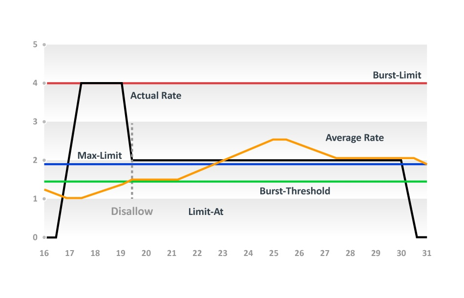

As we can see as soon as the client requested bandwidth it was able to get 4Mbps burst for 6 seconds. This is the longest possible burst with given values (longest-burst-time = burst-threshold * burst-time / burst-limit). As soon as the burst runs out, the rest of the data will be downloaded with 2Mbps. This way, a block of data was downloaded in 10 seconds - without burst, it would take 16 seconds. Burst has 7 seconds to recharge before the next download will start.
Note that burst is still disallowed when the download started and it kicks in only afterward - in the middle of a download. So with this example, we proved that a burst may happen in the middle of a download. The burst was ~4 seconds long and the second block was downloaded 4 seconds faster than without burst.
The average rate is calculated every 1/16 of burst time so in this case 1s.

6(0+0+0+0+0+0+0+0+0+0+4+4+4+4+4+4)/16=1500Kbpsaverage-rate = burst-threshold → Burst is not allowed2Mbps
7(0+0+0+0+0+0+0+0+0+4+4+4+4+4+4+2)/16=1625Kbpsaverage-rate > burst-threshold → Burst is not allowed2Mbps
8(0+0+0+0+0+0+0+0+4+4+4+4+4+4+2+2)/16=1750Kbpsaverage-rate > burst-threshold → Burst is not allowed2Mbps
9(0+0+0+0+0+0+0+4+4+4+4+4+4+2+2+2)/16=1875Kbpsaverage-rate > burst-threshold → Burst is not allowed2Mbps
10(0+0+0+0+0+0+4+4+4+4+4+4+2+2+2+2)/16=2Mbpsaverage-rate > burst-threshold → Burst is not allowed0Mbps
11(0+0+0+0+0+4+4+4+4+4+4+2+2+2+2+0)/16=2Mbpsaverage-rate > burst-threshold → Burst is not allowed0Mbps
12(0+0+0+0+4+4+4+4+4+4+2+2+2+2+0+0)/16=2Mbpsaverage-rate > burst-threshold → Burst is not allowed0Mbps
13(0+0+0+4+4+4+4+4+4+2+2+2+2+0+0+0)/16=2Mbpsaverage-rate > burst-threshold → Burst is not allowed0Mbps
14(0+0+4+4+4+4+4+4+2+2+2+2+0+0+0+0)/16=2Mbpsaverage-rate > burst-threshold → Burst is not allowed0Mbps
15(0+4+4+4+4+4+4+2+2+2+2+0+0+0+0+0)/16=2Mbpsaverage-rate > burst-threshold → Burst is not allowed0Mbps
16(4+4+4+4+4+4+2+2+2+2+0+0+0+0+0+0)/16=2Mbpsaverage-rate > burst-threshold → Burst is not allowed0Mbps

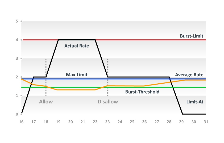

17(4+4+4+4+4+2+2+2+2+0+0+0+0+0+0+0)/16=1750Kbpsaverage-rate > burst-threshold → Burst is not allowed2Mbps
18(4+4+4+4+2+2+2+2+0+0+0+0+0+0+0+2)/16=1500Kbpsaverage-rate = burst-threshold → Burst is not allowed2Mbps
19(4+4+4+2+2+2+2+0+0+0+0+0+0+0+2+2)/16=1375Kbpsaverage-rate < burst-threshold → Burst is allowed4Mbps
20(4+4+2+2+2+2+0+0+0+0+0+0+0+2+2+4)/16=1375Kbpsaverage-rate < burst-threshold → Burst is allowed4Mbps
21(4+2+2+2+2+0+0+0+0+0+0+0+2+2+4+4)/16=1375Kbpsaverage-rate < burst-threshold → Burst is allowed4Mbps
22(2+2+2+2+0+0+0+0+0+0+0+2+2+4+4+4)/16=1375Kbpsaverage-rate < burst-threshold → Burst is allowed4Mbps
23(2+2+2+0+0+0+0+0+0+0+2+2+4+4+4+4)/16=1500Kbpsaverage-rate = burst-threshold → Burst is not allowed2Mbps
24(2+2+0+0+0+0+0+0+0+2+2+4+4+4+4+2)/16=1500Kbpsaverage-rate = burst-threshold → Burst is not allowed2Mbps
25(2+0+0+0+0+0+0+0+2+2+4+4+4+4+2+2)/16=1500Kbpsaverage-rate = burst-threshold → Burst is not allowed2Mbps
26(0+0+0+0+0+0+0+2+2+4+4+4+4+2+2+2)/16=1500Kbpsaverage-rate = burst-threshold → Burst is not allowed2Mbps
27(0+0+0+0+0+0+2+2+4+4+4+4+2+2+2+2)/16=1625Kbpsaverage-rate > burst-threshold → Burst is not allowed2Mbps
28(0+0+0+0+0+2+2+4+4+4+4+2+2+2+2+2)/16=1750Kbpsaverage-rate > burst-threshold → Burst is not allowed2Mbps
29(0+0+0+0+2+2+4+4+4+4+2+2+2+2+2+2)/16=1875Kbpsaverage-rate > burst-threshold → Burst is not allowed0Mbps
30(0+0+0+2+2+4+4+4+4+2+2+2+2+2+2+0)/16=1875Kbpsaverage-rate > burst-threshold → Burst is not allowed0Mbps
31(0+0+2+2+4+4+4+4+2+2+2+2+2+2+0+0)/16=1875Kbpsaverage-rate > burst-threshold → Burst is not allowed0Mbps

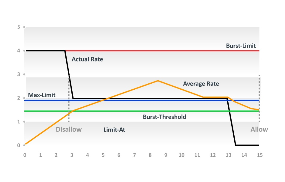

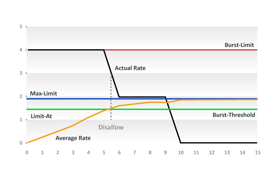

If we decrease burst-time to 8 seconds - we are able to see that in this case, bursts are only at the beginning of downloads. The average rate is calculated every 1/16th of burst time, so in this case every 0.5 seconds.
Timeaverage-rateburstactual-rate
0(0+0+0+0+0+0+0+0+0+0+0+0+0+0+0+0)/8=0Kbpsaverage-rate < burst-threshold → Burst is allowed4Mbps (2Mb per 0.5s)
0.5(0+0+0+0+0+0+0+0+0+0+0+0+0+0+0+2)/8=250Kbpsaverage-rate < burst-threshold → Burst is allowed4Mbps (2Mb per 0.5s)
1(0+0+0+0+0+0+0+0+0+0+0+0+0+0+2+2)/8=500Kbpsaverage-rate < burst-threshold → Burst is allowed4Mbps (2Mb per 0.5s)
1.5(0+0+0+0+0+0+0+0+0+0+0+0+0+2+2+2)/8=750Kbpsaverage-rate < burst-threshold → Burst is allowed4Mbps (2Mb per 0.5s)
2(0+0+0+0+0+0+0+0+0+0+0+0+2+2+2+2)/8=1000Kbpsaverage-rate < burst-threshold → Burst is allowed4Mbps (2Mb per 0.5s)
2.5(0+0+0+0+0+0+0+0+0+0+0+2+2+2+2+2)/8=1250Kbpsaverage-rate < burst-threshold → Burst is allowed4Mbps (2Mb per 0.5s)
3(0+0+0+0+0+0+0+0+0+0+2+2+2+2+2+2)/8=1500Kbpsaverage-rate = burst-threshold → Burst is not allowed2Mbps (1Mb per 0.5s)
3.5(0+0+0+0+0+0+0+0+0+2+2+2+2+2+2+1)/8=1625Kbpsaverage-rate > burst-threshold → Burst is not allowed2Mbps (1Mb per 0.5s)
4(0+0+0+0+0+0+0+0+2+2+2+2+2+2+1+1)/8=1750Kbpsaverage-rate > burst-threshold → Burst is not allowed2Mbps (1Mb per 0.5s)
4.5(0+0+0+0+0+0+0+2+2+2+2+2+2+1+1+1)/8=1875Kbpsaverage-rate > burst-threshold → Burst is not allowed2Mbps (1Mb per 0.5s)
5(0+0+0+0+0+0+2+2+2+2+2+2+1+1+1+1)/8=2000Kbpsaverage-rate > burst-threshold → Burst is not allowed2Mbps (1Mb per 0.5s)
5.5(0+0+0+0+0+2+2+2+2+2+2+1+1+1+1+1)/8=2125Kbpsaverage-rate > burst-threshold → Burst is not allowed2Mbps (1Mb per 0.5s)
6(0+0+0+0+2+2+2+2+2+2+1+1+1+1+1+1)/8=2250Kbpsaverage-rate > burst-threshold → Burst is not allowed2Mbps (1Mb per 0.5s)
6.5(0+0+0+2+2+2+2+2+2+1+1+1+1+1+1+1)/8=2375Kbpsaverage-rate > burst-threshold → Burst is not allowed2Mbps (1Mb per 0.5s)
7(0+0+2+2+2+2+2+2+1+1+1+1+1+1+1+1)/8=2500Kbpsaverage-rate > burst-threshold → Burst is not allowed2Mbps (1Mb per 0.5s)
7.5(0+2+2+2+2+2+2+1+1+1+1+1+1+1+1+1)/8=2625Kbpsaverage-rate > burst-threshold → Burst is not allowed2Mbps (1Mb per 0.5s)
8(2+2+2+2+2+2+1+1+1+1+1+1+1+1+1+1)/8=2750Kbpsaverage-rate > burst-threshold → Burst is not allowed2Mbps (1Mb per 0.5s)
8.5(2+2+2+2+2+1+1+1+1+1+1+1+1+1+1+1)/8=2625Kbpsaverage-rate > burst-threshold → Burst is not allowed2Mbps (1Mb per 0.5s)
9(2+2+2+2+1+1+1+1+1+1+1+1+1+1+1+1)/8=2500Kbpsaverage-rate > burst-threshold → Burst is not allowed2Mbps (1Mb per 0.5s)
9.5(2+2+2+1+1+1+1+1+1+1+1+1+1+1+1+1)/8=2375Kbpsaverage-rate > burst-threshold → Burst is not allowed2Mbps (1Mb per 0.5s)
10(2+2+1+1+1+1+1+1+1+1+1+1+1+1+1+1)/8=2250Kbpsaverage-rate > burst-threshold → Burst is not allowed2Mbps (1Mb per 0.5s)
10.5(2+1+1+1+1+1+1+1+1+1+1+1+1+1+1+1)/8=2125Kbpsaverage-rate > burst-threshold → Burst is not allowed2Mbps (1Mb per 0.5s)
11(1+1+1+1+1+1+1+1+1+1+1+1+1+1+1+1)/8=2000Kbpsaverage-rate > burst-threshold → Burst is not allowed2Mbps (1Mb per 0.5s)
11.5(1+1+1+1+1+1+1+1+1+1+1+1+1+1+1+1)/8=2000Kbpsaverage-rate > burst-threshold → Burst is not allowed2Mbps (1Mb per 0.5s)
12(1+1+1+1+1+1+1+1+1+1+1+1+1+1+1+1)/8=2000Kbpsaverage-rate > burst-threshold → Burst is not allowed2Mbps (1Mb per 0.5s)
12.5(1+1+1+1+1+1+1+1+1+1+1+1+1+1+1+1)/8=2000Kbpsaverage-rate > burst-threshold → Burst is not allowed2Mbps (1Mb per 0.5s)
13(1+1+1+1+1+1+1+1+1+1+1+1+1+1+1+1)/8=2000Kbpsaverage-rate > burst-threshold → Burst is not allowed0Mbps (0Mb per 0.5s)
13.5(1+1+1+1+1+1+1+1+1+1+1+1+1+1+1+0)/8=1875Kbpsaverage-rate > burst-threshold → Burst is not allowed0Mbps (0Mb per 0.5s)
14(1+1+1+1+1+1+1+1+1+1+1+1+1+1+0+0)/8=1750Kbpsaverage-rate > burst-threshold → Burst is not allowed0Mbps (0Mb per 0.5s)
14.5(1+1+1+1+1+1+1+1+1+1+1+1+1+0+0+0)/8=1625Kbpsaverage-rate > burst-threshold → Burst is not allowed0Mbps (0Mb per 0.5s)
15(1+1+1+1+1+1+1+1+1+1+1+1+0+0+0+0)/8=1500Kbpsaverage-rate > burst-threshold → Burst is not allowed0Mbps (0Mb per 0.5s)
15.5(1+1+1+1+1+1+1+1+1+1+1+0+0+0+0+0)/8=1375Kbpsaverage-rate < burst-threshold → Burst is allowed0Mbps (0Mb per 0.5s)
16(1+1+1+1+1+1+1+1+1+1+0+0+0+0+0+0)/8=1250Kbpsaverage-rate < burst-threshold → Burst is allowed0Mbps (0Mb per 0.5s)
16.5(1+1+1+1+1+1+1+1+1+0+0+0+0+0+0+0)/8=1125Kbpsaverage-rate < burst-threshold → Burst is allowed0Mbps (0Mb per 0.5s)
17(1+1+1+1+1+1+1+1+0+0+0+0+0+0+0+0)/8=1000Kbpsaverage-rate < burst-threshold → Burst is allowed2Mbps (1Mb per 0.5s)
17.5(1+1+1+1+1+1+1+0+0+0+0+0+0+0+0+1)/8=1000Kbpsaverage-rate < burst-threshold → Burst is allowed4Mbps (2Mb per 0.5s)
18(1+1+1+1+1+1+0+0+0+0+0+0+0+0+1+2)/8=1125Kbpsaverage-rate < burst-threshold → Burst is allowed4Mbps (2Mb per 0.5s)
18.5(1+1+1+1+1+0+0+0+0+0+0+0+0+1+2+2)/8=1250Kbpsaverage-rate < burst-threshold → Burst is allowed4Mbps (2Mb per 0.5s)
19(1+1+1+1+0+0+0+0+0+0+0+0+1+2+2+2)/8=1375Kbpsaverage-rate < burst-threshold → Burst is allowed4Mbps (2Mb per 0.5s)
19.5(1+1+1+0+0+0+0+0+0+0+0+1+2+2+2+2)/8=1500Kbpsaverage-rate = burst-threshold → Burst is not allowed2Mbps (1Mb per 0.5s)
20(1+1+0+0+0+0+0+0+0+0+1+2+2+2+2+1)/8=1500Kbpsaverage-rate = burst-threshold → Burst is not allowed2Mbps (1Mb per 0.5s)
20.5(1+0+0+0+0+0+0+0+0+1+2+2+2+2+1+1)/8=1500Kbpsaverage-rate = burst-threshold → Burst is not allowed2Mbps (1Mb per 0.5s)
21(0+0+0+0+0+0+0+0+1+2+2+2+2+1+1+1)/8=1500Kbpsaverage-rate = burst-threshold → Burst is not allowed2Mbps (1Mb per 0.5s)
21.5(0+0+0+0+0+0+0+1+2+2+2+2+1+1+1+1)/8=1625Kbpsaverage-rate > burst-threshold → Burst is not allowed2Mbps (1Mb per 0.5s)
22(0+0+0+0+0+0+1+2+2+2+2+1+1+1+1+1)/8=1750Kbpsaverage-rate > burst-threshold → Burst is not allowed2Mbps (1Mb per 0.5s)
22.5(0+0+0+0+0+1+2+2+2+2+1+1+1+1+1+1)/8=1875Kbpsaverage-rate > burst-threshold → Burst is not allowed2Mbps (1Mb per 0.5s)
23(0+0+0+0+1+2+2+2+2+1+1+1+1+1+1+1)/8=2000Kbpsaverage-rate > burst-threshold → Burst is not allowed2Mbps (1Mb per 0.5s)
23.5(0+0+0+1+2+2+2+2+1+1+1+1+1+1+1+1)/8=2125Kbpsaverage-rate > burst-threshold → Burst is not allowed2Mbps (1Mb per 0.5s)
24(0+0+1+2+2+2+2+1+1+1+1+1+1+1+1+1)/8=2250Kbpsaverage-rate > burst-threshold → Burst is not allowed2Mbps (1Mb per 0.5s)
24.5(0+1+2+2+2+2+1+1+1+1+1+1+1+1+1+1)/8=2375Kbpsaverage-rate > burst-threshold → Burst is not allowed2Mbps (1Mb per 0.5s)
25(1+2+2+2+2+1+1+1+1+1+1+1+1+1+1+1)/8=2500Kbpsaverage-rate > burst-threshold → Burst is not allowed2Mbps (1Mb per 0.5s)
25.5(2+2+2+2+1+1+1+1+1+1+1+1+1+1+1+1)/8=2500Kbpsaverage-rate > burst-threshold → Burst is not allowed2Mbps (1Mb per 0.5s)
26(2+2+2+1+1+1+1+1+1+1+1+1+1+1+1+1)/8=2375Kbpsaverage-rate > burst-threshold → Burst is not allowed2Mbps (1Mb per 0.5s)
26.5(2+2+1+1+1+1+1+1+1+1+1+1+1+1+1+1)/8=2250Kbpsaverage-rate > burst-threshold → Burst is not allowed2Mbps (1Mb per 0.5s)
27(2+1+1+1+1+1+1+1+1+1+1+1+1+1+1+1)/8=2125Kbpsaverage-rate > burst-threshold → Burst is not allowed2Mbps (1Mb per 0.5s)
27.5(1+1+1+1+1+1+1+1+1+1+1+1+1+1+1+1)/8=2000Kbpsaverage-rate > burst-threshold → Burst is not allowed2Mbps (1Mb per 0.5s)
28(1+1+1+1+1+1+1+1+1+1+1+1+1+1+1+1)/8=2000Kbpsaverage-rate > burst-threshold → Burst is not allowed2Mbps (1Mb per 0.5s)
28.5(1+1+1+1+1+1+1+1+1+1+1+1+1+1+1+1)/8=2000Kbpsaverage-rate > burst-threshold → Burst is not allowed2Mbps (1Mb per 0.5s)
29(1+1+1+1+1+1+1+1+1+1+1+1+1+1+1+1)/8=2000Kbpsaverage-rate > burst-threshold → Burst is not allowed2Mbps (1Mb per 0.5s)
29.5(1+1+1+1+1+1+1+1+1+1+1+1+1+1+1+1)/8=2000Kbpsaverage-rate > burst-threshold → Burst is not allowed2Mbps (1Mb per 0.5s)
30(1+1+1+1+1+1+1+1+1+1+1+1+1+1+1+1)/8=2000Kbpsaverage-rate > burst-threshold → Burst is not allowed2Mbps (1Mb per 0.5s)
30.5(1+1+1+1+1+1+1+1+1+1+1+1+1+1+1+1)/8=2000Kbpsaverage-rate > burst-threshold → Burst is not allowed0Mbps (0Mb per 0.5s)
31(1+1+1+1+1+1+1+1+1+1+1+1+1+1+1+0)/8=1875Kbpsaverage-rate > burst-threshold → Burst is not allowed0Mbps (0Mb per 0.5s)
