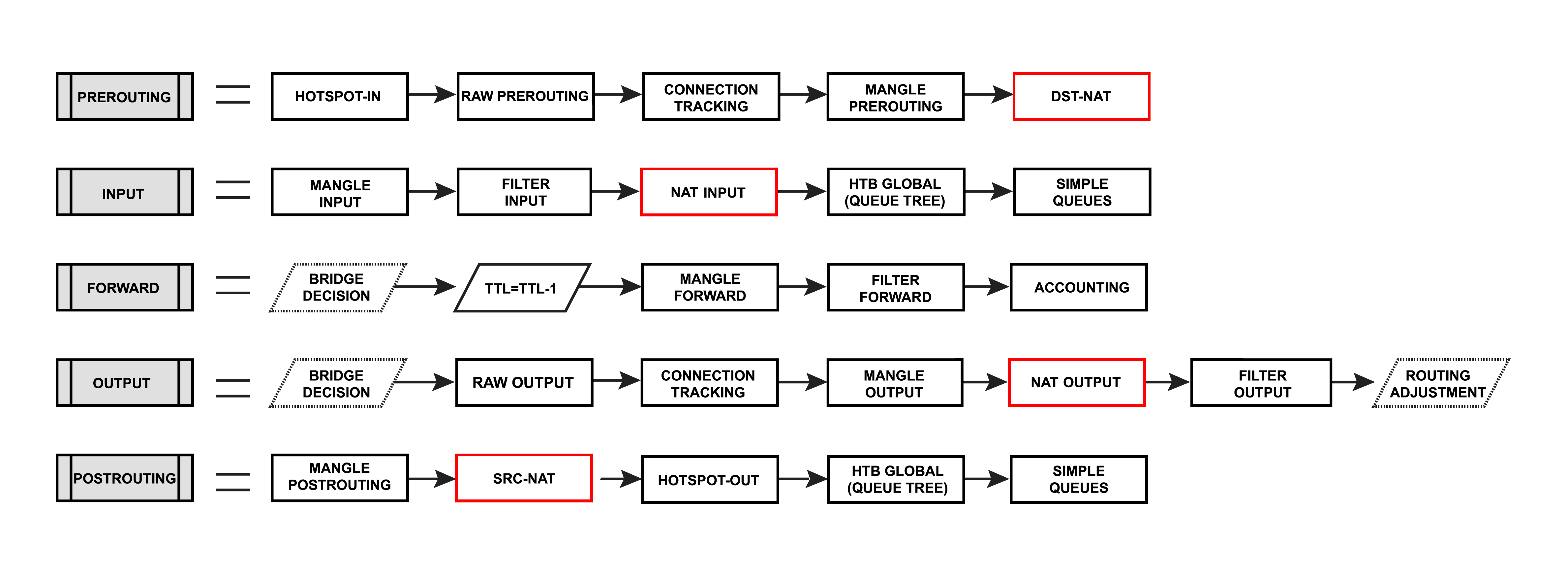

Types of NAT​
There are two types of NAT:
  • Source NAT or srcnat. This type of NAT is performed on packets that are originated from a natted network. A NAT router replaces the private source address of an IP packet with a new public IP address as it travels through the router. A reverse operation is applied to the reply packets traveling in the other direction.
  • Destination NAT or dstnat. This type of NAT is performed on packets that are destined for the natted network. It is most commonly used to make hosts on a private network accessible from the Internet. A NAT router performing dstnat replaces the destination IP address of an IP packet as it travels through the router toward a private network.
Since RouterOS v7 the firewall NAT has two new INPUT and OUTPUT chains which are traversed for packets delivered to and sent from applications running on the local machine:
  • input - used to process packets entering the router through one of the interfaces with the destination IP address which is one of the router's addresses. Packets passing through the router are not processed against the rules of the input chain.
  • output - used to process packets that originate from the router and leave it through one of the interfaces. Packets passing through the router are not processed against the rules of the output chain.

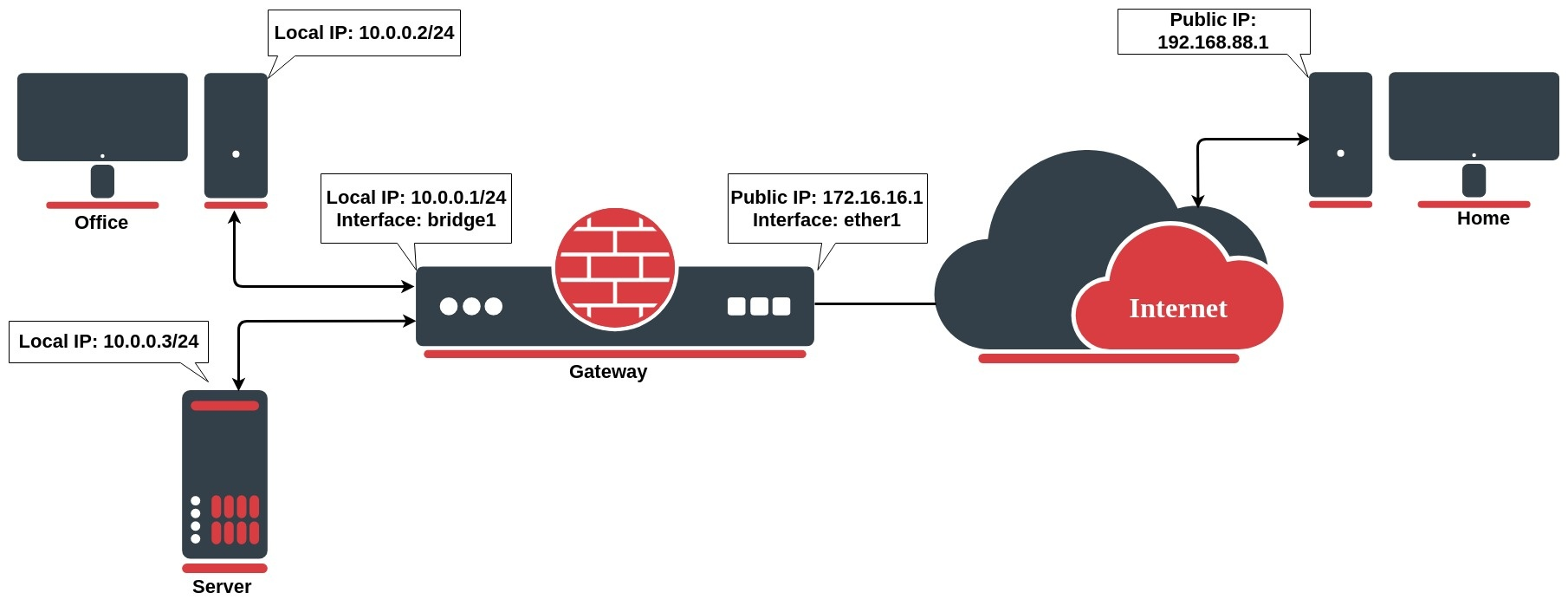

Destination NAT​
Network address translation works by modifying network address information in the packet's IP header. Let's take a look at the common setup where a network administrator wants to access an office server from the internet.
We want to allow connections from the internet to the office server whose local IP is 10.0.0.3. In this case, we have to configure a destination address translation rule on the office gateway router:
/ip/firewall/nat/add chain=dstnat action=dst-nat dst-address=172.16.16.1 dst-port=22 to-addresses=10.0.0.3 protocol=tcp
The rule above translates: when an incoming connection requests TCP port 22 with destination address 172.16.16.1, use the dst-nat action and redirect packets to the device with local IP address 10.0.0.3 and port 22.
tip
To allow access only from the PC at home, we can improve our dst-nat rule with "src-address=192.168.88.1" which is a Home's PC public (in this example) IP address. It is also considered to be more secure!
Source NAT​
If you want to hide your local devices behind your public IP address received from the ISP, you should configure the source network address translation (masquerading) feature of the MikroTik router. Let's assume you want to hide both the office computer and server behind the public IP 172.16.16.1. The rule will look like the following one:
/ip/firewall/nat/add chain=srcnat src-address=10.0.0.0/24 action=src-nat to-addresses=172.16.16.1 out-interface=WAN
Now your ISP will see all the requests coming with IP 172.16.16.1 and they will not see your LAN network IP addresses.

Hairpin NAT​
Hairpin network address translation (NAT Loopback) is where a device on the LAN can access another machine on the LAN via the public IP address of the gateway router.
In the above example, the gateway router has the following dst-nat configuration rule:
/ip/firewall/nat/add chain=dstnat action=dst-nat dst-address=172.16.16.1 dst-port=443 to-addresses=10.0.0.3 to-ports=443 protocol=tcp
When a user from the PC at home establishes a connection to the web server, the router performs DST NAT as configured:
  1. The client sends a packet with a source IP address of 192.168.88.1 to a destination IP address of 172.16.16.1 on port 443 to request some web resources.
  2. The router destination NATs the packet to 10.0.0.3 and replaces the destination IP address in the packet accordingly. The source IP address stays the same: 192.168.88.1.
  3. The server replies to the client's request and the reply packet has a source IP address of 10.0.0.3 and a destination IP address of 192.168.88.1.
  4. The router determines that the packet is part of a previous connection and undoes the destination NAT, and puts the original destination IP address into the source IP address field. The destination IP address is 192.168.88.1, and the source IP address is 172.16.16.1.
  5. The client receives the reply packet it expects, and the connection is established.
But there will be a problem when a client on the same network as the web server requests a connection to the web server's public IP address:
  1. The client sends a packet with a source IP address of 10.0.0.2 to a destination IP address of 172.16.16.1 on port 443 to request some web resources.
  2. The router destination NATs the packet to 10.0.0.3 and replaces the destination IP address in the packet accordingly. The source IP address stays the same: 10.0.0.2.
  3. The server replies to the client's request. However, the source IP address of the request is on the same subnet as the web server. The web server does not send the reply back to the router but sends it back directly to 10.0.0.2 with a source IP address in the reply of 10.0.0.3.
  4. The client receives the reply packet, but it discards it because it expects a packet back from 172.16.16.1, and not from 10.0.0.3.
To resolve this issue, we will configure a new src-nat rule (the hairpin NAT rule) as follows:
/ip/firewall/nat
add action=masquerade chain=srcnat dst-address=10.0.0.3 out-interface=LAN protocol=tcp src-address=10.0.0.0/24
After configuring the rule above:
  2. The router destination NATs the packet to 10.0.0.3 and replaces the destination IP address in the packet accordingly. It also source NATs the packet and replaces the source IP address in the packet with the IP address on its LAN interface. The destination IP address is 10.0.0.3, and the source IP address is 10.0.0.1.
  3. The web server replies to the request and sends the reply with a source IP address of 10.0.0.3 back to the router's LAN interface IP address of 10.0.0.1.
  4. The router determines that the packet is part of a previous connection and undoes both the source and destination NAT and puts the original destination IP address of 172.16.16.1 into the source IP address field and the original source IP address of 10.0.0.2 into the destination IP address field.
