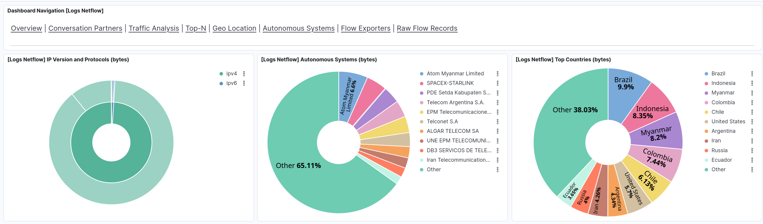

You should now see multiple NetFlow Dashboards. For example, try opening the "[Logs Netflow] Overview". If your NetFlow data is properly ingested, then you should now see graphs that summarize your traffic.

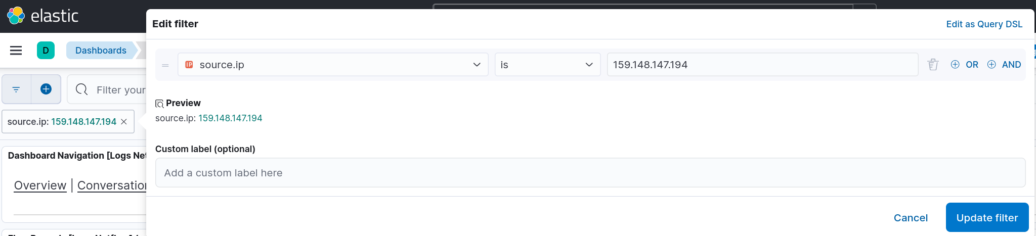

Another useful Dashboard is the "[Logs Netflow] Flow records", which shows you exact NetFlow records. A very useful feature is the filtering option (the + button on top), that allows you to add filters to NetFlow data, for example, you can filter the records to show only a single IP address:
Kibana NetFlow records view with a filter applied
There are other options such as searching for a specific time range. You should read more about Discover to understand the possibilities better.
