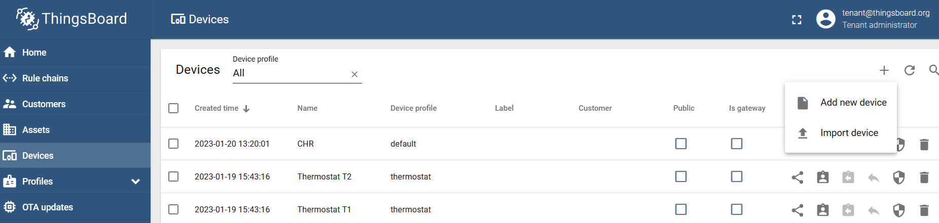

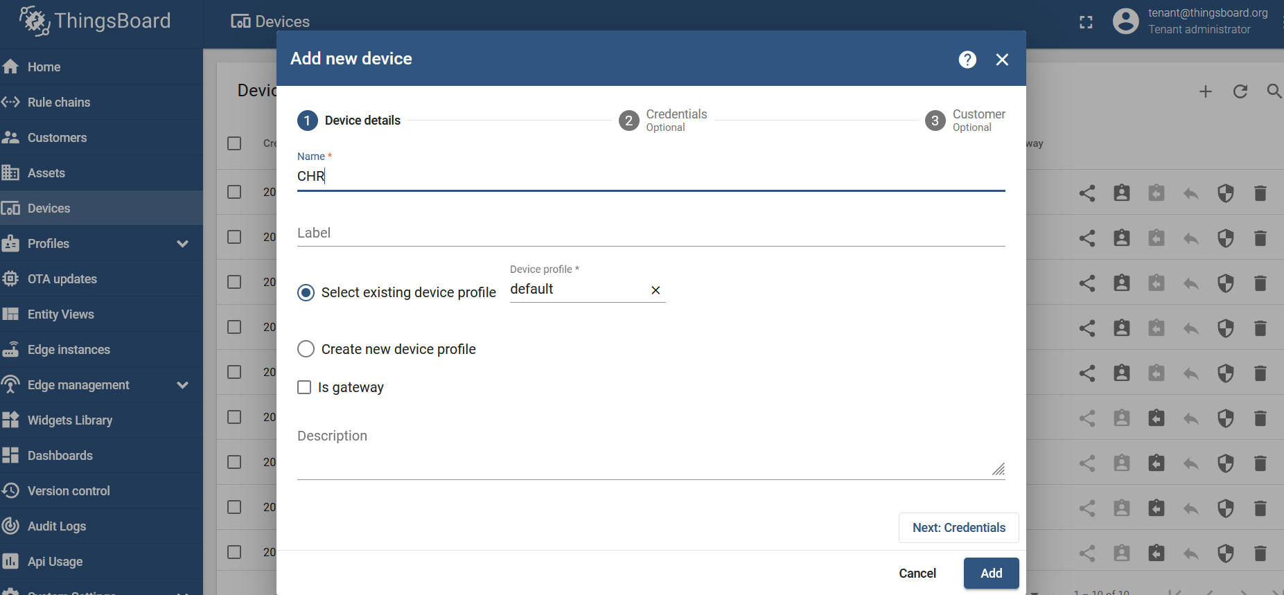

Log in with the tenant and create a new device. Go to the "Devices" menu, click on the "+" (Add Device) button and choose the "Add new device" option:
Name it, however you like, and click on "Add":

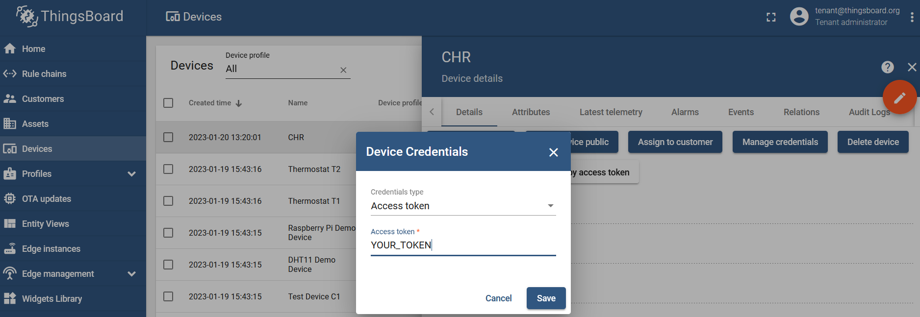

Check your device access token by clicking on the device you've just created and selecting the "Manage credentials" setting (copy the access token generated or type in your own → "YOUR_TOKEN"):
After these steps, go to the RouterOS settings (back to CHR settings) and create a new MQTT broker (make sure that you have the IoT package installed because otherwise, you will not have this menu):
/iot/mqtt/brokers/add name=tb address=172.18.0.2 port=1883 username=YOUR_TOKEN

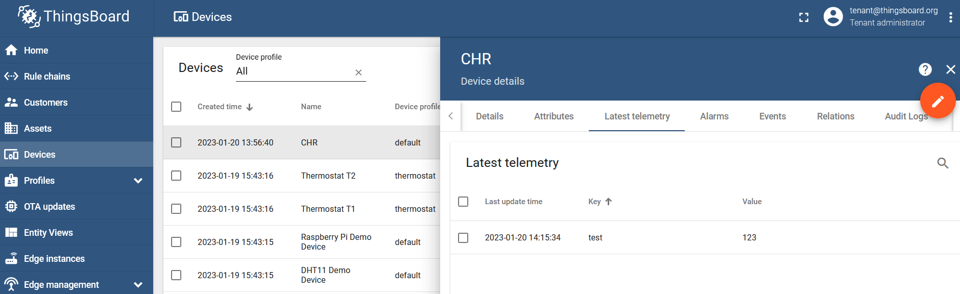

Publish a static test MQTT message in the JSON format:
/iot/mqtt/publish broker="tb" topic="v1/devices/me/telemetry" message="{\"test\":\"123\"}"

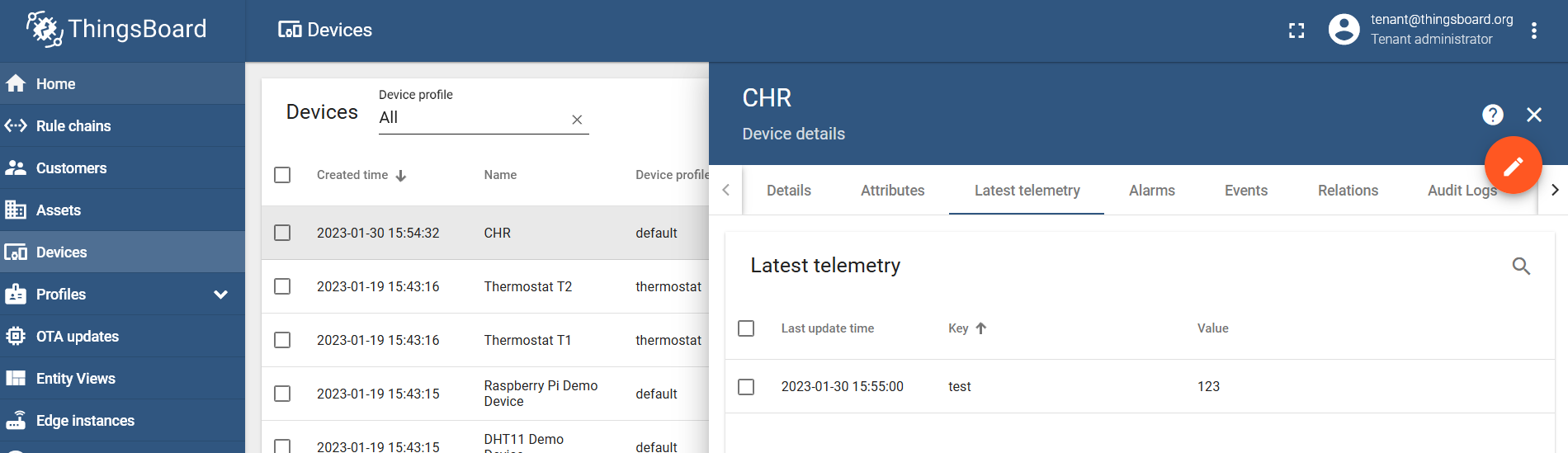

Confirm that the message was posted:
/iot/mqtt/publish broker="tbssl" topic="v1/devices/me/telemetry" message="{\"test\":\"123\"}"
And confirm that the broker received it → under the "Latest Telemetry" section on ThingsBoard.
