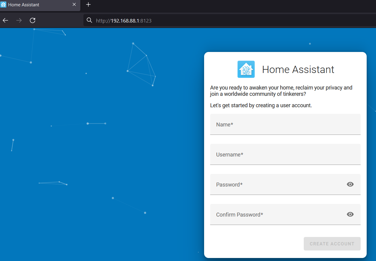

Home-Assistant setup​
Open your preferred web browser and access the Home-Assistant management portal by specifying the management port ":8123":
Proceed with the setup. More information is explained in the Home-Assistant onboarding guide.
