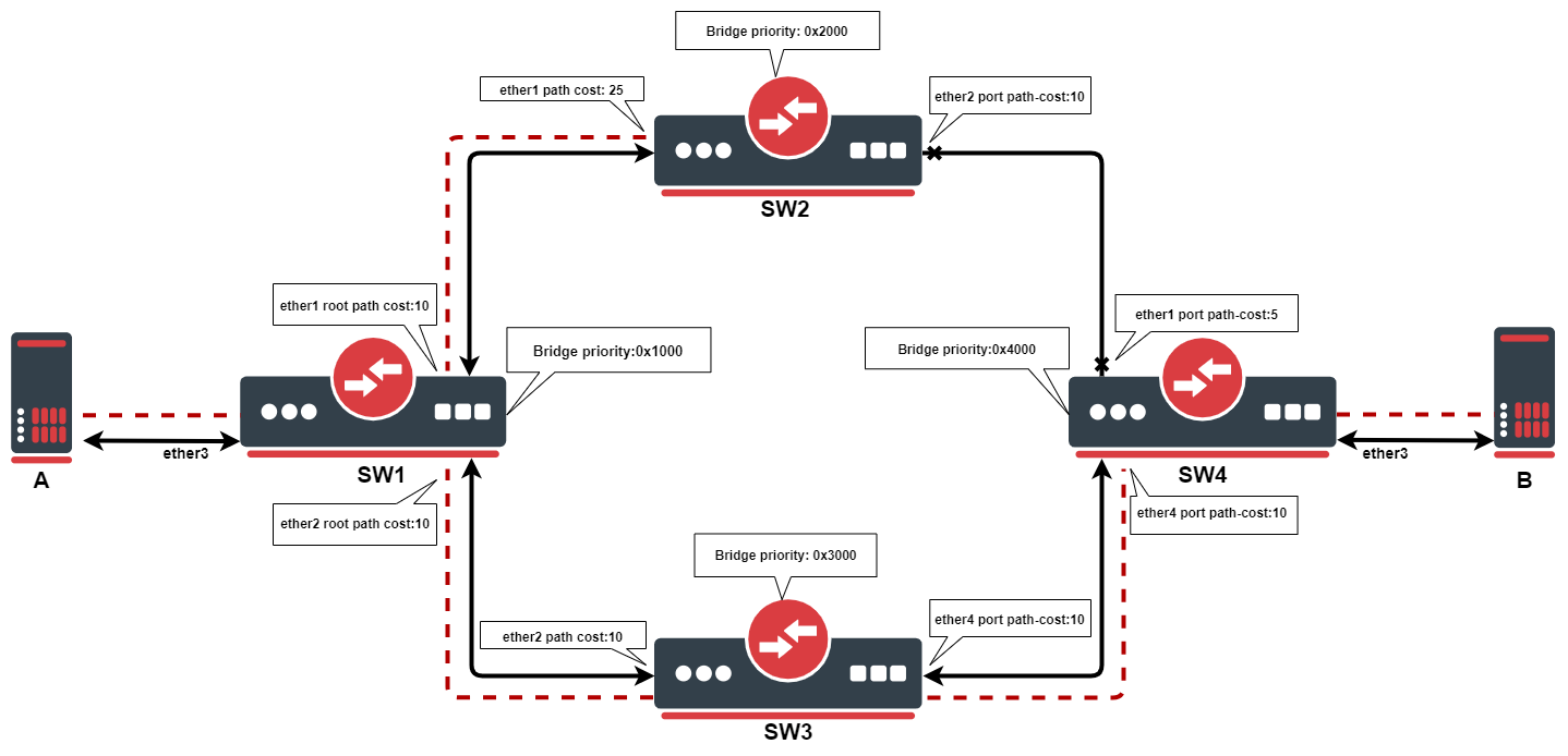

Root path cost example​
Root Path
This example outlines how the root path cost works. SW1 will be the root bridge, due to it having the lowest priority of 0x1000, as the root bridge. Each bridge will calculate the path cost to the root bridge. When calculating root path cost, bridges take into account the configured path cost on their ports + root path cost advertised by neighboring bridges.
SW1: due to it being the root bridge, it advertises a root path cost of 0 to its neighbors, even though it has a configured path cost of 10.
**SW2:**ether1 has a root path cost of 0 + 25=25. On the ether2 path the cost will be 10+10+10+0=30
SW3: ether2 has a root path cost of 0 + 10=10. On the ether4 path, the path cost will be 10+5+25+0=40
SW4: ether1 has a root path cost of 0+25+5=30. On ether4, path cost will be 10+10+0=20.
The Port with the lowest path cost will be elected as the root port. Every bridge in the STP topology needs a path to the root bridge. After the best path has been found, the redundant path will be blocked, in this case, the path between SW2 and SW4.
warning
You can configure path cost on the root bridge, but it will only be taken into account when the bridge loses its root status.

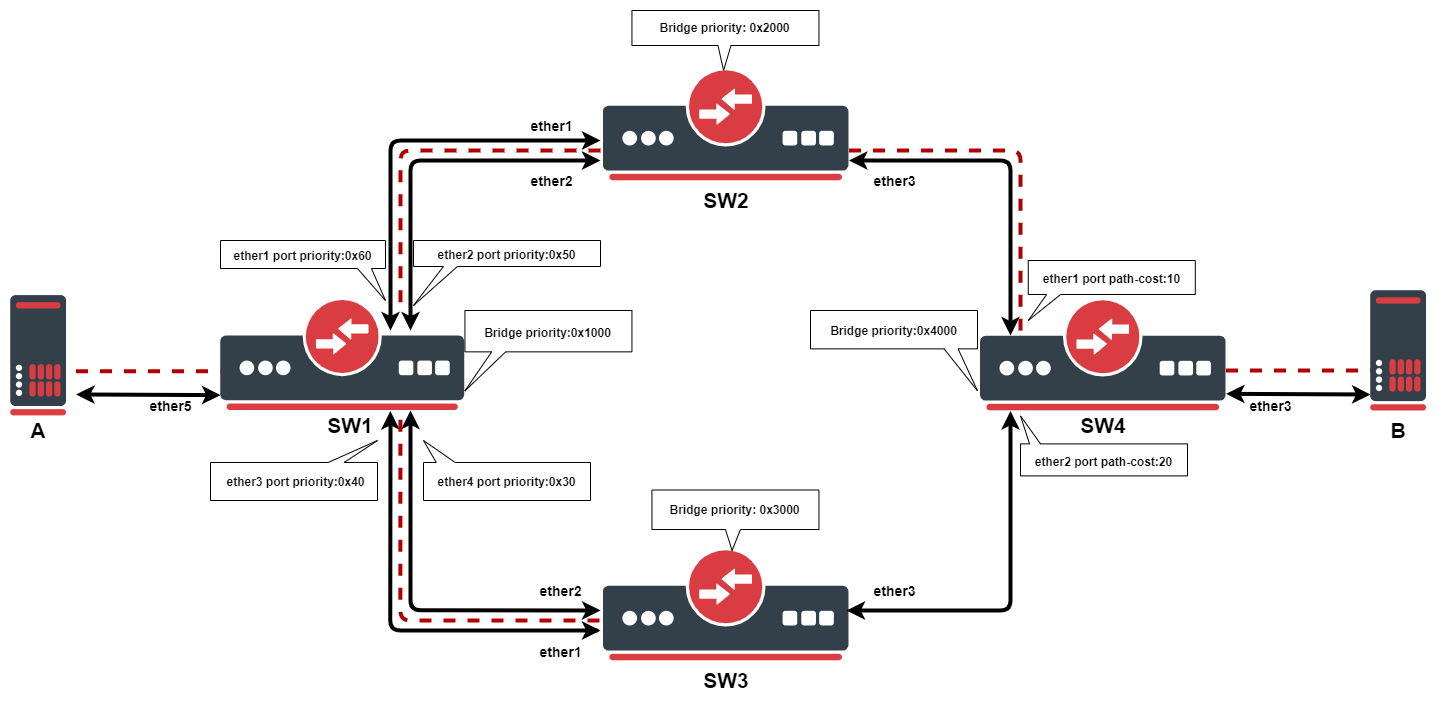

STP example​
STP Example 1
In this example, we want to ensure Layer2 redundancy for connections from ServerA to ServerB. If a port is connected to a device that is not a bridge and not running (R)STP, then this port is considered as an edge port. In this case, ServerA and ServerB are connected to an edge port. This is possible by using STP in a network. Below are configuration examples for each switch:
  • Configuration for SW1:
/interface/bridge
add name=bridge priority=0x1000
/interface/bridge/port
add bridge=bridge interface=ether1 priority=0x60
add bridge=bridge interface=ether2 priority=0x50
add bridge=bridge interface=ether3 priority=0x40
add bridge=bridge interface=ether4 priority=0x30
add bridge=bridge interface=ether5
  • Configuration for SW2:
/interface/bridge
add name=bridge priority=0x2000
  • Configuration for SW3
/interface/bridge
add name=bridge priority=0x3000
  • Configuration for SW4:
/interface/bridge
add name=bridge priority=0x4000
add bridge=bridge interface=ether2 path-cost=20
In this example, SW1 is the root bridge since it has the lowest bridge priority. SW2 and SW3 have ether1,ether2 connected to the root bridge, and ether3 is connected to SW4. When all switches are working properly, the traffic will be flowing from ServerA through SW1_ether2, through SW2, and through SW4 to ServerB. In the case of SW1 failure, SW2 becomes the root bridge because of the next lowest priority, indicated by the dotted line in the diagram. Below is a list of ports and their role for each switch:
  • root-port - SW2_ether2, SW3_ether2, SW4_ether1
  • alternate-port - SW2_ether1, SW3_ether1, SW4_ether2
  • designated-port - SW1_ether1, SW1_ether2, SW1_ether3, SW1_ether4, SW1_ether5, SW2_ether3, SW3_ether3, SW4_ether3
note
Note: According to the 802.1Q recommendations, you should use bridge priorities in steps of 4096. To set a recommended priority, it is more convenient to use hexadecimal notation, for example, 0 is 0x0000, 4096 is 0x1000, 8192 is 0x2000, and so on (0..F).

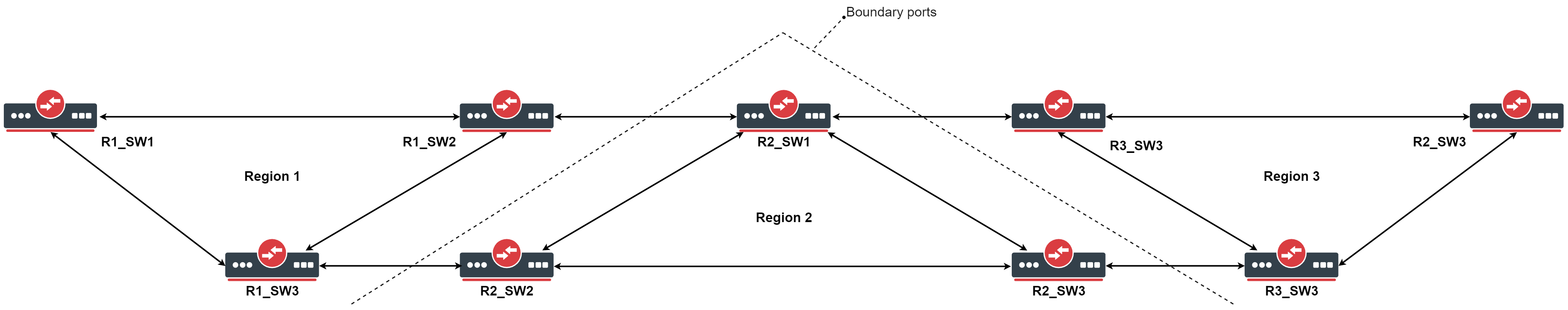

MSTP Regions​
MSTP works in groups called regions. For each region there will be a regional root bridge, and between regions, there will be a root bridge elected. MSTP will use an Internal Spanning Tree (IST) to build the network topology inside a region and a Common Spanning Tree (CST) outside a region to build the network topology between multiple regions. MSTP combines these two protocols into Common and Internal Spanning Tree (CIST), which holds information about topology inside a region and between regions. From CST's perspective, a region will seemingly be a single virtual bridge, because of this MSTP is considered very scalable for large networks. For bridges to be in the same region, their configuration must match. BPDUs will not include VLAN mappings since they can be large, rather a computed hash is being transmitted. If a bridge receives a BPDU through a port and the configuration does not match, then MSTP will consider that port as a boundary port and that it can be used to reach other regions. Below is a list of parameters that need to match for MSTP to consider a BPDU from the same region:
  • Region name
  • Region revision
  • VLAN mappings to MST Instance IDs (computed hash)
It is possible to create an MSTP enabled network without regions, though to be able to do load balancing per VLAN group it is required for a bridge to receive a BPDU from a bridge that is connected to it with the same parameters mentioned above. In RouterOS the default region name is empty and the region revision is 0, which are valid values, but you must make sure that they match to get multiple bridges in a single MSTP region. A region cannot exist if its bridges are scattered over the network; these bridges must be connected in at least one way, in which they can send and receive BPDUs without leaving the region, for example, if a bridge with different region related parameters is between two bridges that have the same region related parameters, then there will exist at least 3 different MSTP regions.
MSTP Topology
The downside of running every single bridge in a single MSTP region is the excess CPU cycles. In comparison, PVST(+) creates a Spanning Tree Instance for each VLAN ID that exists on the network, since there will be very limited paths that can exist in a network, this approach creates a lot of overhead and unnecessary CPU cycles. This also means that this approach does not scale very well and can overload switches with not very powerful CPUs. MSTP solves this problem by dividing the network into MSTP regions, where each bridge inside this region will exchange and process information about VLANs that exist inside the same region, but will run a single instance of Spanning Tree Protocol in the background to maintain the network topology between regions. This approach has been proven to be much more effective and much more scalable. This means that regions should be used for larger networks to reduce CPU cycles.

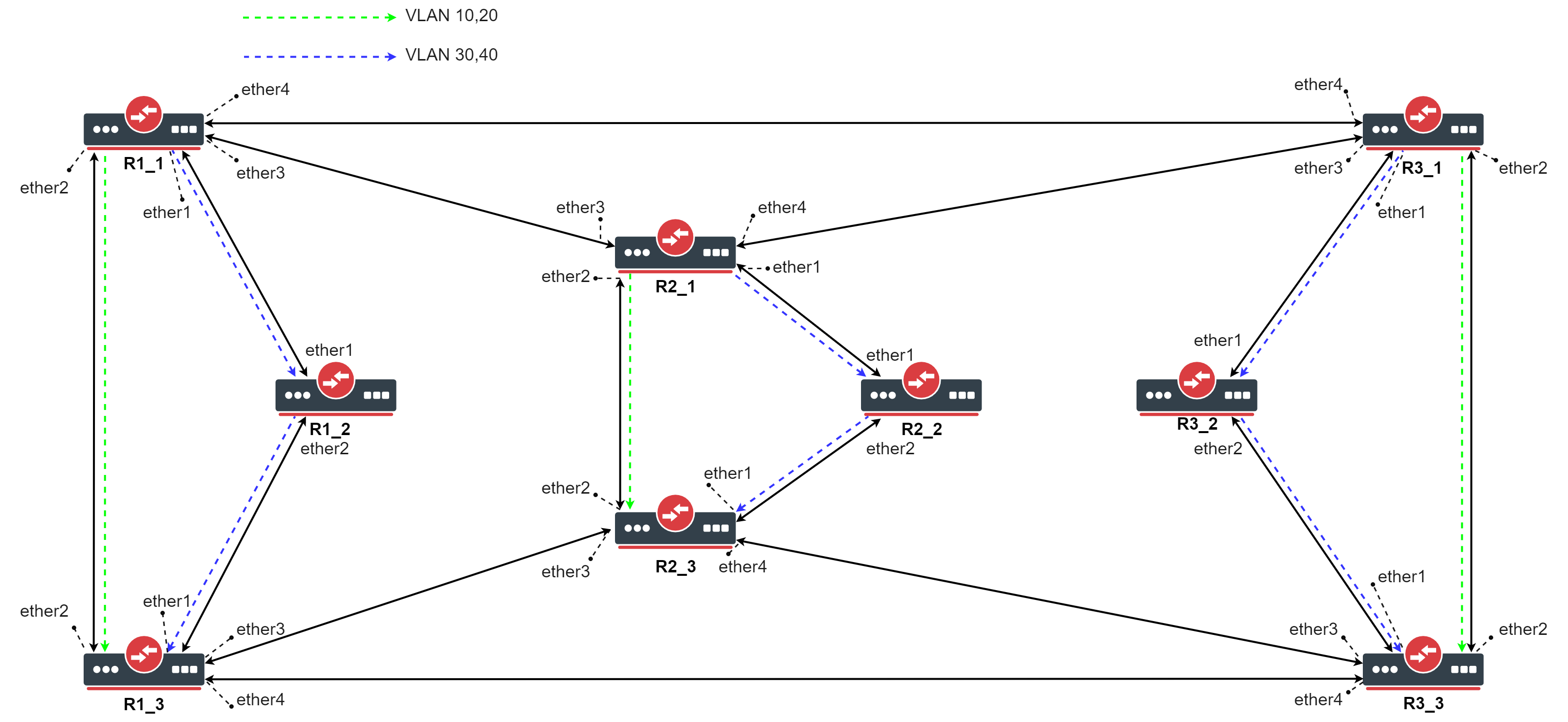

In regions, you can define MST Instances, which are used to configure load balancing per VLAN group and to elect the regional root bridge. It is worth mentioning that in each region there exists a pre-defined MST Instance, in most documentation, this is referred to as MSTI0· This MST Instance is considered as the default MST Instance. There are certain parameters that apply to this special MST Instance. When traffic passes through an MSTP-enabled bridge, MSTP will look for an MST Instance that has a matching VLAN mapping, but if a VLAN mapping does not exist for a certain VLAN ID, then traffic will fall under MSTI0.
warning
Since MSTP requires VLAN filtering on the bridge interface to be enabled, then make sure that you have allowed all required VLAN IDs in /interface/bridge/vlan, otherwise, the traffic will not be forwarded and it might seem as if MSTP is misconfigured, although this is a VLAN filtering misconfiguration.

Let's say that we need to design a topology and configure MSTP in a way that VLAN 10,20 will be forwarded in one path, but VLAN 30,40 will be forwarded in a different path, while all other VLAN IDs will be forwarded in one of those paths. This can easily be done by setting up MST Instances and assigning port path costs. Below you can find a network topology that needs to do load balancing per VLAN group with 3 separate regions as an example:
MSTP Example
The topology of an MSTP-enabled network with load balancing per VLAN group
Start by adding each interface to a bridge. Initially, you should create a (R)STP bridge without VLAN filtering enabled. This is to prevent losing access to the CPU. Each device in this example is named by the region that it is in (Rx) and a device number (_x). For larger networks configuring MSTP can be confusing because of the number of links and devices. We recommend using The Dude to monitor and design a network topology.
  • Use the following commands on R1_1, R1_3, R2_1, R2_3, R3_1, R3_3:
/interface/bridge
add name=bridge protocol-mode=rstp vlan-filtering=no
  • Use the following commands on R1_2, R2_2, R3_2.
/interface/bridge
  • Make sure you allow the required VLAN IDs on these devices. Here we will consider that each device will receive tagged traffic that needs to be load balanced per VLAN group. Use these commands on R1_1, R1_3, R2_1, R2_3, R3_1, R3_3:
add bridge=bridge tagged=ether1,ether2,ether3,ether4 vlan-ids=10,20,30,40
  • Use the following commands on R1_2, R2_2, R3_2:
add bridge=bridge tagged=ether1,ether2 vlan-ids=10,20,30,40
warning
Make sure you add all the needed VLAN IDs and ports to the bridge VLAN table, otherwise, your device will not forward all required VLANs, and/or you will lose access to the device.
We need to assign a region name for each bridge that we want to be in a single MSTP region. You can also specify the region revision, but it is optional, though they need to match. In this example, if all bridges have the same region name, then they will all be in a single MSTP bridge. In this case, we want to separate a group of 3 bridges in a different MSTP region to do load balancing per VLAN group and to create diversity and scalability:
  • Set the appropriate region name (and region revision) for each bridge, and use the following commands on each device (change the region name!):
/interface/bridge
set bridge region-name=Rx region-revision=1
After we have created 3 different MSTP regions, we need to decide which device is going to be a regional root for each VLAN group. For consistency, we are going to set the first device (_1) in each region as the regional root for VLAN 10,20 and the third device (_3) in each region as the regional root for VLAN 30,40. This can be done by creating an MST Instance for each VLAN group and assigning a bridge priority to it. The MST Instance identifier is only relevant inside an MSTP region, outside an MSTP region, these identifiers can be different and mapped to a different VLAN group.
  • Use the following commands on R1_1, R2_1, R3_1:
/interface/bridge/msti
add bridge=bridge identifier=1 priority=0x1000 vlan-mapping=10,20
add bridge=bridge identifier=2 priority=0x3000 vlan-mapping=30,40
  • Use the following commands on R1_3, R2_3, R3_3:
add bridge=bridge identifier=1 priority=0x3000 vlan-mapping=10,20
add bridge=bridge identifier=2 priority=0x1000 vlan-mapping=30,40
add bridge=bridge identifier=1 priority=0x2000 vlan-mapping=10,20
add bridge=bridge identifier=2 priority=0x2000 vlan-mapping=30,40
Now we need to override the port path-cost and/or port priority for each MST Instance. This can be done by adding an MST-Override entry for each port and each MST Instance. To achieve that for a certain MST Instance the traffic flow path is different, we simply need to make sure that the port path cost and/or priority is larger. We can either increase the port path cost or decrease the port path cost for ports that are facing toward the regional root bridge. It doesn't matter if you increase or decrease all values; it is important that in the end, one port's path cost is larger than the other's.
/interface/bridge/port/mst-override
add identifier=2 interface=ether1 internal-path-cost=5
add identifier=2 interface=ether2 internal-path-cost=15
add identifier=1 interface=ether1 internal-path-cost=5
add identifier=2 interface=ether2 internal-path-cost=9
add identifier=1 interface=ether2 internal-path-cost=5
add identifier=1 interface=ether3 internal-path-cost=9
In this case for VLAN 10,20 to reach the third device from the first device, it would choose between ether1 and ether2, one port will be blocked and set as an alternate port, and ether1 will have path cost as 5+9=14 and ether2 will have path cost as 10, ether2 will be elected as the root port for MSTI1 on the third device. In case for VLAN 30,40 to reach the first device from the third device, ether1 will have path cost as 5+9=14 and ether2 will have path cost as 15, ether1 will be elected as the root port for MSTI2 on the third device.
