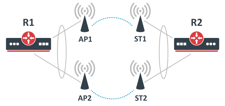

LAG interfaces and load balancing​
Consider the following scenario: you have created a LAG interface to increase total bandwidth between 2 network nodes; usually, these are switches. For testing purposes to make sure that the LAG interface is working properly, you have attached two servers that transfer data, most commonly the well-known network performance measurement tool Iperf is used to test such setups. For example, you might have made a LAG interface out of two Gigabit Ethernet ports, which gives you a virtual interface that can load balance traffic over both interfaces and theoretically reach 2Gbps throughput, while the servers are connected using a 10Gbps interface, for example, SFP+.
LACP Setup
Configuration​
The following configuration is relevant to SW1 and SW2:
/interface/bonding
add mode=802.3ad name=bond1 slaves=ether1,ether2
/interface/bridge
add name=bridge1
/interface/bridge/port
add bridge=bridge1 interface=bond1
add bridge=bridge1 interface=sfp-sfpplus1
Problem​
After initial tests, you immediately notice that your network throughput never exceeds the 1Gbps limit even though the CPU load on the servers is low as well as on the network nodes (switches in this case), but the throughput is still limited to only 1Gbps. The reason behind this is that LACP (802.ad) uses transmit hash policy in order to determine if traffic can be balanced over multiple LAG members, in this case, a LAG interface does not create a 2Gbps interface, but rather an interface that can balance traffic over multiple slave interfaces whenever it is possible. For each packet a transmit hash is generated, this determines through which LAG member the packet will be sent, this is needed in order to avoid packets being out of order, there is an option to select the transmit hash policy, usually, there is an option to choose between Layer2 (MAC), Layer3 (IP) and Layer4 (Port), in RouterOS, this can be selected by using the transmit-hash-policy parameter. In this case, the transmit hash is the same since you are sending packets to the same destination MAC address, as well as the same IP address and Iperf uses the same port as well, this generates the same transmit hash for all packets and load balancing between LAG members is not possible. Note that packets will not always get balanced over LAG members even though the destination is different, this is because the standardized transmit hash policy can generate the same transmit hash for different destinations, for example, 192.168.0.1/192.168.0.2 will get balanced, but 192.168.0.2/192.168.0.4 will NOT get balanced in case layer2-and-3 transmit hash policy is used and the destination MAC address is the same.
Symptoms​
Below is a list of possible symptoms that might be a result of this kind of misconfiguration:
  • Traffic going through only one LAG member.
Solution​
Choose the proper transmit hash policy and test your network's throughput properly. The simplest way to test such setups is to use multiple destinations, for example, instead of sending data to just one server, send data to multiple servers. This will generate a different transmit hash for each packet and will make load balancing across LAG members possible. For some setups, you might want to change the bonding interface mode to increase the total throughput. For UDP traffic balance-rr mode might be sufficient, but can cause issues for TCP traffic. You can read more about selecting the right mode for your setup here.

Consider the following scenario: you have set up multiple Wireless links and to achieve maximum throughput and yet to achieve redundancy you have decided to place Ethernet interfaces into a bond and depending on the traffic that is being forwarded you have chosen a certain bonding mode. This scenario can be applied to any case where a bonding interface is created between links that are not directly connected to each other.
LACP over WLAN
Configuration​
The following configuration is relevant to R1 and R2:
/interface/bonding
add mode=802.3ad name=bond1 slaves=ether1,ether2 transmit-hash-policy=layer-2-and-3
/ip/address
add address=192.168.1.X/24 interface=bond1
The following configuration is relevant to AP1, AP2, ST1, and ST2, where X corresponds to an IP address for each device.
/interface/bridge
add name=bridge1 protocol-mode=none
add interface=ether1 bridge=bridge1
add interface=wlan1 bridge=bridge1
/ip/address
add address=192.168.1.X/24 interface=bridge1
Problem​
While traffic is being forwarded properly between R1 and R2, load balancing, link failover are working properly as well, but devices between R1 and R2 are not always accessible or some of them are completely inaccessible (in most cases AP2 and ST2 are inaccessible). After examining the problem you might notice that packets do not always get forwarded over the required bonding slave and as a result, are never received by the device you are trying to access. This is a network design and bonding protocol limitation. As soon as a packet needs to be sent out through a bonding interface (in this case you might be trying to send ICMP packets to AP2 or ST2), the bonding interface will create a hash based on the selected bonding mode and transmit-hash-policy and will select an interface, through which to send the packet out, regardless of whether the destination is only reachable through a certain interface. Some devices will be accessible because the generated hash matches the interface, on which the device is located, but it might not choose the needed interface as well, which will result in an inaccessible device. Only broadcast bonding mode does not have this kind of protocol limitation, but this bonding mode has a very limited use case.
Symptoms​
  • Limited connectivity
  • Unstable links (in case of balance-rr)
Solution​
Bonding interfaces are not supposed to be connected using indirect links, but it is still possible to create a workaround. The idea behind this workaround is to find a way to bypass packets being sent out using the bonding interface. There are multiple ways to force a packet not to be sent out using the bonding interface, but essentially the solution is to create new interfaces on top of physical interfaces and add these newly created interfaces to a bond instead of the physical interfaces. One way to achieve this is to create EoIP tunnels on each physical interface, but that creates a huge overhead and will reduce overall throughput. You should create a VLAN interface on top of each physical interface instead. This creates a much smaller overhead and will not impact overall performance noticeably. Here is an example of how R1 and R2 should be reconfigured:
/interface/vlan
add interface=ether1 name=VLAN_ether1 vlan-id=999
add interface=ether2 name=VLAN_ether2 vlan-id=999
/interface/bonding
add mode=balance-xor name=bond1 slaves=VLAN_ether1,VLAN_ether2 transmit-hash-policy=layer-2-and-3
/ip/address
add address=192.168.11.X/24 interface=ether1
add address=192.168.22.X/24 interface=ether2
AP1 and ST1 only need updated IP addresses to the correct subnet:
/ip/address
add address=192.168.11.X/24 interface=bridge1
The same changes must be applied to AP2 and ST2 (make sure to use the correct subnet):
/ip/address
add address=192.168.22.X/24 interface=bridge1
With this approach, you create the least overhead and the fewest configuration changes are required.
warning
LACP (802.3ad) is not meant to be used in setups, where devices' bonding slaves are not directly connected, in this case, it is not recommended to use LACP if there are Wireless links between both routers. LACP requires both bonding slaves to be at the same link speeds, Wireless links can change their rates at any time, which will decrease overall performance and stability. Other bonding modes should be used instead.
