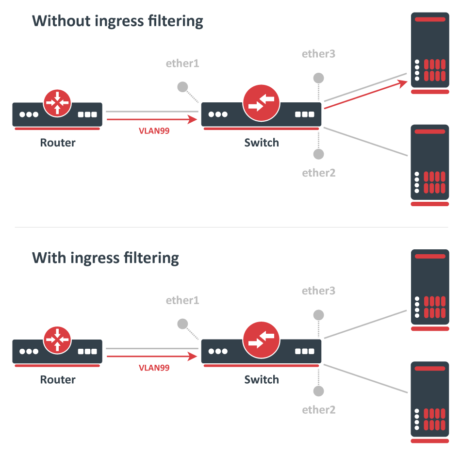

While frame-type can be used to drop a certain type of packet, the ingress-filtering can be used to filter out packets before they can be sent out. To fully understand the need for ingress filtering, consider the following scenario: VLAN99 is allowed on ether3 and bridge1, but you can still send VLAN99 traffic from ether1 to ether3. This is because the bridge VLAN table checks if a port is allowed to carry a certain VLAN only on egress ports. In our case, ether3 is allowed to carry VLAN99 and for this reason, it is forwarded. To prevent this, you MUST use ingress-filtering. With ingress filtering, ingress packets are also checked. In our case, the bridge VLAN table does not contain an entry that VLAN99 is allowed on ether1, and therefore the packet will be dropped immediately. Of course, in our scenario without ingress filtering, the connection cannot be established since VLAN99 can be forwarded only from ether1 to ether3, but not from ether3 to ether1, though there are still possible attacks that can be used in such a misconfiguration (for example, ARP poisoning). The packet dropping behavior is illustrated in the image below:
Trunk and Access Setup Ingress
Trunk/access port setup with and without ingress filtering. Ingress filtering can prevent unwanted traffic from being forwarded. Note that ether1 is not allowed to carry VLAN99 in the bridge VLAN table.
danger
Always try to use ingress-filtering wherever it is possible. It adds a significant layer of security.
