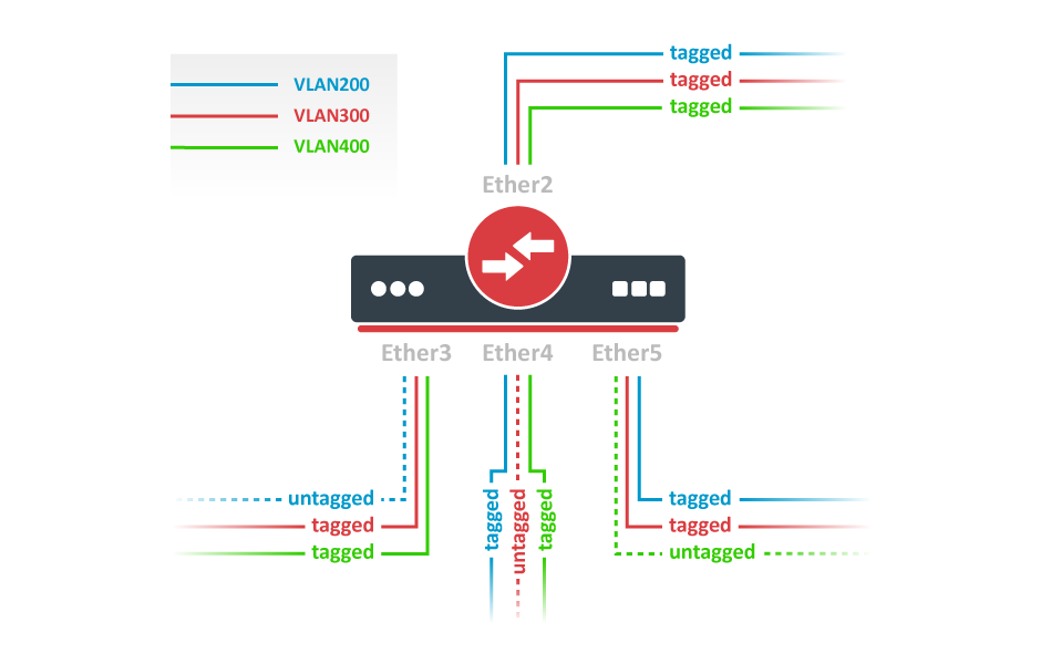

VLAN Table​
The VLAN table specifies certain forwarding rules for packets that have a specific 802.1Q tag. Those rules are of higher priority than switch groups configured using the Bridge Hardware Offloading feature. Basically, the table contains entries that map specific VLAN tag IDs to a group of one or more ports. Packets with VLAN tags leave the switch chip through one or more ports that are set in the corresponding table entry. The exact logic that controls how packets with VLAN tags are treated is controlled by a vlan-mode parameter that is changeable per switch port.
VLAN ID based forwarding takes into account the MAC addresses dynamically learned or manually added in the host table. QCA8337 and Atheros8327 switch-chips also support Independent VLAN Learning (IVL) which does the learning based on both - MAC addresses and VLAN IDs, thus allowing the same MAC to be used in multiple VLANs.
Packets without a VLAN tag are treated just as if they had a VLAN tag with portdefault-vlan-id. If vlan-mode=check or vlan=mode=secure is configured, to forward packets without VLAN tags you have to add an entry to the VLAN table with the same VLAN ID according to the default-vlan-id.
PropertyDescription
disabled (no | yes; Default: no)Enables or disables switch VLAN entry.
independent-learning (no*| yes*; Default: yes)Whether to use shared-VLAN-learning (SVL) or independent-VLAN-learning (IVL).
ports (name; Default: none)Interface member list for the respective VLAN. This setting accepts comma-separated values. e.g. ports=ether1,ether2.
switch (name; Default: none)Name of the switch for which the respective VLAN entry is intended.
vlan-id (integer: 0..4095; Default:)The VLAN ID for certain switch port configurations.
warning
Devices with MT7621, MT7531, EN7523, RTL8367, 88E6393X, 88E6191X, 88E6190 switch chips support HW offloaded vlan-filtering in RouterOS v7. VLAN-related configuration on the /interface/ethernet/switch menu is not available.
VLAN Forwarding​
Both vlan-mode and vlan-header along with the VLAN Table can be used to configure VLAN tagging, untagging and filtering. Multiple combinations are possible, each achieving a different result. Below you can find a table of what kind of traffic is going to be sent out through an egress port when certain traffic is received on an ingress port for each VLAN Mode.
NOTES:
  • L - vlan-header is set to leave-as-is
  • S - vlan-header is set to always-strip
  • A - vlan-header is set to add-if-missing
  • U - Untagged traffic is sent out
  • T - Tagged traffic is sent out, a tag is already present on the ingress port
  • TA - Tagged traffic is sent out, a tag was added on the ingress port
  • DI - Traffic is dropped on ingress port because of the mode selected in vlan-mode
  • DE - Traffic is dropped on egress port because the egress port was not found in the VLAN Table
  • VID match - VLAN ID from the VLAN tag for ingress traffic is present in the VLAN Table
  • Port match - Ingress port is present in the VLAN Table for the appropriate VLAN ID
VLAN Mode = disabledEgress port is not present in VLAN TableEgress port is present in VLAN Table
LSALSA
Untagged trafficUUTAUUTA
Tagged traffic; no VID matchTUT
Tagged traffic; VID match; no Port matchTUTTUT
Tagged traffic; VID match; Port matchTUTTUT
VLAN Mode = fallbackEgress port is not present in VLAN TableEgress port is present in VLAN Table
LSALSA
Tagged traffic; VID match; no Port matchDEDEDETUT
Tagged traffic; VID match; Port matchDEDEDETUT
VLAN Mode = checkEgress port is not present in VLAN TableEgress port is present in VLAN Table
LSALSA
Untagged traffic
Tagged traffic; no VID matchDIDIDI
VLAN Mode = secureEgress port is not present in VLAN TableEgress port is present in VLAN Table
LSALSA
Untagged traffic
Tagged traffic; VID match; no Port matchDIDIDIDIDIDI

VLAN Example 2 (Trunk and Hybrid Ports)​
VLAN Hybrid ports can forward both tagged and untagged traffic. This configuration is supported only by some Gigabit switch chips (QCA8337, Atheros8327).
Hybrid Ports
Switch together the required ports:
/interface/bridge
add name=bridge1
/interface/bridge/port
add bridge=bridge1 interface=ether2 hw=yes
add bridge=bridge1 interface=ether3 hw=yes
add bridge=bridge1 interface=ether4 hw=yes
add bridge=bridge1 interface=ether5 hw=yes
warning
By default, the bridge interface is configured with protocol-mode set to rstp. For some devices, this can disable hardware offloading because specific switch chips do not support this feature. See the Bridge Hardware Offloading section with supported features.
Add VLAN table entries to allow frames with specific VLAN IDs between ports.
/interface/ethernet/switch/vlan
add ports=ether2,ether3,ether4,ether5 switch=switch1 vlan-id=200
add ports=ether2,ether3,ether4,ether5 switch=switch1 vlan-id=300
add ports=ether2,ether3,ether4,ether5 switch=switch1 vlan-id=400
In the switch port menu set vlan-mode on all ports and also default-vlan-id on planned hybrid ports:
/interface/ethernet/switch/port
set ether2 vlan-mode=secure vlan-header=leave-as-is
set ether3 vlan-mode=secure vlan-header=leave-as-is default-vlan-id=200
set ether4 vlan-mode=secure vlan-header=leave-as-is default-vlan-id=300
set ether5 vlan-mode=secure vlan-header=leave-as-is default-vlan-id=400
  • vlan-mode=secure will ensure strict use of the VLAN table.
  • default-vlan-id will define VLAN for untagged ingress traffic on the port.
  • In QCA8337 and Atheros8327 chips when vlan-mode=secure is used, it ignores switch port vlan-header options. VLAN table entries handle all the egress tagging/untagging and work as vlan-header=leave-as-is on all ports. It means what comes in tagged, goes out tagged as well, only default-vlan-id frames are untagged at the egress port.

Specify which access (untagged) ports are allowed to access the CPU:
add ports=ether1,ether2,switch1-cpu switch=switch1 vlan-id=100
danger
Most commonly an access (untagged) port is accompanied by a trunk (tagged) port. In case of untagged access to the CPU, you are forced to specify both the access port and the trunk port. This gives access to the CPU from the trunk port as well. This is not always desired and a Firewall might be required on top of VLAN filtering.
When the VLAN table is configured, you can enable vlan-mode=secure to limit access to the CPU:
set ether1 vlan-header=add-if-missing vlan-mode=secure
set ether2 default-vlan-id=100 vlan-header=always-strip vlan-mode=secure
set switch1-cpu vlan-header=leave-as-is vlan-mode=secure
warning
To set up the management port using untagged traffic on a device with the Atheros7240 switch chip, you will need to set vlan-header=add-if-missing for the CPU port.
Untagged from tagged port​
It is possible to allow access to the device from the trunk (tagged) port with untagged traffic. To do so, assign an IP address to the bridge interface:
/ip/address
add address=10.0.0.1/24 interface=bridge1
Specify which ports are allowed to access the CPU. Use the vlan-id that is used in default-vlan-id for switch-cpu and trunk ports, by default it is set to 0 or 1.
add ports=ether1,switch1-cpu switch=switch1 vlan-id=1
set ether1 default-vlan-id=1 vlan-header=add-if-missing vlan-mode=secure
set switch1-cpu default-vlan-id=1 vlan-header=leave-as-is vlan-mode=secure
