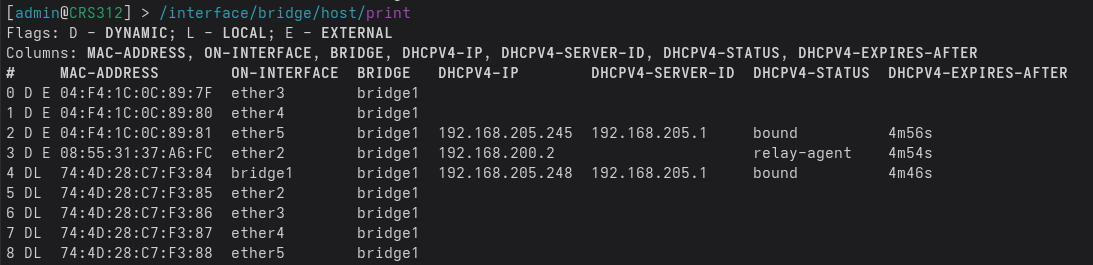

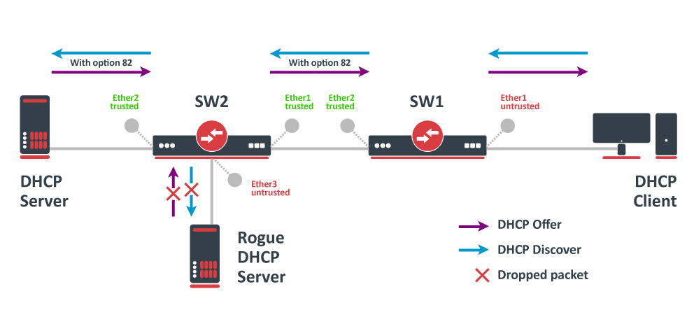

dhcp-snooping (yes | no; Default: no)Enables or disables DHCP Snooping on the bridge.
Caution: Enabling the DHCP snooping feature will turn off bridge fast-path, which in turn affects the ability to fasttrack connections going over that bridge.

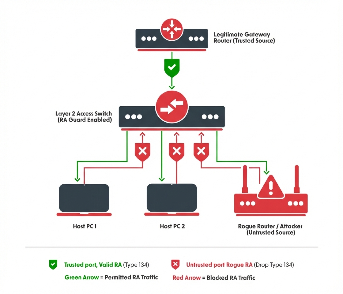

ra-guard (yes | no; Default: no)RA guard - a security feature that validates incoming Router Advertisements against a list of authorized, trusted ports.

trusted-ra (yes | no; Default: no)Specifies whether the port is permitted to forward IPv6 Router Advertisement messages; set to yes for ports connected to legitimate routers and no to block unauthorized sources. This property only has an effect when ra-guard is set to yes.

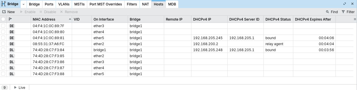

Hosts Table​
The hosts table displays MAC addresses that have been learned on a bridge interface. This table also shows various flags that provide additional information about each host entry. Access the hosts table through the /interface/bridge/host submenu.
Sub-menu: /interface/bridge/host
PropertyDescription
bridge (read-only: name)The bridge to which the host entry belongs
disabled (read-only: flag)Indicates whether the static host entry is disabled
dynamic (read-only: flag)Indicates whether the host was dynamically learned
external (read-only: flag)Indicates whether the host was learned from an external table, such as a switch chip or Wireless registration table. Static host entries added on hardware-offloaded bridge ports do not display this flag
invalid (read-only: flag)Indicates whether the host entry is invalid. This flag may appear for statically configured hosts on an interface that has been removed
local (read-only: flag)Indicates whether the host entry was created from the bridge itself, which displays all local interfaces
mac-address (read-only: MAC address)The MAC address of the host
on-interface (read-only: name)The bridge port to which the host is connected
Monitoring​
To view the active hosts table, use the print command. The table displays all MAC addresses that have been learned on the bridge interface, along with flags indicators and connection details.
[admin@MikroTik] /interface/bridge/host/print
Flags: X - disabled, I - invalid, D - dynamic, L - local, E - external
# MAC-ADDRESS VID ON-INTERFACE BRIDGE
0 D B8:69:F4:C9:EE:D7 ether1 bridge1
1 D B8:69:F4:C9:EE:D8 ether2 bridge1
2 DL CC:2D:E0:E4:B3:38 bridge1 bridge1
3 DL CC:2D:E0:E4:B3:39 ether2 bridge1
The output shows:
  • D flag: Dynamically learned MAC addresses
  • DL flag: Local interface MAC addresses (the bridge itself and its ports interfaces)
  • VID: VLAN ID associated with the host entry
  • ON-INTERFACE: The bridge port where the host was learned
  • BRIDGE: The bridge interface the host belongs to

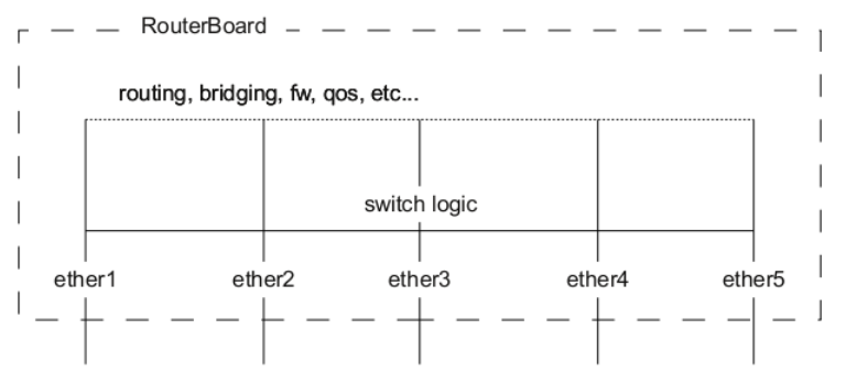

Bridge Hardware Offloading​
It is possible to switch multiple ports together if a device has a built-in switch chip. While a bridge is a software feature that will consume CPU's resources, the bridge hardware offloading will allow you to use the built-in switch chip to forward packets at wire speed. This allows you to achieve higher throughput if configured correctly.
HWoffloading_diagram
A packet that is received by one of the ports always passes through the switch logic first. Switch logic decides which ports the packet should be going to - usually based on the destination MAC address. Hardware-forwarded packets will not be visible to RouterOS (only statistics will show that a packet has passed through). This is because the packet was already processed by the switch chip and never reached the CPU.
Packets can be forwarded to the CPU via the switch CPU port for management access, routing, firewall rules, or traffic control. This requires configuration specific to your device and use case. Check the manual page for your specific device:
danger
Certain bridge and Ethernet port properties are directly related to switch chip settings. Changing such properties can trigger a switch chip reset, temporarily disabling all Ethernet ports. This must be taken into account whenever changing properties in production environments. Such properties include DHCP Snooping, IGMP Snooping, VLAN filtering, L2MTU, Flow Control, and others. The exact settings that can trigger a switch chip reset depend on the device's model.

DHCPv6 Snooping✗
RA Guard✗

MT7621, MT7531, EN7523, RTL8367​
For example: hEX S, hAP ax lite, hEX Refresh, RBM33G, RB4011, RB1100AHx4. See Switch Chip Features.
FeatureHW Offload
STP/RSTP✓
MSTP✓
VLAN Filtering¹✓
IGMP Snooping✗
DHCP Snooping✗
ARP Inspection✗
IP Source Guard✗
DHCPv6 Snooping✗
RA Guard✗
Bonding✗
MLAG✗
Horizon✗
¹ Does not support ether-type=0x88a8 or ether-type=0x9100 (only default ether-type=0x8100 is supported). No tag-stacking=yes support. Using these features disables HW offload.

Bridge host table​
The Bridge host table displays MAC addresses that have been learned on a bridge interface. When vlan-filtering is enabled, the table also shows the VLAN ID associated with each learned MAC address, enabling independent VLAN learning (IVL) mode.
[admin@MikroTik] > /interface/bridge/host/print where !local
0 D CC:2D:E0:E4:B3:AA 300 ether3 bridge1
1 D CC:2D:E0:E4:B3:AB 400 ether4 bridge1

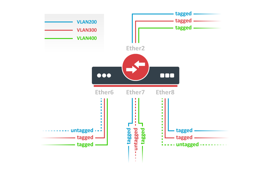

VLAN Example: Trunk and Access Ports​
This section demonstrates how to configure a basic VLAN setup with one trunk port and multiple access ports. The trunk port (ether2) carries tagged VLAN traffic between switches or to a router, while access ports (ether6, ether7, ether8) connect to end devices and use untagged VLAN traffic.
access_ports
Step 1: Create the Bridge Interface​
Create a bridge interface with vlan-filtering disabled. This is important because enabling VLAN filtering immediately restricts traffic, which could lock you out of the device before the configuration is complete. For detailed information on managing access to the device during VLAN configuration, refer to the Management access configuration section.
/interface/bridge
add name=bridge1 vlan-filtering=no
Step 2: Add Bridge Ports and Configure PVID​
Add the physical interfaces to the bridge and configure the Port VLAN ID (pvid) for access ports. The pvid determines which VLAN untagged traffic is assigned to when entering the bridge. The frame-types setting controls what kind of traffic each port accepts: tagged only, untagged only, or both.
/interface/bridge/port
add bridge=bridge1 interface=ether2 frame-types=admit-only-vlan-tagged
add bridge=bridge1 interface=ether6 pvid=200 frame-types=admit-only-untagged-and-priority-tagged
add bridge=bridge1 interface=ether7 pvid=300 frame-types=admit-only-untagged-and-priority-tagged
add bridge=bridge1 interface=ether8 pvid=400 frame-types=admit-only-untagged-and-priority-tagged
Step 3: Create Bridge VLAN Table Entries​
Create the bridge VLAN table entries. The trunk port (ether2) must be configured as a tagged member, meaning it will send and receive frames with VLAN tags. Access ports are automatically added as untagged members based on their pvid setting, so you only need to specify the tagged port in each VLAN entry.
/interface/bridge/vlan
add bridge=bridge1 tagged=ether2 vlan-ids=200
add bridge=bridge1 tagged=ether2 vlan-ids=300
add bridge=bridge1 tagged=ether2 vlan-ids=400
Step 4: Enable VLAN Filtering​
Once all VLAN settings are configured, enable VLAN filtering on the bridge to activate the VLAN functionality.
/interface/bridge/set bridge1 vlan-filtering=yes
Step 5: (Optional) Reject Untagged Traffic​
As an optional security measure, you can set the bridge to reject untagged traffic by changing the frame-type. This prevents the default VLAN 1 (pvid=1) from being used and ensures only properly tagged traffic is accepted.
/interface/bridge/set bridge1 frame-types=admit-only-vlan-tagged
VLAN Example - Trunk and Hybrid Ports​
hybrid_ports
Create a bridge with disabled vlan-filtering to avoid losing access to the router before VLANs are completely configured. If you need management access to the bridge, see the Management access configuration section.
/interface/bridge
Add bridge ports and specify pvid on hybrid VLAN ports to assign untagged traffic to the intended VLAN. Use the frame-types setting to accept only tagged packets on ether2.
Add Bridge VLAN entries and specify tagged ports in them. In this example, egress VLAN tagging is done on ether6, ether7, ether8 ports too, making them into hybrid ports. Bridge ports with frame-types set to admit-all will be automatically added as untagged ports for the pvid VLAN.
add bridge=bridge1 tagged=ether2,ether7,ether8 vlan-ids=200
add bridge=bridge1 tagged=ether2,ether6,ether8 vlan-ids=300
add bridge=bridge1 tagged=ether2,ether6,ether7 vlan-ids=400
In the end, when VLAN configuration is complete, enable Bridge VLAN Filtering.
An Optional step is to set frame-types=admit-only-vlan-tagged on the bridge interface in order to disable the default untagged VLAN 1 (pvid=1).
danger
You don't have to add access ports as untagged ports, because they will be added dynamically as untagged ports with the VLAN ID that is specified in pvid, you can specify just the trunk port as a tagged port. All ports that have the same pvid set will be added as untagged ports in a single entry. You must take into account that the bridge itself is a port and it also has a pvid value, this means that the bridge port also will be added as an untagged port for the ports that have the same pvid. You can circumvent this behavior by either setting different pvid on all ports (even the trunk port and bridge itself), or using frame-type set to accept-only-vlan-tagged.

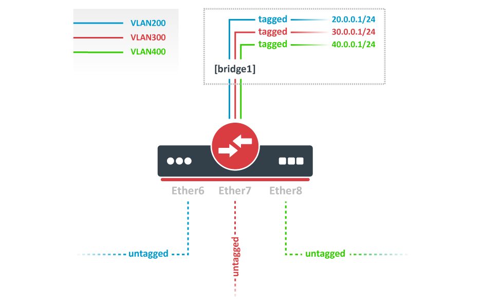

VLAN Example - InterVLAN Routing by Bridge​
vlan_routing
/interface/bridge
Add bridge ports and specify pvid for VLAN access ports to assign their untagged traffic to the intended VLAN. Use the frame-types setting to accept only untagged packets.
Add Bridge VLAN entries and specify tagged ports in them. In this example bridge1 interface is the VLAN trunk that will send traffic further to do InterVLAN routing. Bridge ports with frame-types set to admit-only-untagged-and-priority-tagged will be automatically added as untagged ports for the pvid VLAN.
add bridge=bridge1 tagged=bridge1 vlan-ids=200
add bridge=bridge1 tagged=bridge1 vlan-ids=300
add bridge=bridge1 tagged=bridge1 vlan-ids=400
Configure VLAN interfaces on the bridge1 to allow handling of tagged VLAN traffic at the routing level and set IP addresses to ensure routing between VLANs as planned.
/interface/vlan
add interface=bridge1 name=VLAN200 vlan-id=200
add interface=bridge1 name=VLAN300 vlan-id=300
add interface=bridge1 name=VLAN400 vlan-id=400
/ip/address
add address=20.0.0.1/24 interface=VLAN200
add address=30.0.0.1/24 interface=VLAN300
add address=40.0.0.1/24 interface=VLAN400
In the end, when VLAN configuration is complete, enable Bridge VLAN Filtering:
An optional step is to set frame-types=admit-only-vlan-tagged on the bridge interface in order to disable the default untagged VLAN 1 (pvid=1).
Since RouterOS v7, it is possible to route traffic using L3 HW offloading on certain devices. See more details on L3 Hardware Offloading.

DHCP Snooping and DHCP Option 82​
DHCP Snooping and DHCP Option 82 are supported by bridge. The DHCP Snooping is a Layer2 security feature that prevents unauthorized DHCP servers from providing malicious information to users. In RouterOS, you can specify which bridge ports are trusted (where a known DHCP server resides and DHCP messages should be forwarded) and which are untrusted (usually used for access ports, received DHCP server messages will be dropped). The DHCP Option 82 is additional information (Agent Circuit ID and Agent Remote ID) provided by DHCP Snooping enabled devices that allows identifying the device itself and DHCP clients.
Dhcp_snooping
In this example, SW1 and SW2 are DHCP Snooping and Option 82-enabled devices. First, we need to create a bridge, assign interfaces and mark trusted ports. Use these commands on SW1:
/interface/bridge
add name=bridge
add bridge=bridge interface=ether1
add bridge=bridge interface=ether2 trusted=yes
For SW2, the configuration will be similar, but we also need to mark ether1 as trusted, because this interface is going to receive DHCP messages with Option 82 already added. You need to mark all ports as trusted if they are going to receive DHCP messages with added Option 82, otherwise these messages will be dropped. Also, we add ether3 to the same bridge and leave this port untrusted, imagining there is an unauthorized (rogue) DHCP server. Use these commands on SW2:
/interface/bridge
add name=bridge
add bridge=bridge interface=ether1 trusted=yes
add bridge=bridge interface=ether3
Then we need to enable DHCP Snooping and configure Option 82. Starting from RouterOS version 7.23, it is possible to configure custom Remote ID and Circuit ID values using predefined variables (such as BRIDGEMAC, HOSTNAME, INTERFACE, VID). See the dhcp-agent-circuit-id, dhcp-agent-remote-id properties for more details. In case your DHCP server does not support DHCP Option 82 or you do not implement any Option 82-related policies, this step is not mandatory. In this configuration example, we are using these commands on SW1 and SW2:
/interface/bridge
set [find where name="bridge"] dhcp-snooping=yes dhcp-agent-circuit-id="interface: \$(INTERFACE), vlan: \$(VID)" dhcp-agent-remote-id="ip: 192.168.88.1, identity: \$(HOSTNAME), mac: \$(BRIDGEMAC)"
Now both devices will analyze what DHCP messages are received on bridge ports. The SW1 is responsible for adding and removing the DHCP Option 82. The SW2 will limit rogue DHCP servers from receiving any discovery messages and drop malicious DHCP server messages from ether3.

The active DHCP binding table entries in Winbox:
FDB with DHCP binding table in Winbox
The active DHCP binding table entries in console:
FDB with DHCP binding table in console
ARP Inspection and IP Source Guard​
ARP Inspection and IP Source Guard are Layer 2 security features that use the DHCP snooping binding table to prevent address spoofing attacks. ARP Inspection validates ARP packets against the binding database, dropping any that do not match. IP Source Guard validates the source IP address of IPv4 packets, dropping those not found in a binding entry for the ingress port. On trusted ports, all ARP packets and IP traffic are forwarded without verification.
First, enable DHCP snooping on the bridge and mark the ports connected to your DHCP server as trusted:
/interface/bridge/set [find name="bridge1"] dhcp-snooping=yes
/interface/bridge/port/set [find interface=ether1] trusted=yes
Enable ARP inspection and designate trusted ARP ports:
/interface/bridge/set [find name="bridge1"] arp-inspection=yes
/interface/bridge/port/set [find interface=ether1] trusted-arp=yes
Enable IP Source Guard:
/interface/bridge/set [find name="bridge1"] ip-source-guard=yes
danger
The DHCP snooping binding table is cleared whenever the bridge interface configuration is changed, including enabling the arp-inspection or ip-source-guard features. As a result, IPv4 and ARP traffic on untrusted ports is interrupted until clients obtain or renew their DHCP leases. To repopulate the binding table more quickly, disable and re-enable the untrusted Ethernet interfaces or reboot the switch.
Print the bridge host table to verify that DHCP bindings are being learned:
/interface/bridge/host/print where dhcpv4-status

RA Guard​
The RA guard feature is intended for discarding IPv6 packets containing router advertisement (RA) messages arriving on bridge ports specified by the user as untrusted ones, thereby allowing one to prevent potential rogue RA message-based attacks or accidental network misconfiguration. When enabled, it is possible to set each bridge port either as trusted or untrusted (by default all the bridge ports are set as RA untrusted).
Here are the network scheme and core principle behind IPv6 RA Guard (Router Advertisement Guard).
RAguard
#Layer 2 Access Switch - enabling RA guard on the main bridge
/interface/bridge
add name=bridge
/interface/bridge
set [find where name="bridge"] ra-guard=yes
add bridge=bridge interface=etherUplink Trusted RA=yes
add bridge=bridge interface=etherX
add bridge=bridge interface=etherY
add bridge=bridge interface=etherZ
The Problem: Why is this needed?​
In IPv6, devices use ICMPv6 to auto-configure themselves.
Router Advertisements (Type 134): Routers broadcast these messages to tell hosts: "I am the gateway, and here is your network prefix."
The Threat: If a user accidentally connects a consumer router (like a home Wi-Fi router) or a malicious actor launches a tool (like Rogue RA) on an access port, that device will start broadcasting RAs.
The Result: Other hosts on the network will auto-configure their IPv6 addresses based on the rogue device and set the rogue device as their default gateway. This causes a Man-in-the-Middle attack or a complete denial of service.
Here is the network scheme and the core principle behind IPv6 RA Guard (Router Advertisement Guard).
The Core Principle: "Trust vs. Untrust"​
The fundamental principle of IPv6 RA Guard is logically identical to DHCP Snooping in IPv4. It creates a security boundary within the Layer 2 switch infrastructure by categorizing switch ports into two roles:
  • Trusted Ports: Ports connected to legitimate, authorized IPv6 routers. These ports are allowed to send Router Advertisement (RA) packets.
  • Untrusted Ports: Ports connected to end-user hosts. These ports are blocked from sending RA packets.
Packet parsing process​
For ports not configured as RA Trusted, the RA Guard parser traverses the extension header chain until it encounters a non-extension header. The parsing process and subsequent actions are governed by the following rules:
Transport Layer Termination: If the parser encounters a valid transport layer header—such as TCP, UDP, ESP, RSVP, or an encapsulated IPv4/IPv6 header—parsing terminates and the packet is forwarded (subject to standard bridge checks).
  • Drop Conditions - The packet is discarded if:
  1. It fails to contain a transport layer header.
  2. The final extension header in the chain does not specify NO_NEXT_HEADER (59) in its "Next Header" field.
  3. If the ICMP message type is found to be 134, the packet is dropped.
  • Fragmentation Handling: These parsing rules apply exclusively to the first fragment of fragmented IPv6 packets. Subsequent fragments are forwarded regardless of their content, as they do not contain the protocol headers necessary for RA identification.
