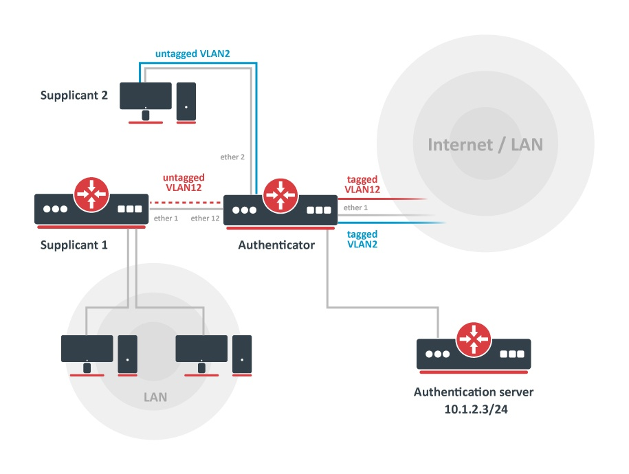

Port based VLAN ID assignment​
It is possible to assign an authenticated interface to a specific VLAN ID using bridge VLAN filtering. This can be done using RADIUS Tunnel-Type, Tunnel-Medium-Type and Tunnel-Private-Group-ID attributes. Note that only devices with hardware offloaded VLAN filtering will be able to do this in the switch chip.
First of all, make sure the interface is added to a bridge which has VLAN filtering enabled.
/interface/bridge
add name=bridge1 vlan-filtering=yes
/interface/bridge/port
add bridge=bridge1 interface=ether2
add bridge=bridge1 interface=ether12
It is necessary to add static VLAN configuration for tagged VLAN traffic to be sent over the ether1 interface.
/interface/bridge/vlan
add bridge=bridge1 tagged=ether1 vlan-ids=2
add bridge=bridge1 tagged=ether1 vlan-ids=12
With enabled RADIUS debug logs it is possible to see complete RADIUS message packets with all attributes. In our example, Tunnel attributes are received in the Access-Accept message from the RADIUS server:
09:51:45 radius,debug,packet received Access-Accept with id 64 from 10.1.2.3:1812
09:51:45 radius,debug,packet Tunnel-Type = 13
09:51:45 radius,debug,packet Tunnel-Medium-Type = 6
09:51:45 radius,debug,packet Tunnel-Private-Group-ID = "12"
09:51:45 radius,debug,packet User-Name = "dot1x-user"
The VLAN ID is now present in the active session list and untagged ports are added to the previously created static VLAN configuration.
/interface/dot1x/server/active/print
0 interface=ether12 username="dot1x-user" client-mac=00:0C:42:EB:71:F6 session-id="86b00006" vlan-id=12
/interface/bridge/vlan/print detail
Flags: X - disabled, D - dynamic
0 D bridge=bridge1 vlan-ids=1 tagged="" untagged="" current-tagged="" current-untagged=bridge1,ether3
1 bridge=bridge1 vlan-ids=2 tagged=ether1 untagged="" current-tagged=ether1 current-untagged=ether2
2 bridge=bridge1 vlan-ids=12 tagged=ether1 untagged="" current-tagged=ether1 current-untagged=ether12
