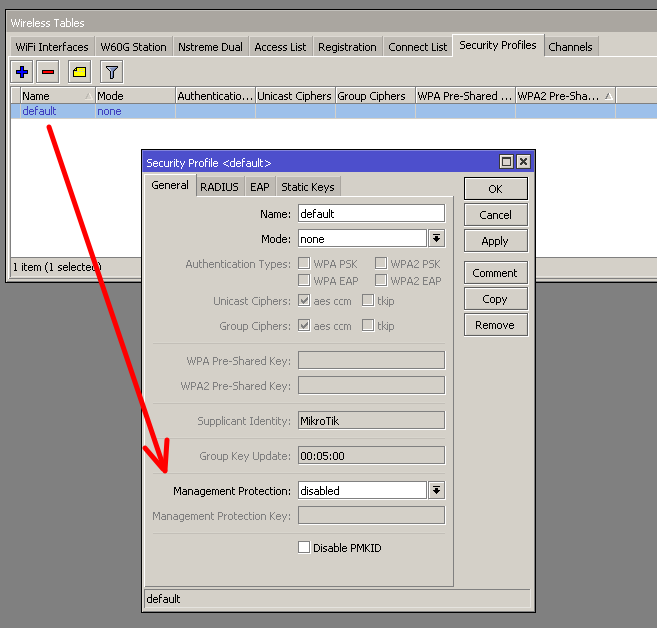

Security Profiles
Sub-menu: /interface/wireless/security-profiles
Security profiles are configured under the /interface/wireless/security-profiles path in the console, or in the "Security Profiles" tab of the "Wireless" window in WinBox. Security profiles are referenced by the Wireless interface security-profile property and the security-profile property of Connect Lists.
Basic properties
PropertyDescription
mode (none | static-keys-optional | static-keys-required | dynamic-keys; Default: none)Encryption mode for the security profile.
  • none - Encryption is not used. Encrypted frames are not accepted.
  • static-keys-required - WEP mode. Does not accept and does not send unencrypted frames. The station in static-keys-required mode will not connect to an Access Point in static-keys-optional mode.
  • static-keys-optional - WEP mode. Supports encryption and decryption, but also allows to receive and send unencrypted frames. The device will send unencrypted frames if the encryption algorithm is specified as none. The station in static-keys-optional mode will not connect to an Access Point in static-keys-required mode. See also: static-sta-private-algo, static-transmit-key.
  • dynamic-keys - WPA mode.
name (text; Default: )Name of the security profile
WPA properties

Management frame protection
Used for: Deauthentication attack prevention, MAC address cloning issue.
RouterOS implements a proprietary management frame protection algorithm based on a shared secret. Management frame protection means that a RouterOS wireless device is able to verify the source of a management frame and confirm that a particular frame is not malicious. This feature allows withstanding deauthentication and disassociation attacks on RouterOS based wireless devices.
Management protection mode is configured in security-profile with the management-protection setting. Possible values are: disabled - management protection is disabled (default), allowed - use management protection if supported by the remote party (for AP - allow both non-management protection and management protection clients, for client - connect to APs both with and without management protection), required - establish association only with remote devices that support management protection (for AP - accept only clients that support management protection, for client - connect only to APs that support management protection).
The Management protection shared secret is configured with the security-profile management-protection-key setting.
When an interface is in AP mode, default management protection key (configured in security-profile) can be overridden by a key specified in access-list or RADIUS attribute.
[admin@mikrotik] /interface/wireless/security-profiles> print
0 name="default" mode=none authentication-types="" unicast-ciphers=""
group-ciphers="" wpa-pre-shared-key="" wpa2-pre-shared-key=""
supplicant-identity="n-str-p46" eap-methods=passthrough
tls-mode=no-certificates tls-certificate=none static-algo-0=none
static-key-0="" static-algo-1=none static-key-1="" static-algo-2=none
static-key-2="" static-algo-3=none static-key-3=""
static-transmit-key=key-0 static-sta-private-algo=none
static-sta-private-key="" radius-mac-authentication=no
radius-mac-accounting=no radius-eap-accounting=no interim-update=0s
radius-mac-format=XX:XX:XX:XX:XX:XX radius-mac-mode=as-username
radius-mac-caching=disabled group-key-update=5m
management-protection=disabled management-protection-key=""
[admin@mikrotik] /interface/wireless/security-profiles> set default management-protection=
allowed disabled required

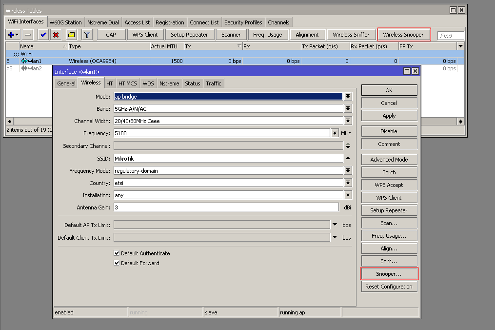

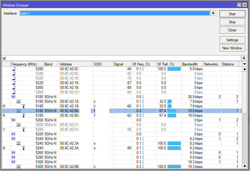

Snooper
This tool monitors surrounding frequency usage, and displays which devices occupy each frequency. It's available both in console and in WinBox. Snooper will use frequencies from scan-list.
Sub-menu: /interface/wireless/snooper
Settings
Spectral scan
