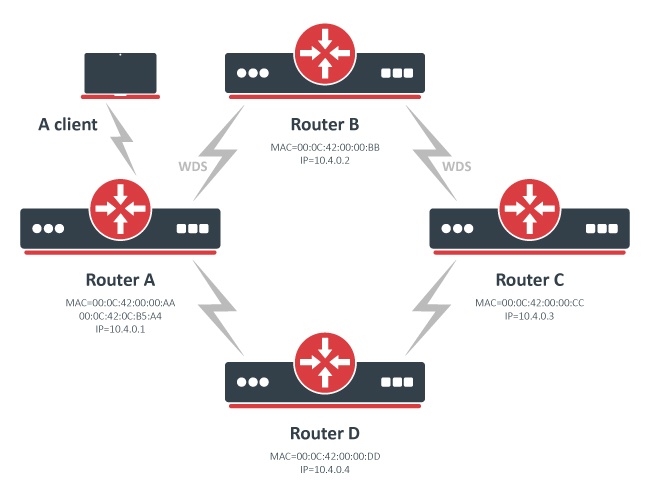

This example uses static WDS links that are dynamically added as mesh ports when they become active. Two different frequencies are used: one for AP interconnections, and one for client connections to APs, so the AP must have at least two wireless interfaces. Of course, the same frequency for all connections also could be used, but that might not work as well because of potential interference issues.
Repeat this configuration on all APs:
/interface/mesh/add disabled=no
/interface/mesh/port/add interface=wlan1 mesh=mesh1
/interface/mesh/port/add interface=wlan2 mesh=mesh1
# interface used for AP interconnections
/interface/wireless/set wlan1 disabled=no ssid=mesh frequency=2437 band=2ghz-b/g/n mode=ap-bridge \
wds-mode=static-mesh wds-default-bridge=mesh1
# interface used for client connections
/interface/wireless/set wlan2 disabled=no ssid=mesh-clients frequency=5180 band=5ghz-a/n/ac mode=ap-bridge
# a static WDS interface for each AP you want to connect to
/interface/wireless/wds/add disabled=no master-interface=wlan1 name=<descriptive name of remote end> \
wds-address=<MAC address of remote end>
Here a WDS interface is added manually because static WDS mode is used. If you are using wds-mode=dynamic-mesh, all WDS interfaces will be created automatically. The frequency and band parameters are specified here only to produce a valid example configuration; mesh protocol operations are by no means limited to or optimized for these particular values.
warning
You may want to increase the disconnect-timeout wireless interface option to make the protocol more stable.
In real-world setups you also should take care of securing the wireless connections, using /interface/wireless/security-profile. For simplicity, that configuration is not shown here.
Results on router A (there is one client connected to wlan2):
[admin@A] > /interface/mesh/print
0 R name="mesh1" mtu=1500 arp=enabled mac-address=00:0C:42:0C:B5:A4 auto-mac=yes
admin-mac=00:00:00:00:00:00 mesh-portal=no hwmp-default-hoplimit=32
hwmp-preq-waiting-time=4s hwmp-preq-retries=2 hwmp-preq-destination-only=yes
hwmp-preq-reply-and-forward=yes hwmp-prep-lifetime=5m hwmp-rann-interval=10s
hwmp-rann-propagation-delay=1s hwmp-rann-lifetime=22s
[admin@A] > /interface/mesh/port/print detail
Flags: X - disabled, I - inactive, D - dynamic
0 interface=wlan1 mesh=mesh1 path-cost=10 hello-interval=10s port-type=auto port-type-used=wireless
1 interface=wlan2 mesh=mesh1 path-cost=10 hello-interval=10s port-type=auto port-type-used=wireless
2 D interface=router_B mesh=mesh1 path-cost=105 hello-interval=10s port-type=auto port-type-used=WDS
3 D interface=router_D mesh=mesh1 path-cost=76 hello-interval=10s port-type=auto port-type-used=WDS
The FDB (Forwarding Database) at the moment contains information only about local MAC addresses, non-mesh nodes reachable through a local interface, and direct mesh neighbors:
[admin@A] /interface/mesh/fdb/print
Flags: A - active, R - root
MESH TYPE MAC-ADDRESS ON-INTERFACE LIFETIME AGE
A mesh1 local 00:0C:42:00:00:AA 3m17s
A mesh1 neighbor 00:0C:42:00:00:BB router_B 1m2s
A mesh1 neighbor 00:0C:42:00:00:DD router_D 3m16s
A mesh1 direct 00:0C:42:0C:7A:2B wlan2 2m56s
A mesh1 local 00:0C:42:0C:B5:A4 2m56s
[admin@A] /interface/mesh/fdb/print detail
A mac-address=00:0C:42:00:00:AA type=local age=3m21s mesh=mesh1 metric=0 seqnum=4294967196
A mac-address=00:0C:42:00:00:BB type=neighbor on-interface=router_B age=1m6s mesh=mesh1 metric=132 seqnum=4294967196
A mac-address=00:0C:42:00:00:DD type=neighbor on-interface=router_D age=3m20s mesh=mesh1 metric=79 seqnum=4294967196
A mac-address=00:0C:42:0C:7A:2B type=direct on-interface=wlan2 age=3m mesh=mesh1 metric=10 seqnum=0
A mac-address=00:0C:42:0C:B5:A4 type=local age=3m mesh=mesh1 metric=0 seqnum=0
Test if ping works:
[admin@A] > /ping 00:0C:42:00:00:CC
00:0C:42:00:00:CC 64 byte ping time=108 ms
00:0C:42:00:00:CC 64 byte ping time=51 ms
00:0C:42:00:00:CC 64 byte ping time=39 ms
00:0C:42:00:00:CC 64 byte ping time=43 ms
4 packets transmitted, 4 packets received, 0% packet loss
round-trip min/avg/max = 39/60.2/108 ms
Router A had to discover a path to Router C first, hence the slightly larger time for the first ping. Now the FDB also contains an entry for 00:0C:42:00:00:CC, with type "mesh".
Also, test that ARP resolving works and so does IP level ping:
[admin@A] > /ping 10.4.0.3
10.4.0.3 64 byte ping: ttl=64 time=163 ms
10.4.0.3 64 byte ping: ttl=64 time=46 ms
10.4.0.3 64 byte ping: ttl=64 time=48 ms
3 packets transmitted, 3 packets received, 0% packet loss
round-trip min/avg/max = 46/85.6/163 ms

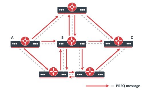

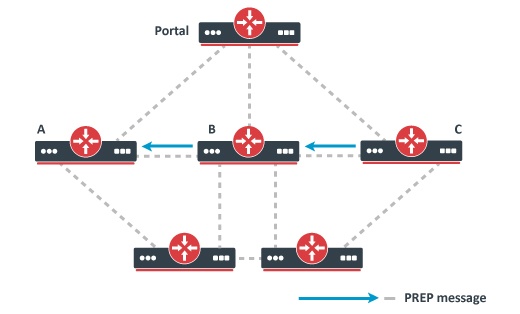

Reactive mode

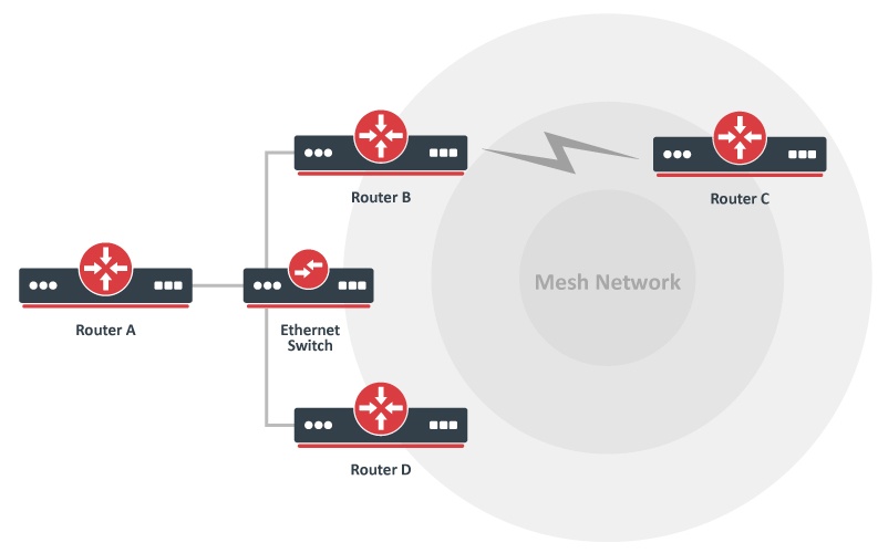

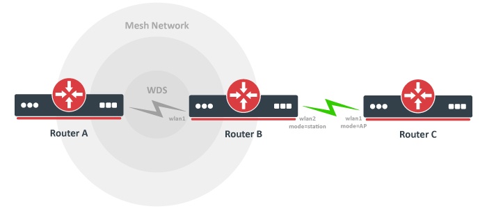

Router A wants to discover a path to C:
Router C sends a unicast response to A:
In reactive mode, HWMP+ is very much like AODV (Ad-hoc On-demand Distance Vector). All paths are discovered on-demand, by flooding Path Request (PREQ) messages in the network. The destination node or some router that has a path to the destination will reply with a Path Response (PREP). Note that if the destination address belongs to a client, the AP this client is connected to will serve as a proxy for him (i.e. reply to PREQs on his behalf).

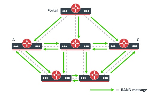

The root announces itself by flooding RANN:

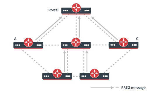

Internal nodes respond with PREGs:
In proactive mode, there are some routers configured as portals. In general, being a portal means that the router has interfaces to some other network, i.e. it is an entry/exit point to the mesh network.
The portals will announce their presence by flooding the Root Announcement (RANN) message in the network. Internal nodes will reply with a Path Registration (PREG) message. The result of this process will be routing trees with roots in the portal.
Routes to portals will serve as a kind of default route. If an internal router does not know the path to a particular destination, it will forward all data to its closest portal. The portal will then discover the path on behalf of the router if needed. The data afterward will flow through the portal. This may lead to sub-optimal routing unless the data is addressed to the portal itself or some external network the portals have interfaces to.
A proactive mode is best suited when most of the traffic goes between internal mesh nodes and a few portal nodes.

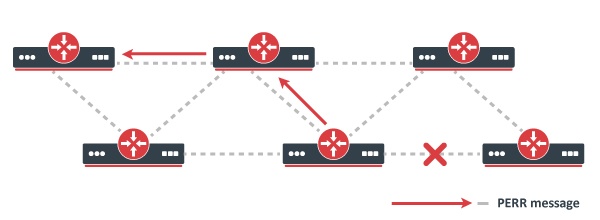

Topology change detection

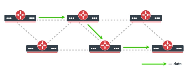

Data flow path:
After the link disappears, an error is propagated upstream:
HWMP+ uses a Path Error (PERR) message to notify that a link has disappeared. The message is propagated to all upstream nodes up to the data source. The source on PERR reception restarts the path discovery process.

Problematic example 1: Ethernet switch inside a mesh
Router A is outside the mesh; all the rest of the routers are inside. For routers B, C, D, all interfaces are added as mesh ports:
Router A will not be able to communicate reliably with router C. The problem manifests itself when D is the designated router for Ethernet; if B takes this role, everything is OK. The main cause of the problem is MAC address learning on the Ethernet switch.
Consider what happens when router A wants to send something to C. We suppose router A either knows or floods data to all interfaces. Either way, data arrives at the switch. The switch, not knowing anything about the destination's MAC address, forwards the data to both B and D.
What happens now:
  1. B receives the packet on a mesh interface. Since the MAC address is not local to B and B knows that he is not the designated router for the Ethernet network, he simply ignores the packet.
  2. D receives the packet on a mesh interface. Since the MAC address is not local to D and D is the designated router for the Ethernet network, he initiates the path discovery process to C.
After path discovery is completed, D has information that C is reachable over B. Now D encapsulates the packet and forwards it back to the Ethernet network. The encapsulated packet is forwarded by the switch, received and forwarded by B, and received by C. So far everything is good.
Now C is likely to respond to the packet. Since B already knows where A is, he will decapsulate and forward the reply packet. But now the switch will learn that the MAC address of C is reachable through B! That means, next time when something arrives from A addressed to C, the switch will forward data only to B (and B, of course, will silently ignore the packet)!
In contrast, if B took up the role of a designated router, everything would be OK, because traffic would not have to go through the Ethernet switch twice.
Troubleshooting: either avoid such a setup or disable MAC address learning on the switch. Note that on many switches that is not possible.
Also note that there will be no problem, if either:
  • Router A supports and is configured to use HWMP+.
  • Or the Ethernet switch is replaced with a router that supports HWMP+ and has Ethernet interfaces added as mesh ports.
Problematic example 2: wireless modes
Consider this (invalid) setup example...Routers A and B are inside the mesh, router C is outside. For routers A and B all interfaces are added as mesh ports:
It is not possible to bridge wlan1 and wlan2 on router B now. The reason for this is pretty obvious if you understand how WDS works. For WDS communications four address frames are used. This is because for wireless multihop forwarding you need to know the addresses of the intermediate hops, as well as the original sender and final receiver. In contrast, non-WDS 802.11 communication includes only three MAC addresses in a frame. That's why it's not possible to do multi-hop forwarding in station mode.
Troubleshooting depends on what you want to achieve:
  1. If you want router C to act as a repeater either for wireless or Ethernet traffic, configure the WDS link between router B and router C, and run mesh routing protocol on all nodes.
  2. In other cases, configure wlan2 on router B in AP mode and WLAN on router C in station mode.
