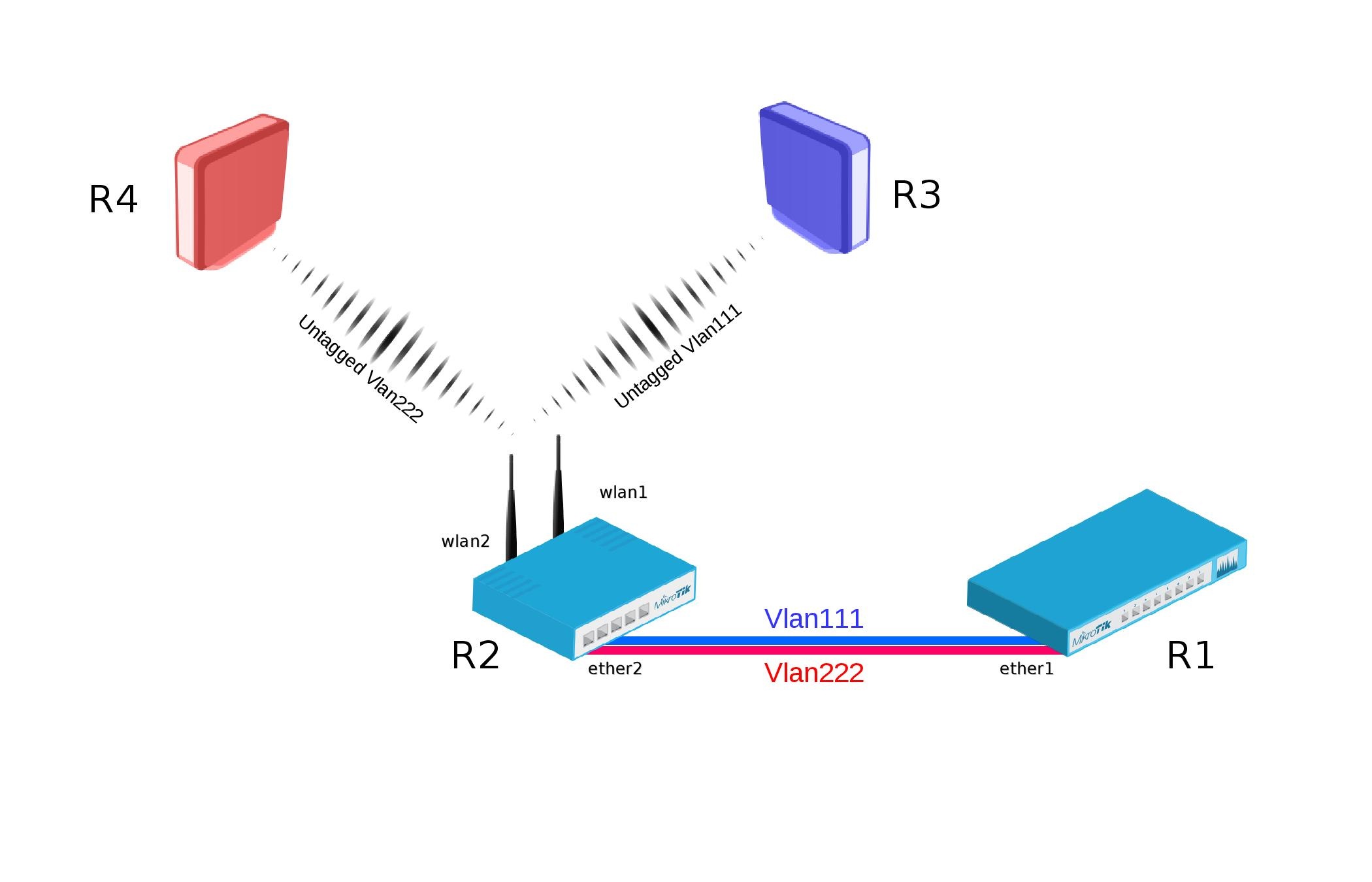

VLANs provide the possibility to isolate devices into different Layer2 segments while still using the same Layer1 medium. This is very useful in setups where you want to separate different types of devices or users. This feature is also very useful for Wireless setups since you can isolate different Virtual APs and restrict access to certain services or networks by using Firewall. Below is an example with a setup with two Access Points on the same device that isolates them into separate VLANs. This kind of scenario is very common when you have a Guest AP and Work AP.

Bridge VLAN Filtering since RouterOS v6.41 provides VLAN aware Layer2 forwarding and VLAN tag modifications within the bridge.
R1
  • Add necessary VLAN interfaces on the ethernet interface to make it a VLAN trunk port. Add ip addresses on VLAN interfaces:
[admin@R1] >
/interface/vlan
add interface=ether1 name=vlan111 vlan-id=111
add interface=ether1 name=vlan222 vlan-id=222
/ip/address
add address=192.168.1.1/24 interface=vlan111
add address=192.168.2.1/24 interface=vlan222
R2
  • Add VirtualAP under the wlan1 interface and create wireless security-profiles for wlan1 and wlan2:
[admin@R2] >
/interface/wireless
set [ find default-name=wlan1 ] disabled=no mode=ap-bridge security-profile=vlan111 ssid=vlan111 vlan-id=111 vlan-mode=use-tag
add disabled=no master-interface=wlan1 name=wlan2 security-profile=vlan222 ssid=vlan222 vlan-id=222 vlan-mode=use-tag
info
It is important to set wlan1,wlan2 vlan-mode to "use-tag".
  • Create a bridge with vlan-filtering=yes;
  • Add necessary bridge ports;
  • Add tagged interfaces under the interface bridge vlan section with correct vlan-ids:
[admin@R2] >
/interface/bridge
add fast-forward=no name=bridge1 vlan-filtering=yes
/interface/bridge/port
add bridge=bridge1 interface=ether2
add bridge=bridge1 interface=wlan1
add bridge=bridge1 interface=wlan2
/interface/bridge/vlan
add bridge=bridge1 tagged=ether2,wlan1 vlan-ids=111
add bridge=bridge1 tagged=ether2,wlan2 vlan-ids=222
warning
Some devices have a built-in switch chip that can switch packets between Ethernet ports with wire-speed performance. Bridge VLAN filtering disables hardware offloading for certain devices, which will prevent packets from being switched. This does not affect Wireless interfaces as traffic through them cannot be offloaded to the switch chip either way.
info
VLAN filtering is not required in this setup, but is highly recommended due to security reasons. Without VLAN filtering it is possible to forward unknown VLAN IDs in certain scenarios. Disabling VLAN filtering does have performance benefits.
