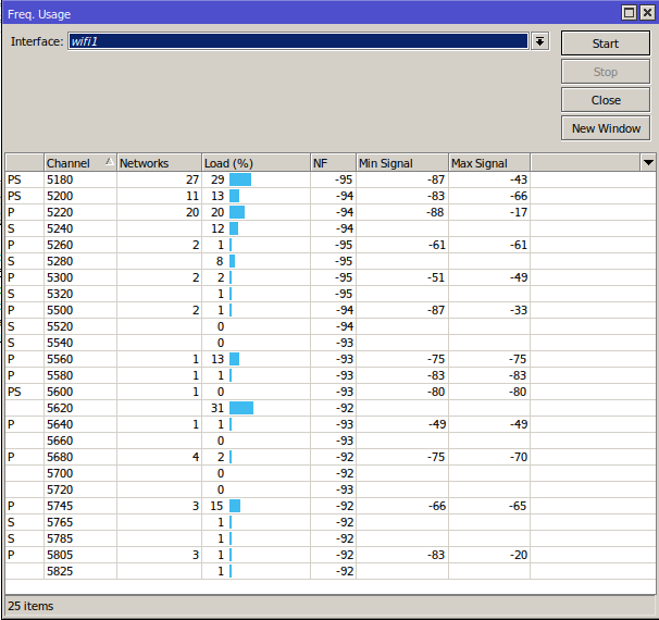

Frequency scan
The /interface/wifi/frequency-scan wifi1 command provides information about RF conditions on available channels that can be obtained by running the frequency-scan command. Used to approximate the spectrum usage, it can be useful to find less crowded frequencies.
info
Running a frequency scan will disconnect all connected clients, or if the interface is in station mode, it will disconnect from the AP.

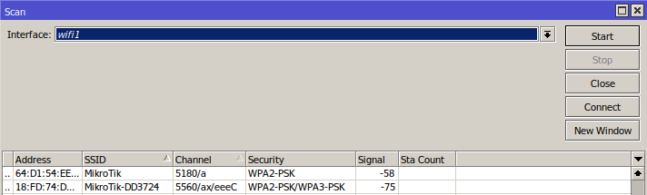

Scan command
The /interface/wifi/scan command will scan for access points and print out information about any APs it detects. It doesn't show the frequency usage, per channel, but it will reveal all access points that are transmitting. You can use the "connect" button to initiate a connection to a specific AP.
The scan command takes all the same parameters as the frequency-scan command.

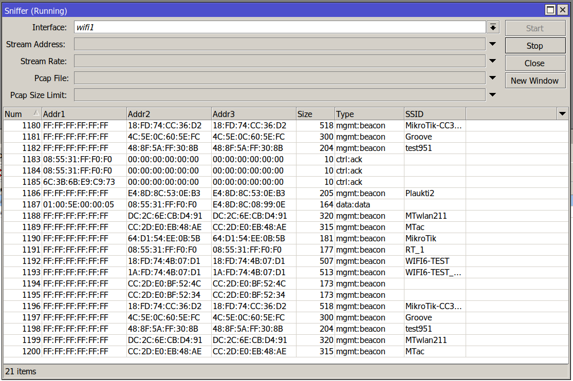

Sniffer
The sniffer command enables monitor mode on a wireless interface. This turns the interface into a passive receiver for all WiFi transmissions.
The command continuously prints out information on received packets and can save them locally to a pcap file or stream them using the TZSP protocol.
The sniffer will operate on whichever channel is configured for the chosen interface.

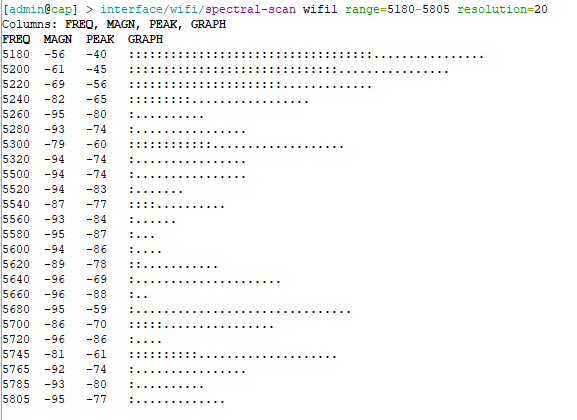

Spectral scan
The spectral scan can scan frequencies supported by your wifi interface, and plot them directly in the console. The spectral scan has been available since the 7.16beta1 version.
info
Spectral scan is supported only by the wifi-qcom driver; it is not supported by the wifi-qcom-ac driver.
/interface/wifi/spectral-scan <wifiinterface name> range=
This command continuously monitors spectral data. This command uses the same data source as spectral-history, and shares many parameters.
To use spectral scan, you must use the range= attribute.
Each line displays one spectrogram bucket -- frequency, magnitude (dBm), peak, and a character graphic bar. A bar shows power value with ':' characters and average peak hold with '.' characters.
data - min/max/avg, by default average is used for data. The average should be used in most scenarios, but in some cases "min" can be useful to check if there are any frequencies that have a constant signal output on them. Max represents the strongest signal that was detected during the interval of the scan, similar to the peak.
duration - terminate command after a specified time. Default is indefinite;
freeze-frame-interval - Time interval at which to update command output
interval - interval of how often to update the primary data values, not peak
peak-mode - avg/max/disabled - peak reflects the strongest signal over peak-hold-duration. By default "avg" is used. It is the average of max values over "peak-hold-duration". If "max" is used, then the highest value will be shown until the next "peak-hold-duration" update.
peak-hold-duration - changes the peak hold duration used by peak-mode, by default 5 seconds.
range - scan specific range, required;
resolution - frequency step for spectral scan
show-interference - yes/no
Possible types of classified interference:
  • Microwave oven (MWO).
  • Continuous Wave (CW).
  • WLAN (Wideband) (WIFI).
  • Cordless phone 2.4 (CORDLESS24).
  • Cordless phone 5 (CORDLESS5).
  • Bluetooth (BLUETOOTH).
  • Frequency hopping spread spectrum (FHSS).

Frequency scan
Information about RF conditions on available channels can be obtained by running the frequency-scan command.
Command parameters:
ParameterDescription
duration (time interval; default: none)Length of time to perform the scan for before exiting. Useful for non-interactive use.
freeze-frame-interval (time interval; default: 1s)Time interval at which to update command output.
frequency (list of frequencies/ranges)Frequencies to perform the scan on. See channel.frequency parameter syntax above for more detail. Defaults to all supported frequencies.
number (string; default: none)Either the name or internal id of the interface to perform the scan with. Required.
rounds (integer; default: none)Number of times to go through the list of scannable frequencies before exiting. Useful for non-interactive use.
save-file (string; default: none)Name of the file to save output to.
Output parameters:
channel (integer)Frequency (in MHz) of the channel scanned.
networks (integer)Number of access points detected on the channel.
load (integer*)*Percentage of time the channel was busy during the scan.
nf (integer)Noise floor (in dBm) of the channel.
max-signal (integer)Maximum signal strength (in dBm) of APs detected in the channel.
min-signal (integer)Minimum signal strength (in dBm) of APs detected in the channel.
primary (boolean) (P)Channel is in use as the primary (control) channel by an AP.
secondary (boolean) (S)Channel is in use as a secondary (extension) channel by an AP.

Scan command
The /interface/wifi/scan command will scan for access points and print out information about any APs it detects. The scan command takes all the same parameters as the frequency-scan command.
Output parameters:
active (boolean) (A)This signifies that beacons from the AP have been received in the last 30 seconds.
address (MAC)The MAC address (BSSID) of the AP.
channel (string)The control channel frequency used by the AP, its supported wireless standards and control/extension channel layout.
security (string)Authentication methods supported by the AP.
signal (integer)The signal strength of the AP's beacons (in dBm).
ssid (string)The extended service set identifier of the AP.
sta-count (integer)The number of client devices associated with the AP. It is only available if the AP includes this information in its beacons.
Sniffer
Command parameters:
ParametersDescription
duration (time interval;default: none)Automatically interrupt the sniffer after the specified time has passed.
filter (string)A string that specifies a filter to apply to captured frames. Only frames matched by the filter expression will be displayed, saved or streamed.
This works similarly to filter strings in libpcap, for example.
The filter can match
  • Address fields (addr1, addr2, addr3)
  • Wireless frame type and subtype, including shortcuts such as 'beacon' (type == 0 && subtype == 8)
  • Flags (to-ds, from-ds, retry, power, protected)
A string can include the following operators:
  • == (exact match)
  • != (does not equal)
  • && (logical AND)
  • || (logical OR)
  • () (for grouping filter expressions)
number (interface)
Interface to use for sniffing.
pcap-file (string)Save captured frames to a file with the given name. No default value (captured frames are not saved to a file by default).
pcap-size-limit (integer; default: none)File size limit (in bytes) when storing captured frames locally. When this limit has been reached, no new frames are added to the capture file.
stream-address (IP address; default: none)Stream captured packets via the TZSP protocol to the given address. No default value (captured packets are not streamed anywhere by default).
stream-rate (integer)Limit the rate (in packets per second) at which captured frames are streamed via TZSP.

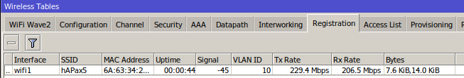

Registration table
The registration table contains read-only information about associated wireless devices.
authorized (boolean) (A)True when the peer has successfully authenticated.
auth-type (string)Authentication type used for the particular client.
band(string)Band on which particular router is communicating with the AP.
bytes (list of integers)Number of bytes in packets transmitted to a peer and received from it.
interface (string)Name of the interface, which was used to associate with the peer.
last-activity(time)last interface data tx/rx activity
mac-address (MAC)The MAC address of the peer.
packets (list of integers)Number of packets transmitted to a peer and received from it.
tx-bits-per-second (integer)Rate of transmitted data to peer per second.
rx-bits-per-second (integer)Rate of received data from peer per second.
rx-rate (string)Bitrate of received transmissions from peer.
signal (integer)Strength of signal received from the peer (in dBm).
ssid (string)The SSID on which the client is connected.
tx-rate (string)Bitrate used for transmitting to the peer.
uptime (time interval)Time since association.
vlan-id (integer)VLAN which is assigned by AP or RADIUS for the particular peer traffic.
