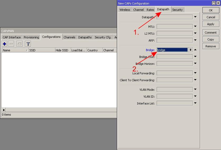

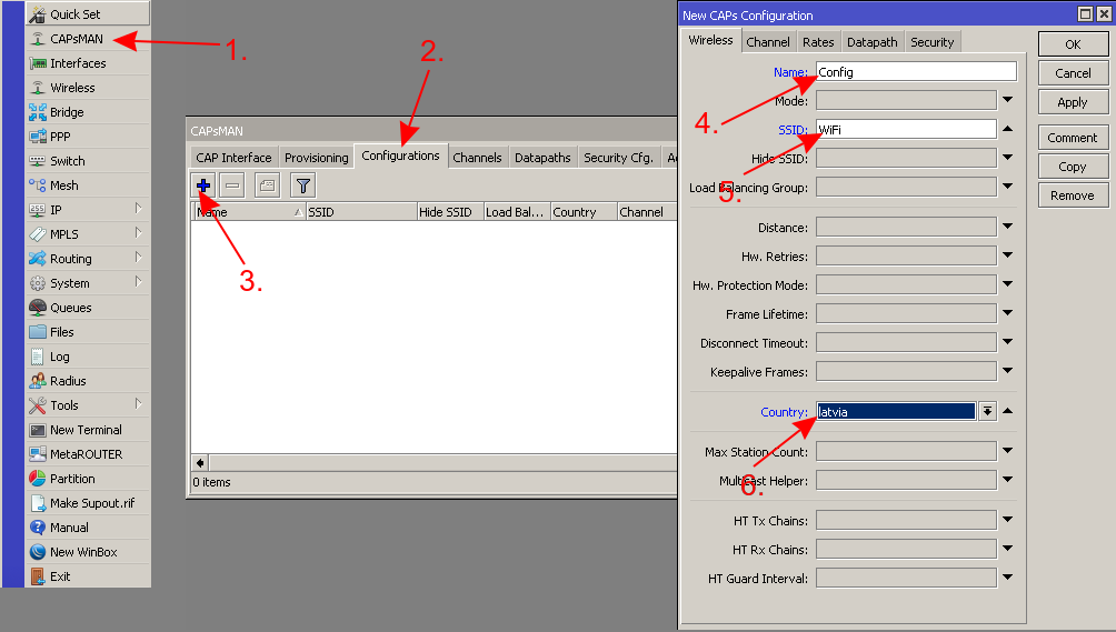

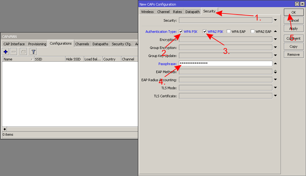

On the central device, which will be your CAPsMAN server, create a new "Configuration" template with only the basic settings (network name, country, the local LAN bridge interface, the wireless password):
Add a new configuration profile:

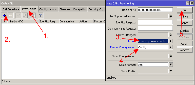

Then create a new "Provisioning" rule, which will assign the created configuration template to the CAP devices:

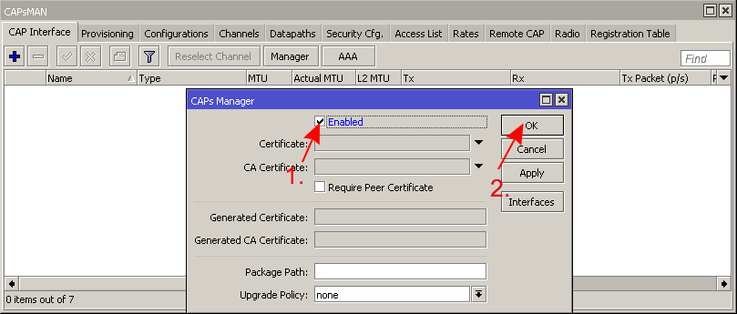

All that remains to do on the CAPsMAN is to enable it:

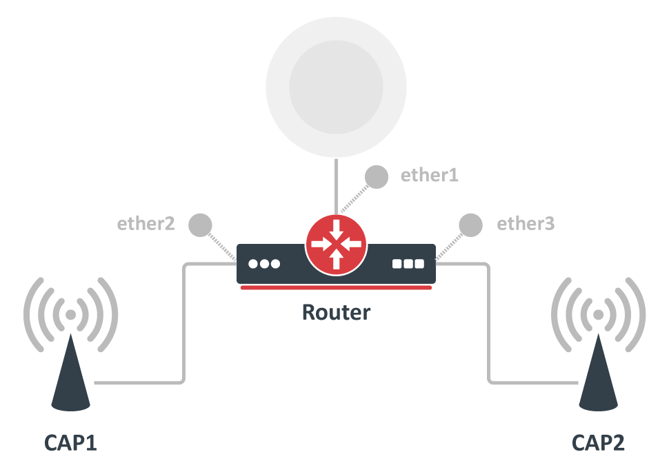

Most MikroTik AP devices already support CAP mode out of the box, all you need to do is make sure they are on the same network as your CAPsMAN, and then boot them up, while holding the reset button.
So, for example, connect the CAP device to one of the CAPsMAN device LAN ports while it is turned off, then hold the reset button, and power on the CAP device. Keep holding the button until the User LED turns solid, then release to turn on CAP mode. The device will now look for a CAPsMAN server (total time to hold the button, around 10 seconds).
The device will now show up in the CAPsMAN "Remote CAP" menu and will be "provisioned" with the configuration template, as per the provisioning settings. For more details on how to manually adjust all settings, keep reading this document.

To get the active provisioning matchers:
[admin@CM] /caps-man/provisioning> print
Flags: X - disabled
0 radio-mac=00:00:00:00:00:00 action=create-enabled master-configuration=main-cfg
slave-configurations=virtual-ap-cfg name-prefix=""

Configuration profiles permit pre-defined 'top level' master settings to be applied to CAP radios being provisioned.
Configuration Profiles are configured in the /caps-man/configuration menu:
PropertyDescription
channel (list; Default: )User defined list taken from Channel names (/caps-man/channels)
channel.band (2ghz-b | 2ghz-b/g | 2ghz-b/g/n | 2ghz-onlyg | 2ghz-onlyn | 5ghz-a | 5ghz-a/n | 5ghz-onlyn | 5ghz-a/n/ac | 5ghz-only-ac; Default: )Defines a set of used channels.
channel.control-channel-width (40mhz-turbo | 20mhz | 10mhz | 5mhz; Default: )Defines a set of used channel widths.
channel.extension-channel (Ce | Ceee | eC | eCee | eeCe | eeeC | xx | xxxx | disabled; Default: )Extension channel configuration. (E.g. Ce = extension channel is above Control channel, eC = extension channel is below Control channel)
channel.frequency (integer [0..4294967295]; Default: )Channel frequency value in MHz on which the AP will operate. If left blank, CAPsMAN will automatically determine the best frequency that is least occupied.
channel.reselect-interval (time [00:00:00]; [00:00:00..00:00:00]; Default: )The interval after which the least occupied frequency is chosen, can be defined as a random interval, ex. as "30m..60m". Works only if channel.frequency is left blank.
channel.save-selected (yes | no; Default: no)If channel frequency is chosen automatically and channel.reselect-interval is used, then the last picked frequency is saved.
channel.secondary-frequency (integer [0..4294967295]; Default: auto)Specifies the second frequency that will be used for 80+80MHz configuration. Set it to Disabled in order to disable 80+80MHz capability.
channel.skip-dfs-channels (yes | no; Default: no)If channel.frequency is left blank, the selection will skip DFS channels
channel.tx-power (integer [-30..40]; Default: )TX Power for CAP interface (for the whole interface not for individual chains) in dBm. It is not possible to set higher than allowed by country regulations or interface. By default max allowed by country or interface is used.
channel.width (; Default: )Sets Channel Width in MHz.
comment (string; Default: )Short description of the Configuration profile
country (name of the country | no_country_set; Default: no_country_set)Limits available bands, frequencies and maximum transmit power for each frequency. Also specifies default value of scan-list. Value no_country_set is an FCC-compliant set of channels.
datapath (list; Default: )User defined list taken from Datapath names (/caps-man/datapath)
datapath.bridge (list; Default: )Bridge to which particular interface should be automatically added as a port
datapath.bridge-cost (integer [1..200000000]; Default: )bridge port cost to use when adding as a bridge port
datapath.bridge-horizon (integer [0..4294967295]; Default: )bridge horizon to use when adding as bridge port
datapath.client-to-client-forwarding (yes | no; Default: no)controls if client-to-client forwarding between wireless clients connected to interface should be allowed, In local forwarding mode, this function is performed by CAP; otherwise, it is performed by CAPsMAN
datapath.interface-list (; Default: )
datapath.l2mtu (; Default: )set Layer2 MTU size
datapath.local-forwarding (yes | no; Default: no)controls forwarding mode
datapath.mtu (; Default: )set MTU size
datapath.openflow-switch (; Default: )OpenFlow switch port (when enabled) to add interface to
datapath.vlan-id (integer [1..4095]; Default: )VLAN ID to assign to interface if vlan-mode enables use of VLAN tagging
datapath.vlan-mode (use-service-tag | use-tag; Default: )Enables and specifies the type of VLAN tag to be assigned to the interface (causes all received data to get tagged with VLAN tag and allows the interface to only send out data tagged with given tag)

security (string; Default: none)Name of security configuration from /caps-man/security
security.authentication-types (list of string; Default: none)Specify the type of Authentication from wpa-psk, wpa2-psk, wpa-eap or wpa2-eap
security.disable-pmkid (; Default: )
security.eap-methods (eap-tls | passthrough; Default: none)
  • eap-tls - Use built-in EAP TLS authentication.
  • passthrough - Access point will relay authentication process to the RADIUS server.
security.eap-radius-accounting (; Default: )
security.encryption (aes-ccm | tkip; Default: aes-ccm)Set type of unicast encryption algorithm used
security.group-encryption (aes-ccm | tkip; Default: aes-ccm)Access Point advertises one of these ciphers, multiple values can be selected. Access Point uses it to encrypt all broadcast and multicast frames. Client attempts connection only to Access Points that use one of the specified group ciphers.
  • tkip - Temporal Key Integrity Protocol - encryption protocol, compatible with legacy WEP equipment, but enhanced to correct some of the WEP flaws.
  • aes-ccm - more secure WPA encryption protocol, based on the reliable AES (Advanced Encryption Standard). Networks free of WEP legacy should use only this cipher.
security.group-key-update (time: 30s..1h; Default: 5m)Controls how often Access Point updates the group key. This key is used to encrypt all broadcast and multicast frames. property only has effect for Access Points.
security.passphrase (string; Default: )WPA or WPA2 pre-shared key
security.tls-certificate (none | name; Default: )Access Point always needs a certificate when security.tls-mode is set to verify-certificate, or is set to dont-verify-certificate.
security.tls-mode (verify-certificate | dont-verify-certificate | no-certificates; Default: )This property has effect only when security.eap-methods contains eap-tls.
  • verify-certificate - Require the remote device to have a valid certificate. Check that it is signed by a known certificate authority. No additional identity verification is done. The certificate may include information about time period during which it is valid. If the router has incorrect time and date, it may reject valid certificate because router's clock is outside that period. See also the Certificates configuration.
  • dont-verify-certificate - Do not check certificate of the remote device. Access Point will not require client to provide certificate.
  • no-certificates - Do not use certificates. TLS session is established using 2048 bit anonymous Diffie-Hellman key exchange.

There are the following datapath settings:
  • bridge -- bridge interface to add interface to, as a bridge port, when enabled.
  • bridge-cost -- bridge port cost to use when adding as a bridge port.
  • bridge-horizon -- bridge horizon to use when adding as a bridge port.
  • client-to-client-forwarding -- controls if client-to-client forwarding between wireless clients connected to the interface should be allowed, in local forwarding mode this function is performed by CAP, otherwise it is performed by CAPsMAN.
  • local-forwarding -- controls forwarding mode.
  • openflow-switch -- OpenFlow switch to add interface to, as a port when enabled.
  • vlan-id -- VLAN ID to assign to the interface if vlan-mode enables use of VLAN tagging.
  • vlan-mode -- VLAN tagging mode specifies if VLAN tag should be assigned to the interface (causes all received data to get tagged with the VLAN tag and allows the interface to only send out data tagged with the given tag).
