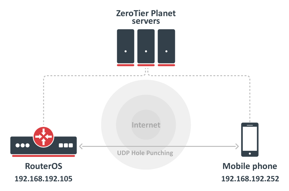

By default, ZeroTier is designed to be zero-configuration. A user can start a new ZeroTier node without having to write configuration files or provide the IP addresses of other nodes. It’s also designed to be fast. Any two devices in the world should be able to locate each other and communicate almost instantly so the following example will enable ZeroTier on a RouterOS device and connect one mobile phone using the ZeroTier application.

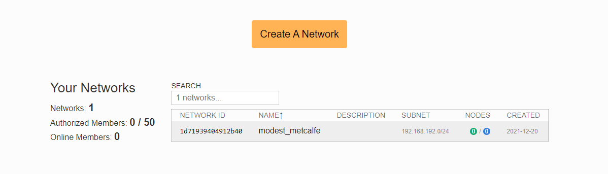

  1. Register on my.zerotier.com and Create A Network, obtain the Network ID, in this example: 1d71939404912b40.
  2. Download and Install ZeroTier NPK package in RouterOS, you can find it under the "Extra packages", upload the package to the device and reboot the unit.
  3. Enable the default (official) ZeroTier instance:
    [admin@mikrotik] > /zerotier/enable zt1
  4. Add a new network, specifying the network ID you created in the ZeroTier cloud console:
    [admin@mikrotik] /zerotier/interface/add network=1d71939404912b40 instance=zt1
  5. Verify ZeroTier configuration:
    [admin@MikroTik] > /zerotier/interface/print
    Flags: R - RUNNING
    Columns: NAME, MAC-ADDRESS, NETWORK, NETWORK-NAME, STATUS
    # NAME MAC-ADDRESS NETWORK NETWORK-NAME STATUS
    0 R zerotier1 42:AC:0D:0F:C6:F6 1d71939404912b40 modest_metcalfe OK
  6. Now you might need to allow connections from the ZeroTier interface to your router, and optionally, to your other LAN interfaces:
    /ip/firewall/filter/add action=accept chain=forward in-interface=zerotier1 place-before=0
    /ip/firewall/filter/add action=accept chain=input in-interface=zerotier1 place-before=0

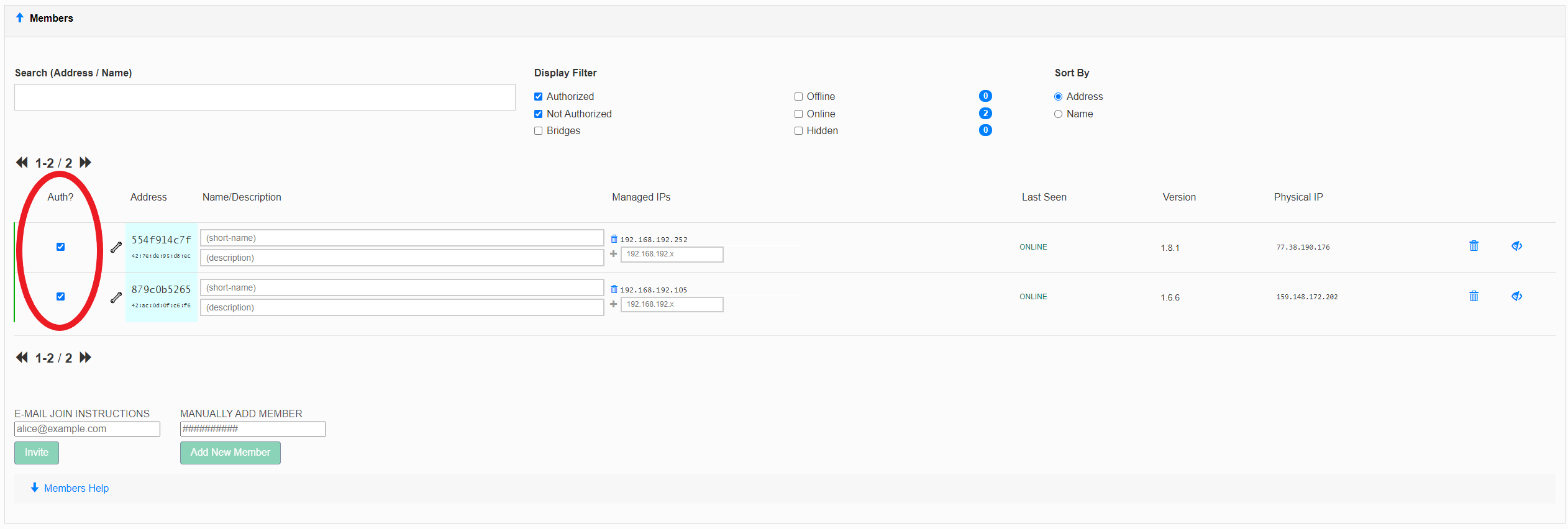

  7. Install a ZeroTier client on your smartphone or computer, follow the ZeroTier manual on how to connect to the same network from there.
  8. If **"**Access Control" is set to "Private", you must authorize nodes before they become members:
  9. [admin@MikroTik] > `/ip/address/print` where interface~"zero"
    Flags: D - DYNAMIC
    Columns: ADDRESS, NETWORK, INTERFACE
# ADDRESS NETWORK INTERFACE
3 D 192.168.192.105/24 192.168.192.0 zerotier1
[admin@MikroTik] > ping 192.168.192.252 count=3 SEQ HOST SIZE TTL TIME STATUS
0 192.168.192.252 56 64 407us
1 192.168.192.252 56 64 452us
2 192.168.192.252 56 64 451us
sent=3 received=3 packet-loss=0% min-rtt=407us avg-rtt=436us max-rtt=452us

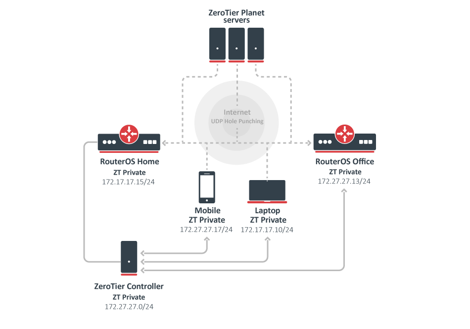

Configuration example
In the following example, we will use the RouterOS built-in ZeroTier controller to send our new network hosts appropriate certificates, credentials, and configuration information. The controller will operate from the "RouterOS Home" device and we will join 3 units to our network: mobile phone, laptop, RouterOS Office device, but theoretically, you can join up to 100 devices in one network.
RouterOS Home
First, we enable the default instance which operates at the VL1 level :

RouterOS Office
Configuration on the Office device. We will enable the default instance and ask a controller to join the 879c0b5265a99e4b network:

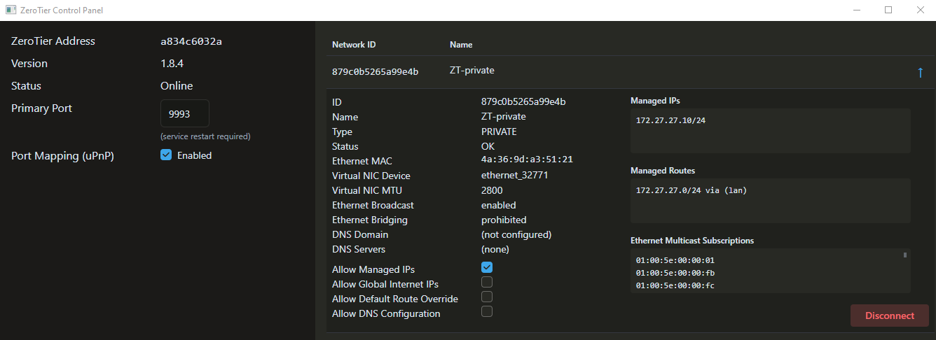

Download the ZeroTier app for your mobile phone or computer and join your newly created network:
  1. Via our Laptop ZeroTier application we join the 879c0b5265a99e4b network;
  2. User Zerotier mobile app to join the 879c0b5265a99e4bnetwork;
warning
Also all other new hosts you have to authorize under the /zerotier/controller/member/ section.
