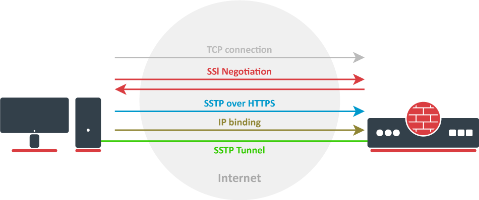

Let's take a look at the SSTP connection mechanism:
- A TCP connection is established from client to server (by default on port 443).
- SSL validates the server certificate. If a certificate is valid, a connection is established; otherwise, the connection is turned down. (But see note below).
- The client sends SSTP control packets within the HTTPS session which establishes the SSTP state machine on both sides.
- PPP negotiation over SSTP. The client authenticates to the server and binds IP addresses to the SSTP interface.
SSTP tunnel is now established and packet encapsulation can begin.

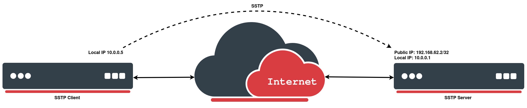

Quick Example
SSTP Client
In the following configuration example, we will create a simple SSTP client without using a certificate:
[admin@MikroTik > /interface/sstp-client/add connect-to=192.168.62.2 disabled=no name=sstp-out1 password=StrongPass profile=default-encryption user=MT-User
[admin@MikroTik > /interface/sstp-client/print
Flags: X - disabled; R - running
0 R name="sstp-out1" max-mtu=1500 max-mru=1500 mrru=disabled connect-to=192.168.62.2:443
http-proxy=0.0.0.0:443 certificate=none verify-server-certificate=no
verify-server-address-from-certificate=yes user="MT-User" password="StrongPass"
profile=default-encryption keepalive-timeout=60 add-default-route=no dial-on-demand=no
authentication=pap,chap,mschap1,mschap2 pfs=no tls-version=any
SSTP Server
We will configure PPP secret for a particular user, and afterwards simply enable an SSTP server:
[admin@MikroTik] > /ppp/secret/add local-address=10.0.0.1 name=MT-User password=StrongPass remote-address=10.0.0.5 service=sstp
[admin@MikroTik] > /interface/sstp-server/server/set default-profile=default-encryption enabled=yes

In P2P setups the network address will be the same as the other endpoint's local address.
