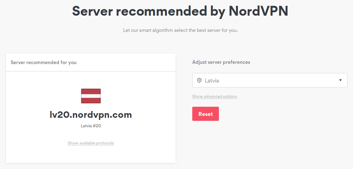

Finding out the server's hostname
Navigate to https://nordvpn.com/servers/tools/ and find out the recommended server's hostname. In this case, it is lv20.nordvpn.com.

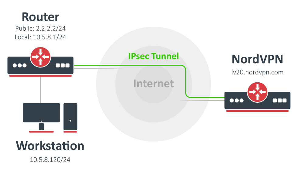

Choosing what to send over the tunnel
If we look at the generated dynamic policies, we see that only traffic with a specific (received by mode config) source address will be sent through the tunnel. But a router in most cases will need to route a specific device or network through the tunnel. In such a case, we can use source NAT to change the source address of packets to match the mode config address. Since the mode config address is dynamic, it is impossible to create a static source NAT rule. In RouterOS it is possible to generate dynamic source NAT rules for mode config clients.
Option 1: Sending all traffic over the tunnel
In this example, we have a local network 10.5.8.0/24 behind the router and we want all traffic from this network to be sent over the tunnel. First of all, we have to make a new IP/Firewall/Address list which consists of our local network.
/ip/firewall/address-list
add address=10.5.8.0/24 list=local
It is also possible to specify only single hosts from which all traffic will be sent over the tunnel. Example:
add address=10.5.8.120 list=local
add address=10.5.8.23 list=local
