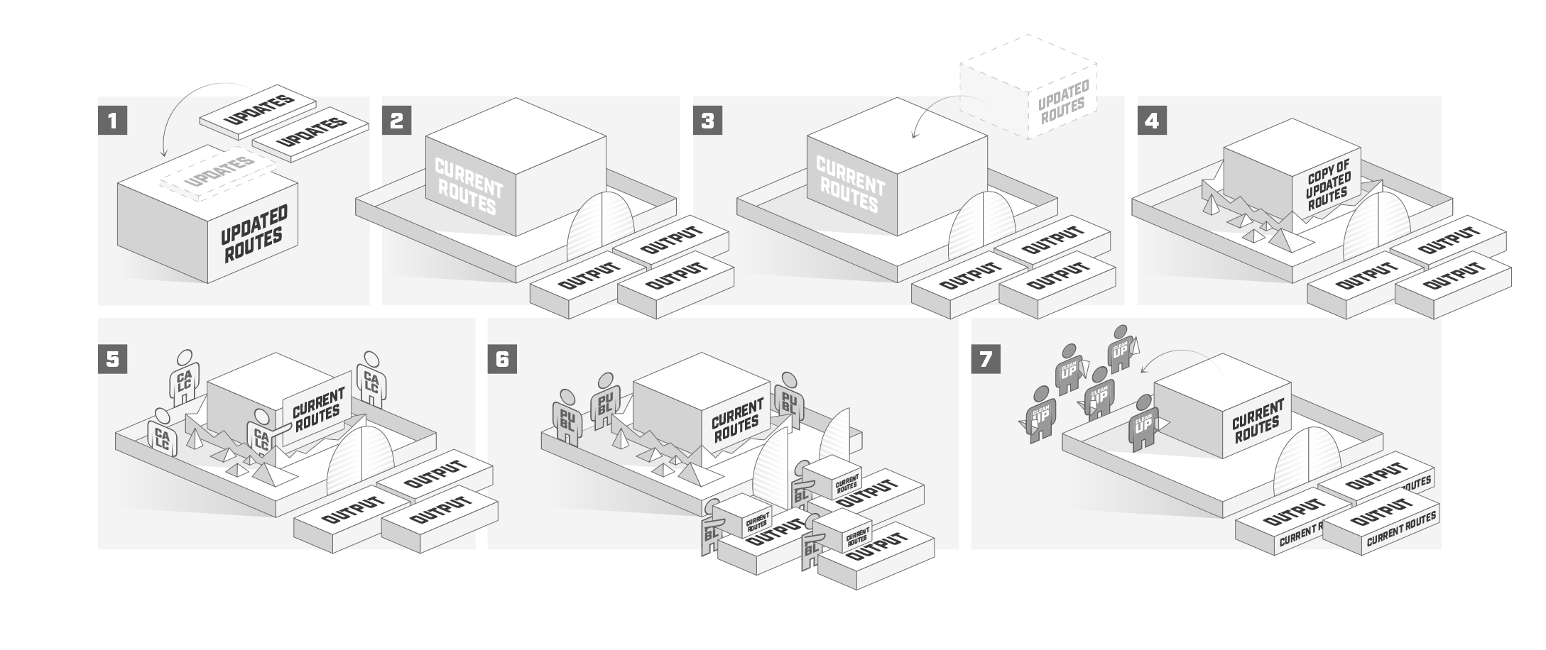

Routing Table Update Mechanism
The following illustration explains, in a more user‑friendly way, how the routing table update mechanism works.
Routing protocols continuously loop through the following procedures:
- The "main" process waits for updates from other sub‑tasks (1).
- "main" starts calculating new routes (2–4) if:
- an update from a sub‑task is received;
- the protocol has not published all routes;
- the configuration or link state has changed.
- During new route calculation (5), the following events occur:
- all received updates are applied to the route;
- gateway reachability is determined;
- recursive routes are resolved;
- The "publish" event runs, publishing "current" routes. During this phase, "current" routes do not change, but protocols can still receive and send updates (6).
- Perform cleanup and free unused memory (7). At this step, anything no longer used in the new "current" table is removed (routes, attributes, etc.).
Consider "updated" and "current" as two copies of the routing table. The "current" table (2) is used at the moment, while "updated" (1) is the table of candidate routes to be published in the next publish event (3 and 4). This method prevents protocols from filling memory with buffered updates while the "main" process performs "publish". Instead, protocols send the newest updates directly to the main process, which then copies the new updates into the "updated" table. OSPF is slightly more complicated: it internally has a similar process to select current OSPF routes, which are then sent to the "main" for further processing.
