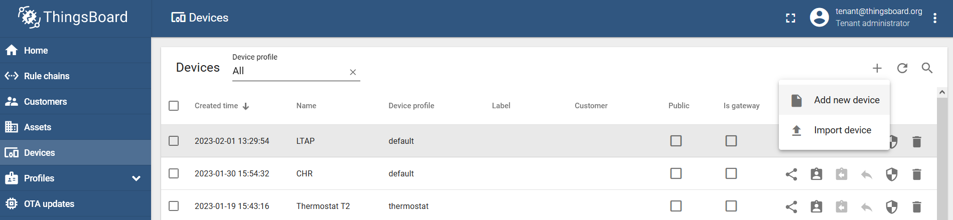

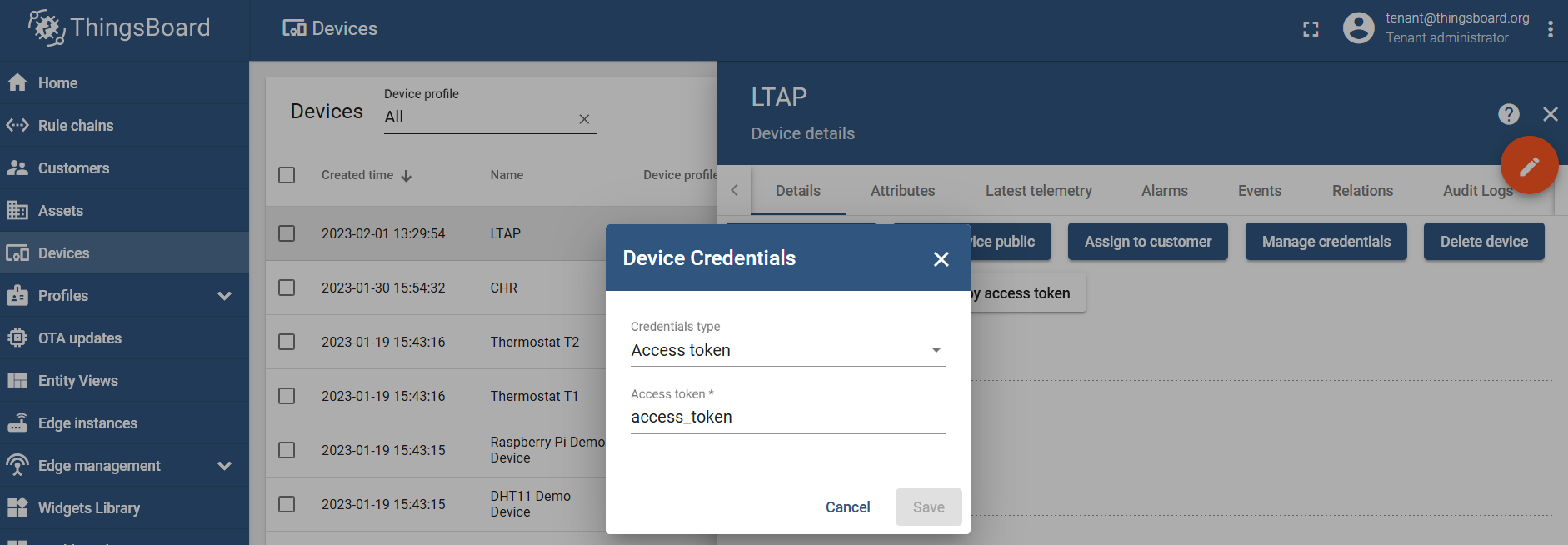

Navigate to the "Devices" menu and add a new device via the "Add new device" button → name it and create it (for example, LTAP):
Click on the device you've just added, go to the "Details" section, and generate an access token under the "Manage credentials/Device Credentials" setting:

/iot/mqtt/brokers/add name=tb address=x.x.x.x port=1883 username=access_token
Where:
  • name is the name that you wish to give to the broker and this name will be used later in the script.
  • address is the IP address of the broker.
  • port is the TCP port that the broker is listening on → for non-SSL it is typically TCP 1883.
  • username is dictated by the MQTT broker and, in our case, it is an "access token" that was generated in the ThingsBoard management portal.

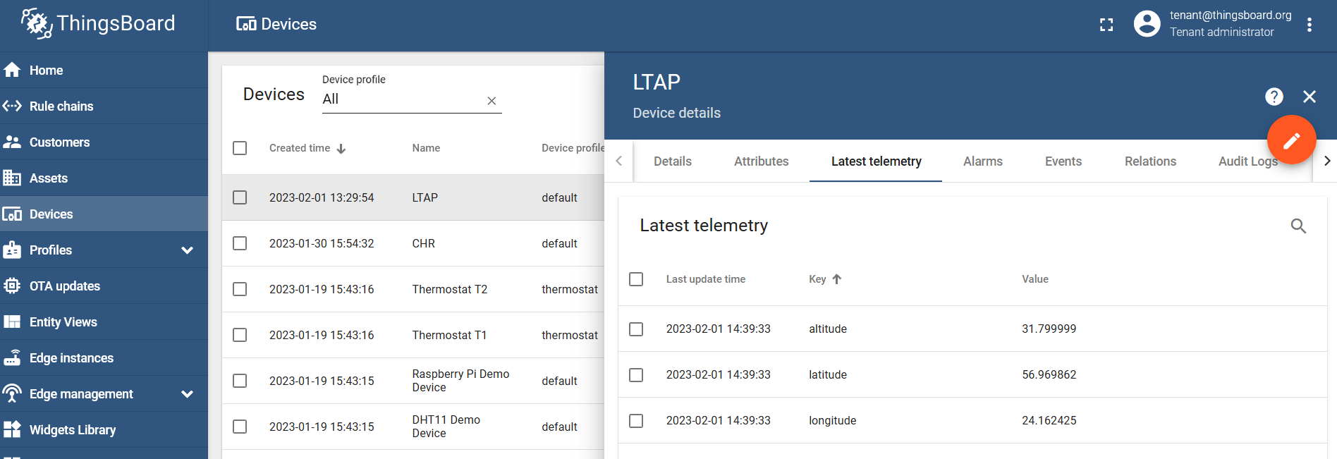

Result verification

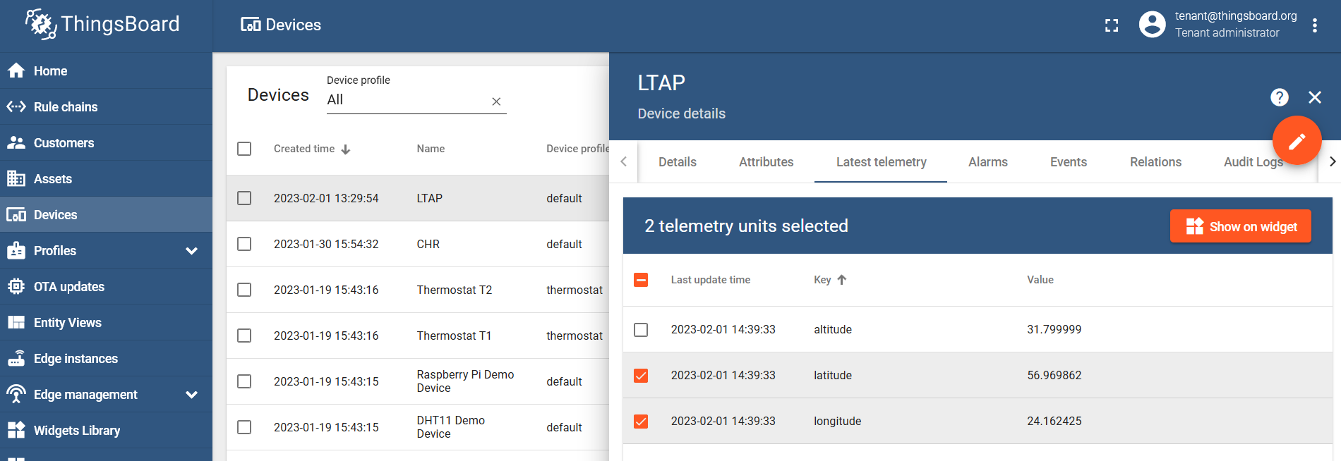

Go to the "Latest telemetry" section under your created device and confirm that the data was posted:
Data visualization using maps
ThingsBoard allows you to use Widgets to create visually appealing dashboards. In our case, we want to track our LTAP GPS coordinates, so we will need a map widget.
Select the latitude and longitude values and click on the "Show on widget" button:

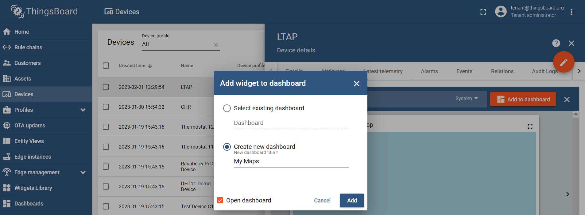

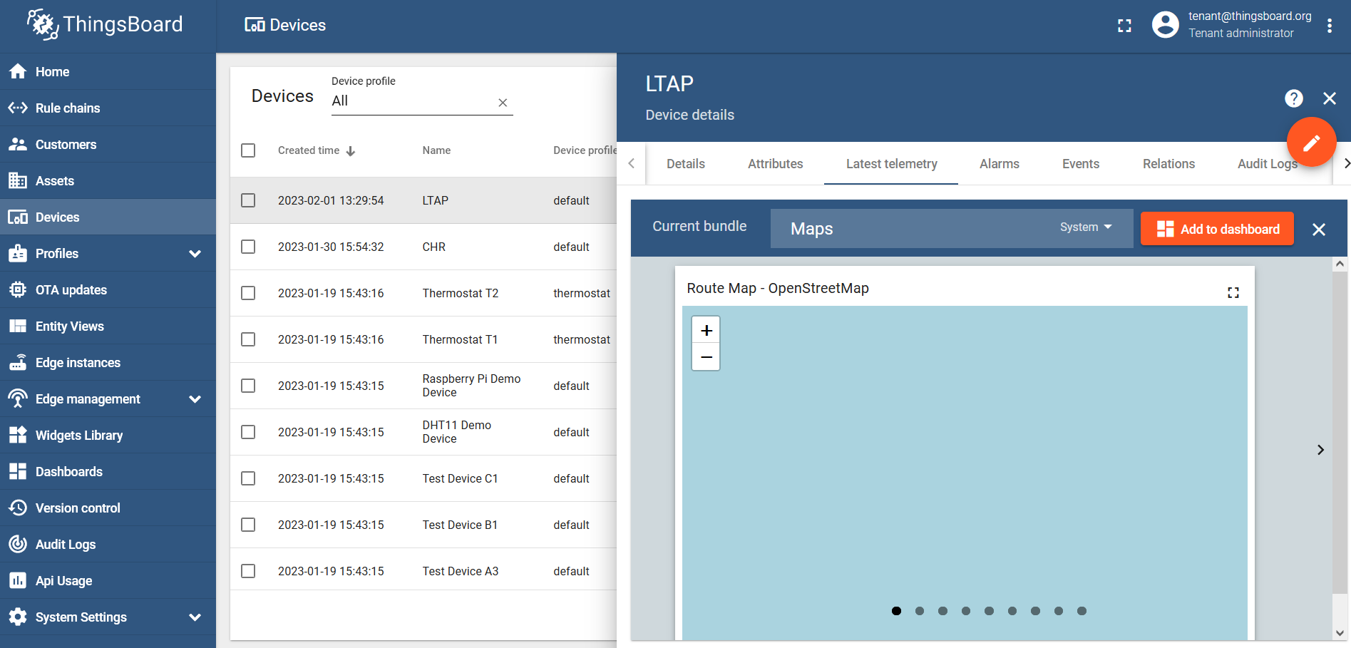

Find the "Maps" bundle and click on the "Add to dashboard":
Select an existing dashboard or create a new one and name it however you like:

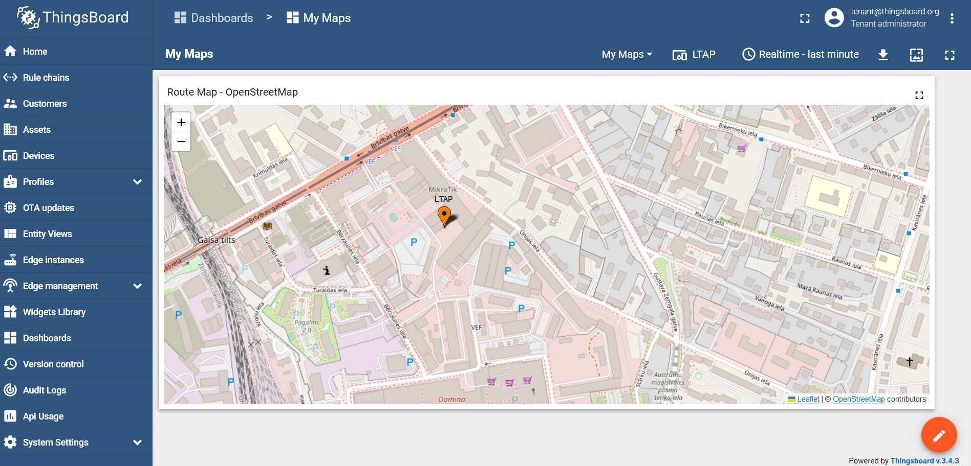

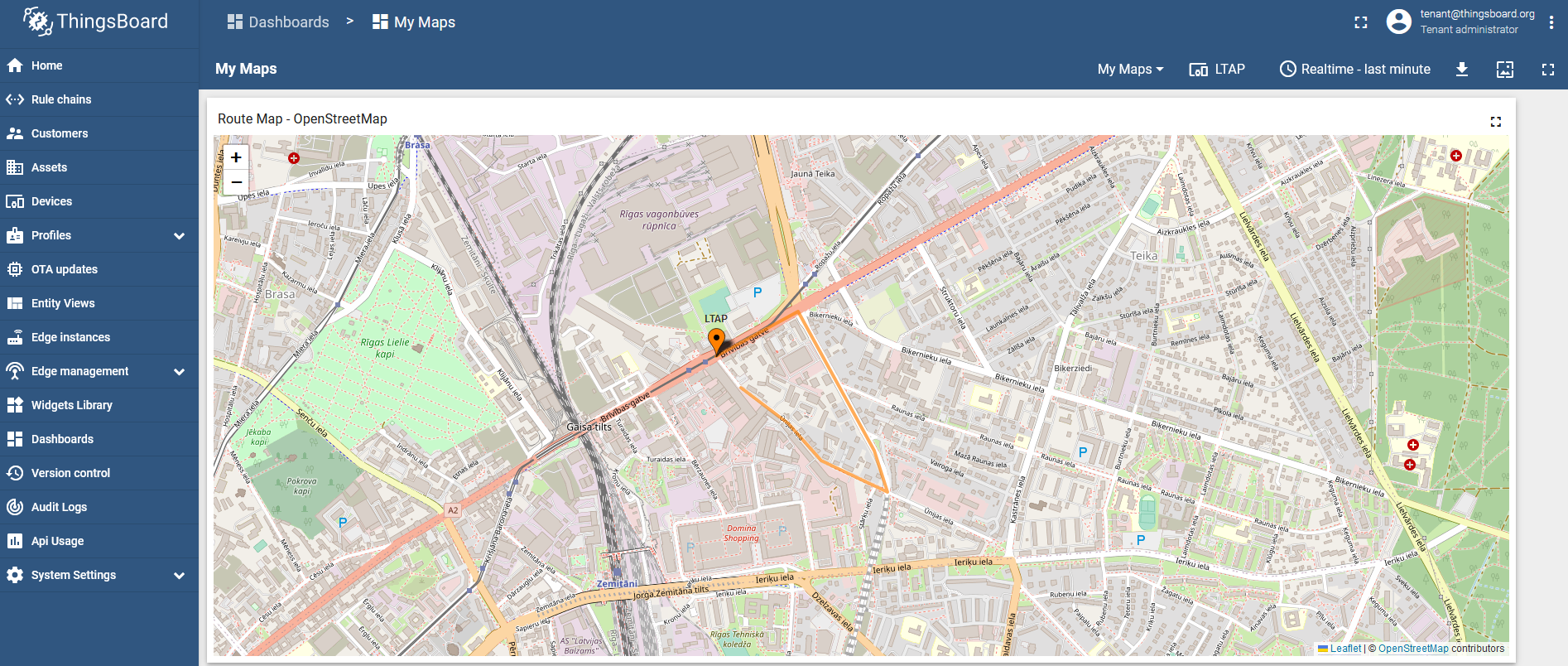

Run the script via the scheduler or manually and check the result:
Now, we can install it on a moving target and track its location:
