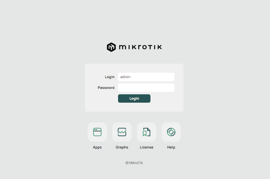

As we already know from the First Time Configuration section, the device by default has username admin and no password configured. Simply open a Web browser and in the search bar type the device IP address which by default is 192.168.88.1. Be sure your device has an IP address from the same network, for example, 192.168.88.2 otherwise Layer3 communication will not work.

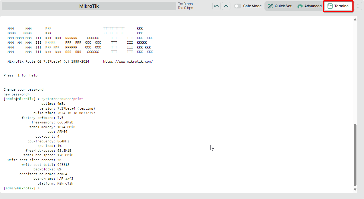

The "Terminal"
The "Terminal" or Command Line Interface (CLI) in WebFig is located in the top right corner. It offers the same functionality as the "New Terminal" in the WinBox GUI.

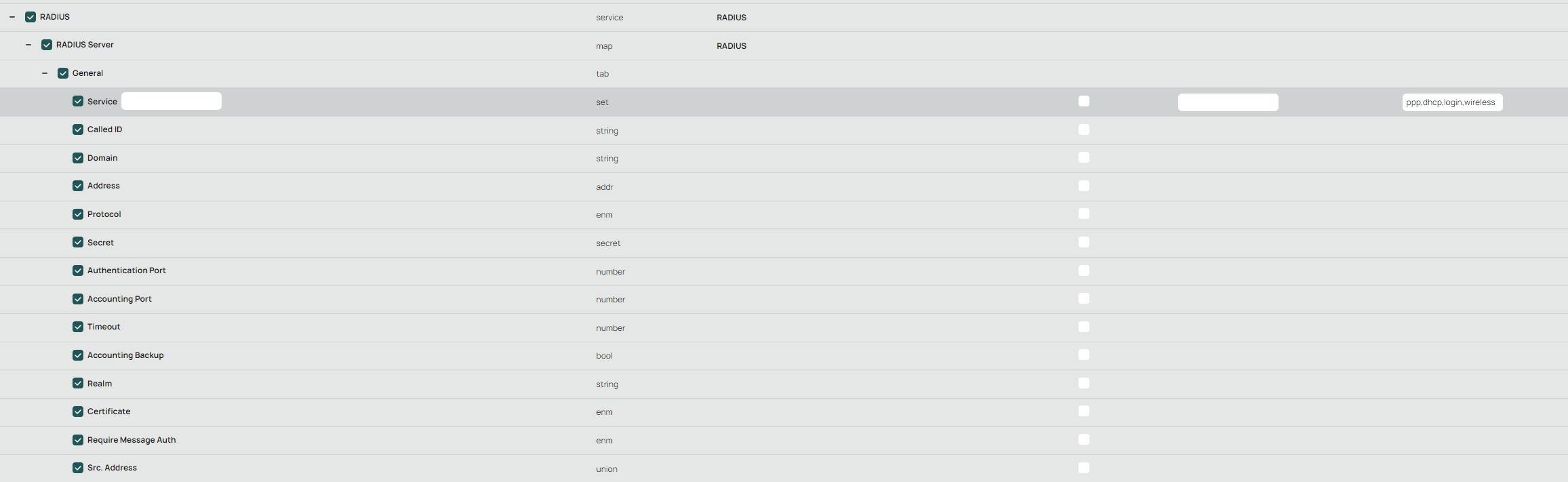

Designing skins
If the user has sufficient permissions (the group has the policies "policy" and "sensitive" to edit permissions), the Design Skin button becomes available. Pressing that toggle button will open interface editing options.
To prevent the user from accessing the Design Skin menu, disable policy "policy" and "sensitive" under the user group configuration.

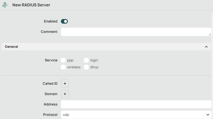

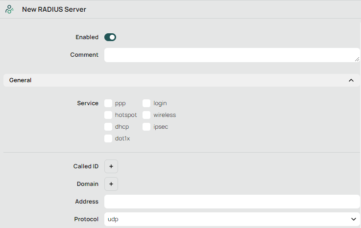

- Add limits for the field - (in detail view) where it is the list of times that are comma or newline separated list of allowed values:
- Number interval '..' example: 1..10 will allow values from 1 to 10 for fields with numbers, for example, MTU size.
- Field prefix (Text fields, MAC address, set fields, combo-boxes). If it is required to limit prefix length $ should be added to the end. For example, limiting the wireless interface to "station" only, "Add limit" will contain "station$".

If you need to limit the user to some services
Add a limit to the RADIUS Service.
The result will be only those services that are pointed in the "Limit" field.

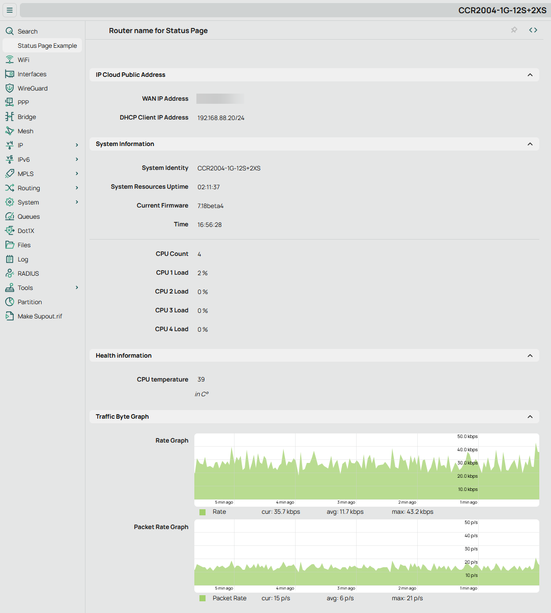

Here is an example of the "Status" page that can be used within the skin *.json file: status_main_example.json
The status content is structured as follows:
{"Status": {"Status": {}}}
Status records are displayed in numbered order, for example:
